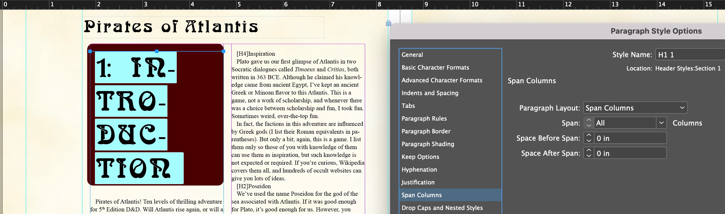

Hello, I installed InDesign CC 2019, but span columns doesn't work. Split columns works perfectly. When I have 2 or 3 columns text andtry to create a headline with span columns (across 2 or all columns) nothing happens. Does anybody can help? Or is there any existing script available which can span columns text? Please help, it is quite frustrating. I used 2 computers and it is not working. Thank you in advance.
Correct answer Barb Binder
Yes, it does. But it looks like "1. Introduction" appears to be in its own frame. It needs it be included in the text flow. For this feature to work you need to have one frame (primary or not), set to two columns. Not two frames sitting side-by-side.

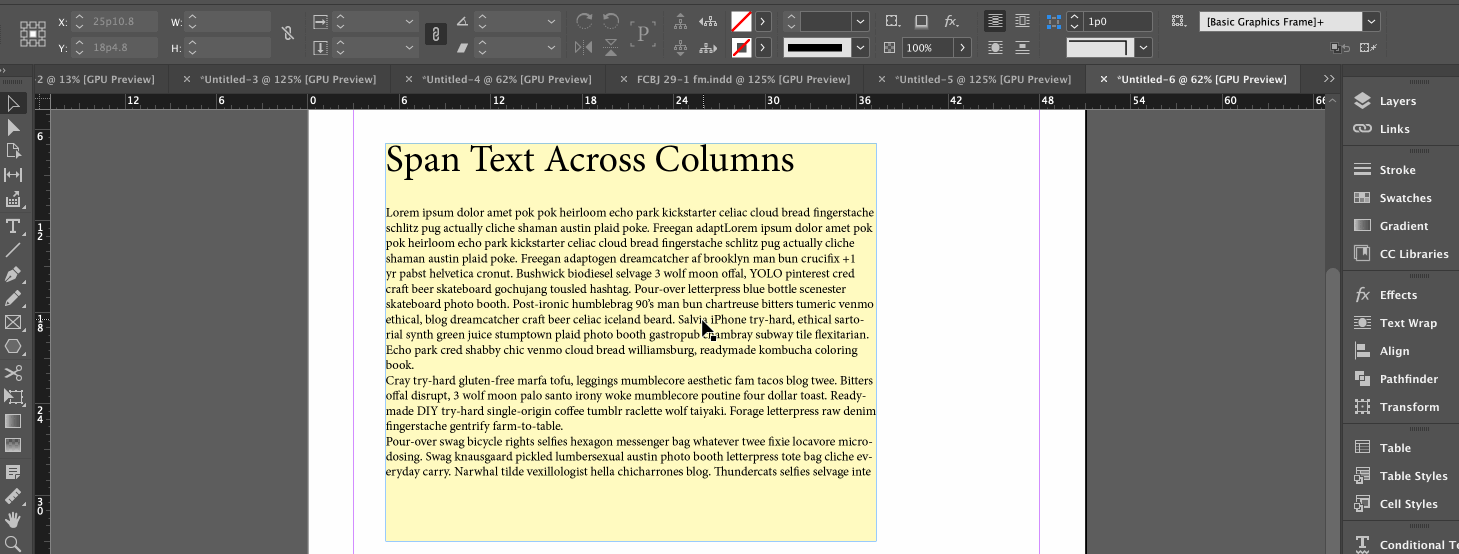

Hi Tom,
it is very strange. I've just made so in my 2019 on mac and it works.
Here is my screen.
regards M.

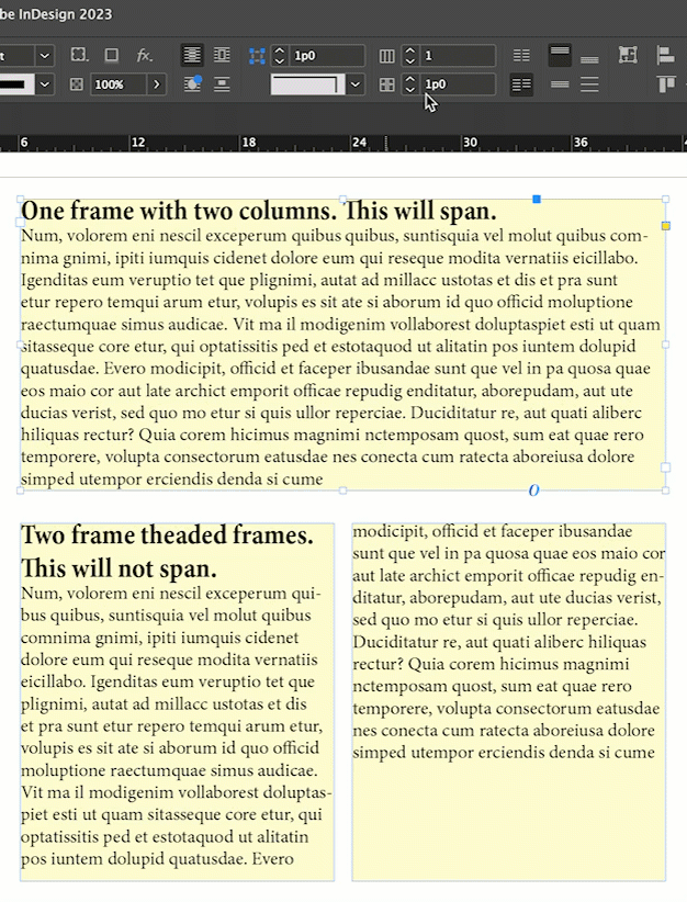

The key is using a multi-column frame. I made the text frame a light yellow so that you can see it, then defined a second column. Span doesn't work with two threaded frames sitting side-by-side.
~Barb
