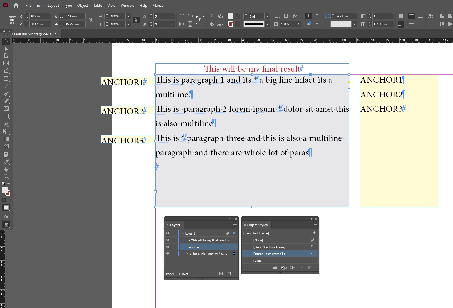

I am working on a long document where I have a threaded textframe.
I have shown an example using gray textframe in the screenshot.
I have another text frame denoted by yellow textframe in the screenshot
where I have some text which will be anchored in the gray textframe.
I have named it as "source" in layers.
I have written a script through which I am splitting each line in
yellow textframe to a textframe of their own. Meaning 3 textframes will be created out of yellow textframe.
var doc = app.documents[0];
//var myFrame = doc.textFrames[0];
var myParas = doc.stories.everyItem().paragraphs.everyItem().getElements();
var noParas = myParas.length;
alert(noParas);
for(i=0;i<noParas;i++){
var textFrame = doc.textFrames.add();
	textFrame.properties =
			geometricBounds :[0,0,50,50],
			strokewidth: 0,
			fillColor : "None",
			contents : myParas[i].contents
The issues which I am facing:
1.The script is creating textframes for gray text box also. I want textframes for contents in yellow textframes only.
2.The textframes which will be created should have object style of its own. Obj Style name will be rukus".
3.The created textframes should be anchored just after or before the "*" mark in the gray textframe.
First part is somewhat working through the script which I have written but I am not able to do other parts as I am still learning scripting.
Any suggestion would be helpful.
Thanks

1) you are collecting paragraphs from all stories - including the grey TF - you need to change your approach and work on two Stories - source (yellow) and destination (gray) ,
2) you need to apply ObjectStyle,
3) back to 1) - you need to go through a destination story - look for "*" and then insert Paragraphs from the source story.
I'm not JS guy so can't give you code.

@Robert at ID-Tasker Thanks for the reply.
I have modified the code. Took help from internet. Here is how the code looks now.
It creates only 3 textframes as per the source textframe and applies "rukus" object style to it. I am not able to carry out the 3rd part.

Hi @Bedazzled532
As @Robert at ID-Tasker said you have to work with the two frames. I have named the gray text frame as 'destination' but you can refer it as you want (txtFrame.name != 'source').
Try this:
//get handle to document
//get handle to textFrames
var txtFrame = doc.textFrames;
//get handle to paragraphs
var des = txtFrame.itemByName('destination');
var desPar= des.paragraphs;
for (var i = desPar.length - 1; i >= 0; i--) {
  //search for position
  var pos = desPar[i].contents.indexOf('*') + 1;
  //insertion point
  var point = desPar[i].insertionPoints.item(pos);
  // add frame at insertion point
  tf = point.textFrames.add();
  tf.properties =
    geometricBounds :[0,0,10,30],
    strokewidth: 0,
    fillColor : "None",
    contents : txtFrame.itemByName('source').paragraphs[i].contents,
    appliedObjectStyle: doc.objectStyles.item("rukus"),
  tf.anchoredObjectSettings.properties = {
    anchoredPosition: AnchorPosition.ANCHORED,
    anchorPoint : AnchorPoint.TOP_RIGHT_ANCHOR,
    verticalReferencePoint : VerticallyRelativeTo.LINE_XHEIGHT
I assume that number or paragraphs in both text frames are the same, if not you will need additional scripting to check and avoid errors.
