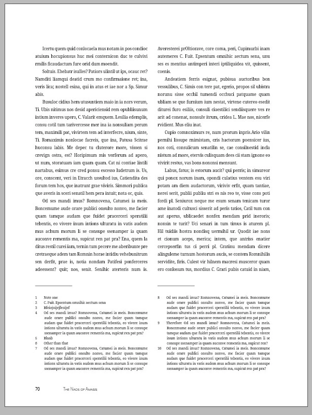

We work on academic books, and academics love footnotes. When working with a two-column layout, the footnotes of each column appear at the bottom of that column. So far so good. But when there are a lot of footnotes things get messy, one column can be 50% filled with footnotes and the column next to it can have only 1-2 lines of footnotes (or even none). This doesn't look particularly nice.
We are wondering if there is a way to even them out?
I know it is possible to set the footnotes in one-column, but that doesn't look good. Would it however be possible to sever the link between the footnotes and the columns in such a way that the footnotes of one text frame are evened out over two columns. This would mean that if in the first column there are 15 footnotes and in the second column there are 5, they are middled in such a way that on the bottom of each column you have 10 footnotes. This would mean that not all footnotes would appear below the column in which they are invoked (since they can also be send to the other column of the same textframe) but they do appear on the same page. This will bother no-one and it will look a lot better.
Example:
This for example doesn't look nice, especially if there is even a larger difference between the lengths of the footnotes in each column.

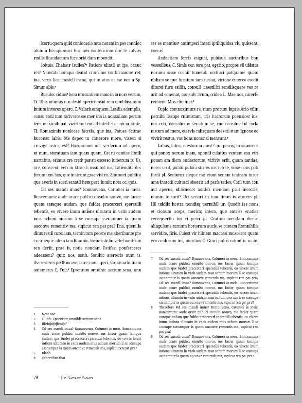

When we would even them out over the two columns it would look like this:
But I can't find a way of doing this automatically, and even by hand it is an almost impossible job, especially when working with >500 page books.

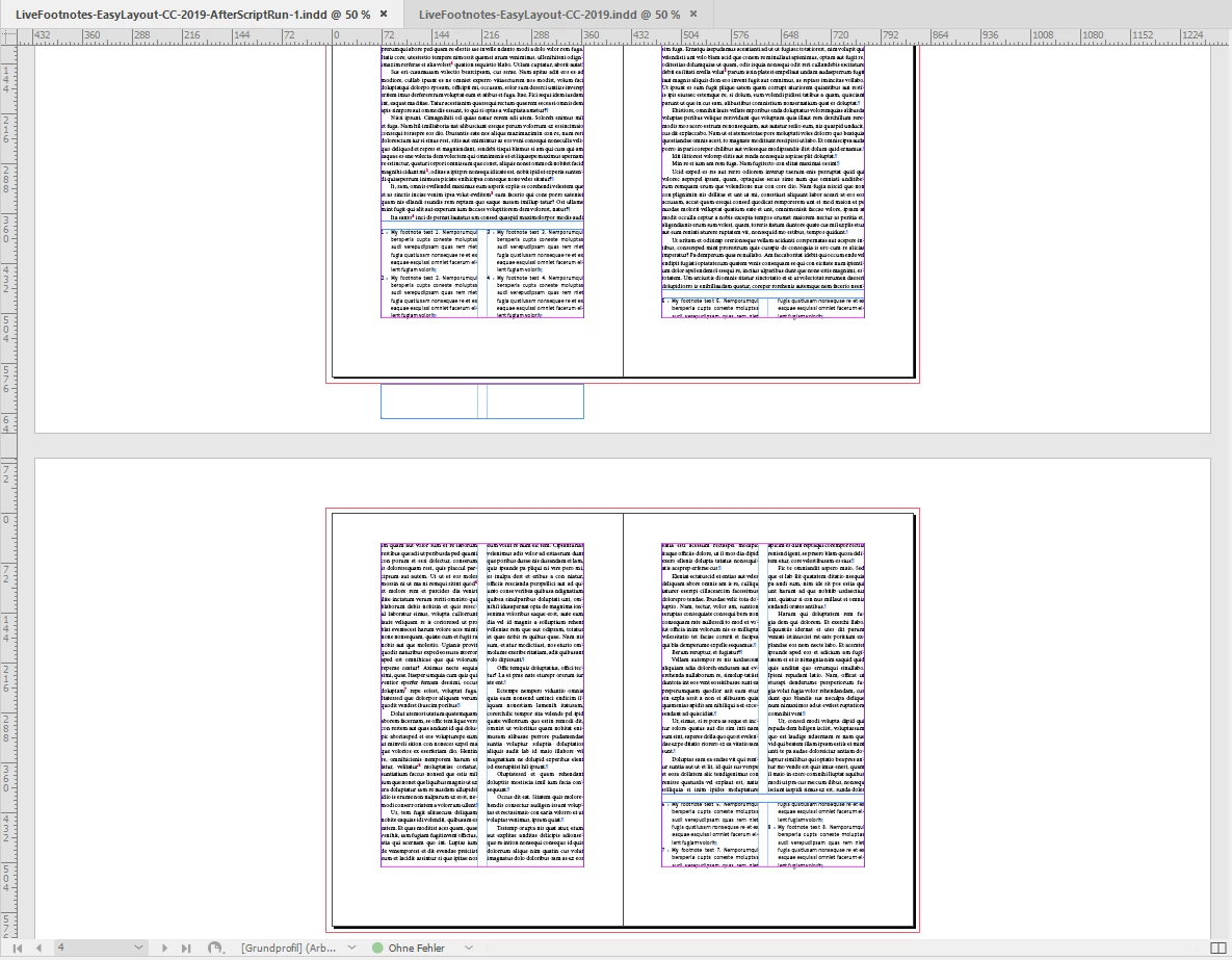

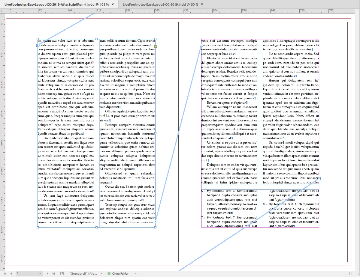

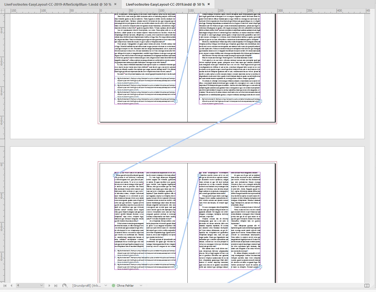

Just tested Ariel's script a bit. Just a few minutes. I was not able to control the flow like I wanted. Maybe because I had different numbers of columns set to my text frames in the story? I began with one-column text frames with the first two pages and proceded with two-column text frames on the next pages.
Before running the script:
After running the script and adapting the two columns to my text frames again:
As you can see balancing of footnotes like you want is possible. However I don't know why the frame with footnotes 6 to 8 is not on the page where the footnote references in the main text are.
Tried again with the script to compose that after assigning two columns to my text frames by unchecking "Footnotes may appear on next page", but was greeted with an error message:
