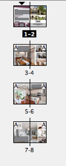

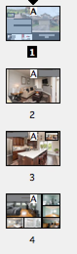

The scenario:  I've taken on some work from a past designer who has set up his design in long pages rather than facing pages to make up the spreads.  I'd like to know if there is a way to split the large pages in half and correct this setup issue within the existing document without altering the content rather than just remaking it. There are too many files I've been handed like this to make going back and re creating them one at a time efficient.
For visual reference...
the document is supposed to look like this:
but instead it's been set up like this:
