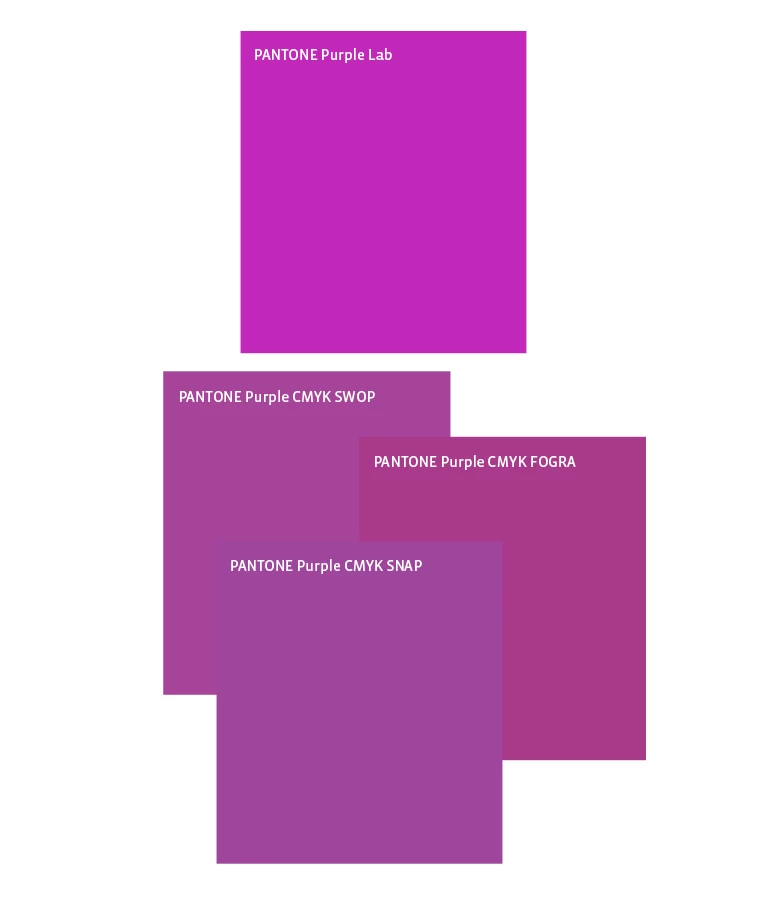

    The obvious problem is with some colors that are out of the CMYK gamut and can't be displayed or printed with a CMYK mix. Pantone Purple is a good example. If you take the legacy mix for Pantone Purple—38|88|0|0—and assign it different CMYK profiles, you'll get different previews for the same mix, which simulates what would happen to the same values under different press conditions.
    If you were printing Purple as a spot color, the CMYK press conditions would have no effect on the color—with Lab definitons the CMYK profile also has no effect on the spot color's display.
    Here's Pantone Purple as Lab at the top, which is displaying the more accurate out-of-gamut color. Below is 38|88|0|0 with three different profile assignments, which one is right?:
