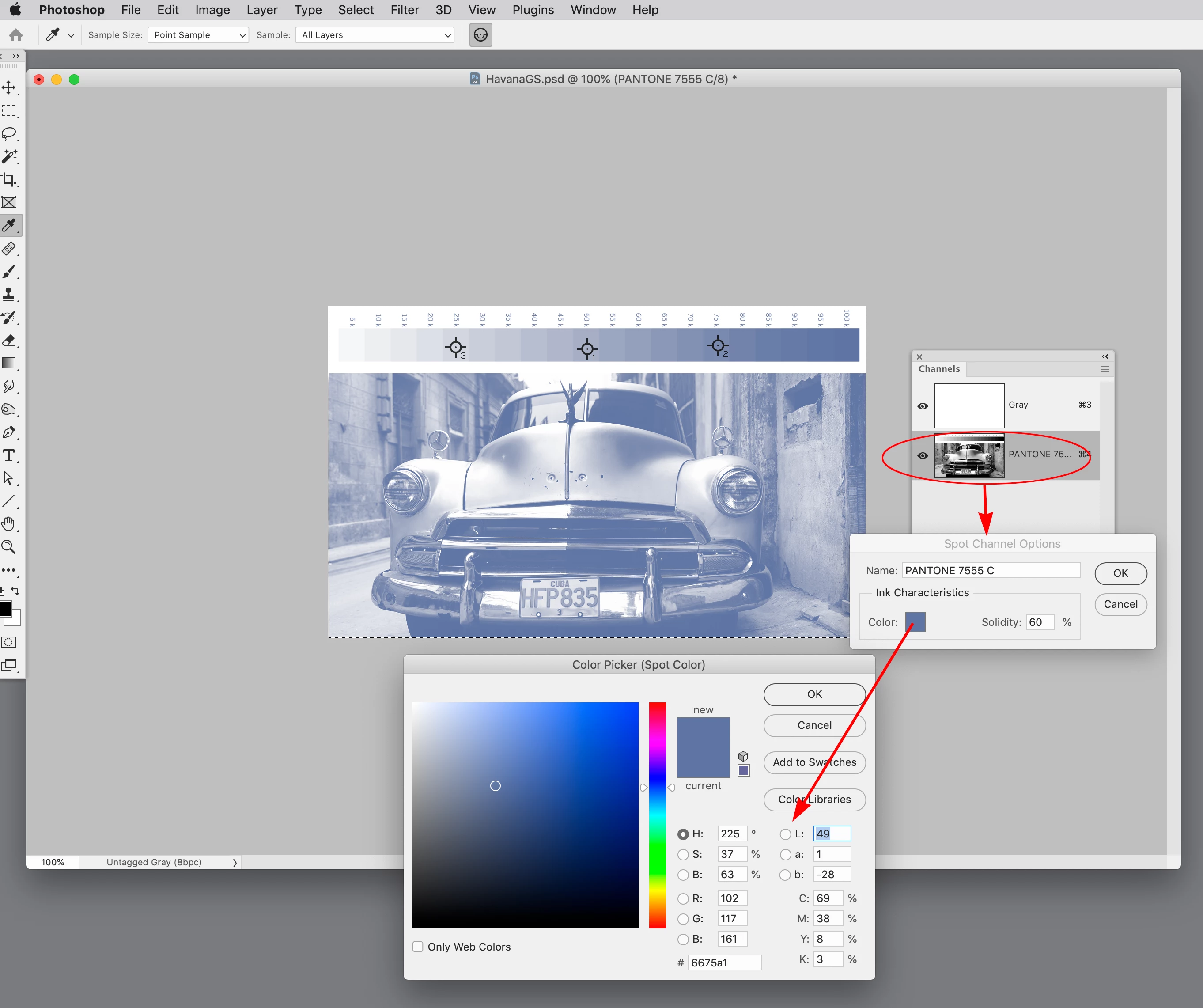

Hi @DebbieBerne , How is your Photoshop Spot color setup? Is it a Monotone or a Spot Channel? Are you saving the file as a .PSD?
Can you show screen captures of your setup as I’m showing below or share the file?
Monotone:
Spot Channel:
April 26, 2023
yes, my setup basically looks like yours. See screenshot attached. Any thoughts?
April 26, 2023
p.s. HOWEVER if I add the PMS as a spot channel, when I bring it into ID, I get a blank box. If I don't add it as a spot channel (just keep the monotone channel), it appears as it should.

April 26, 2023
that worked! totally annoying, but workable! thanks so much.
