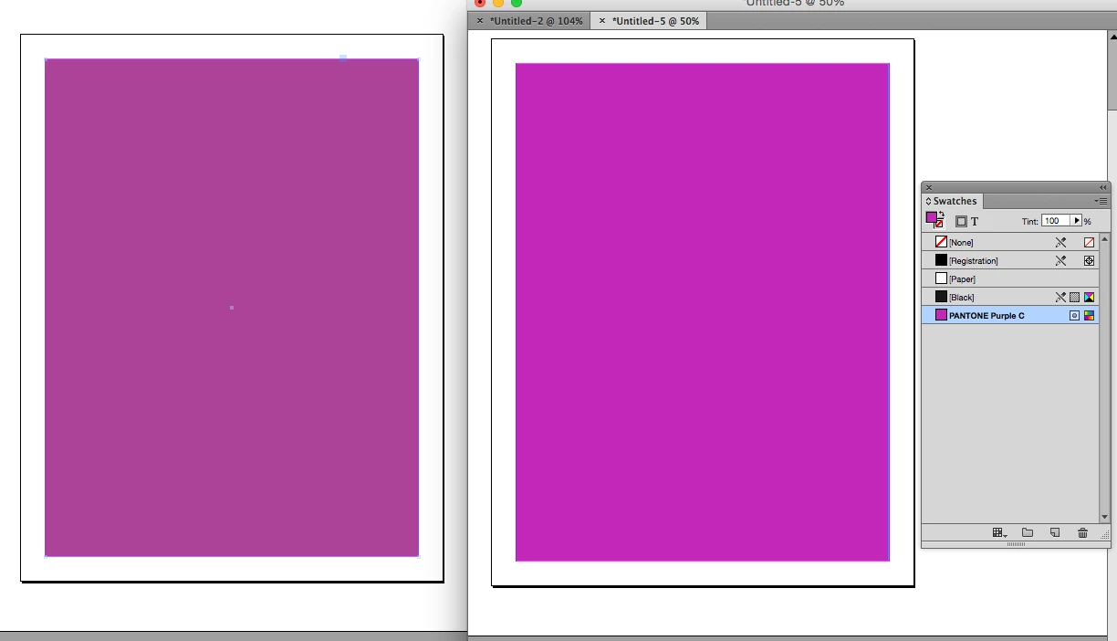

For example Pantone Purple which is not in the CMYK gamut. Pantone's Lab specification on the right, a pasted CMYK version converted to Lab on the left

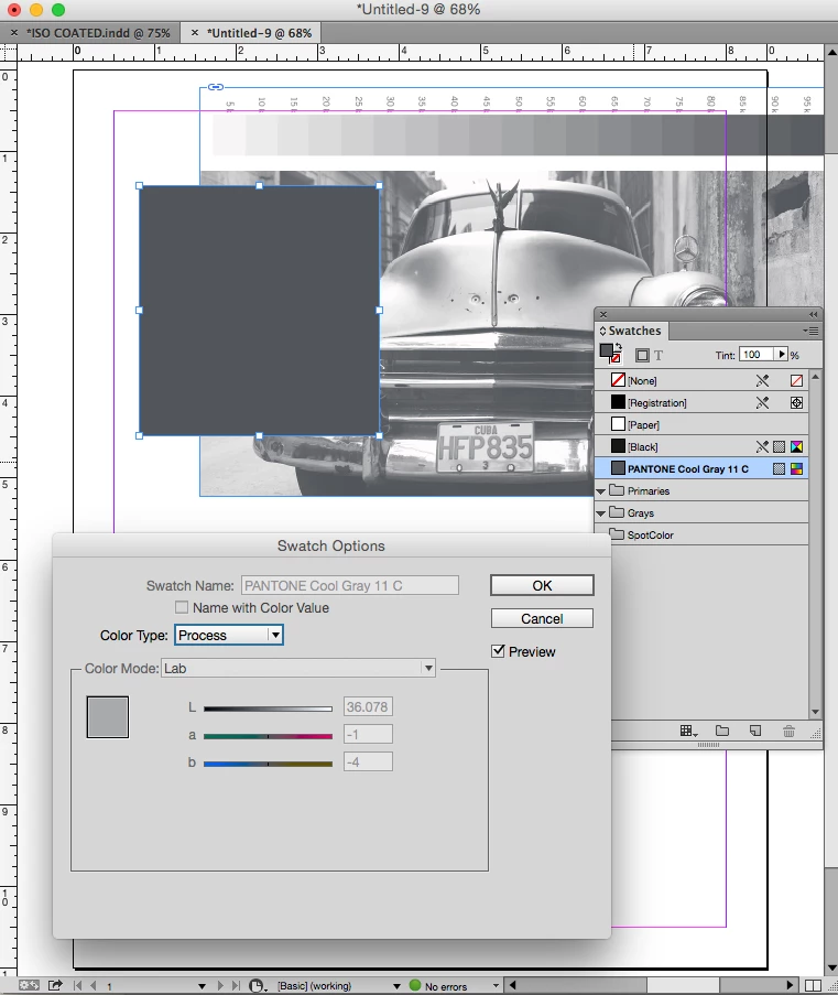

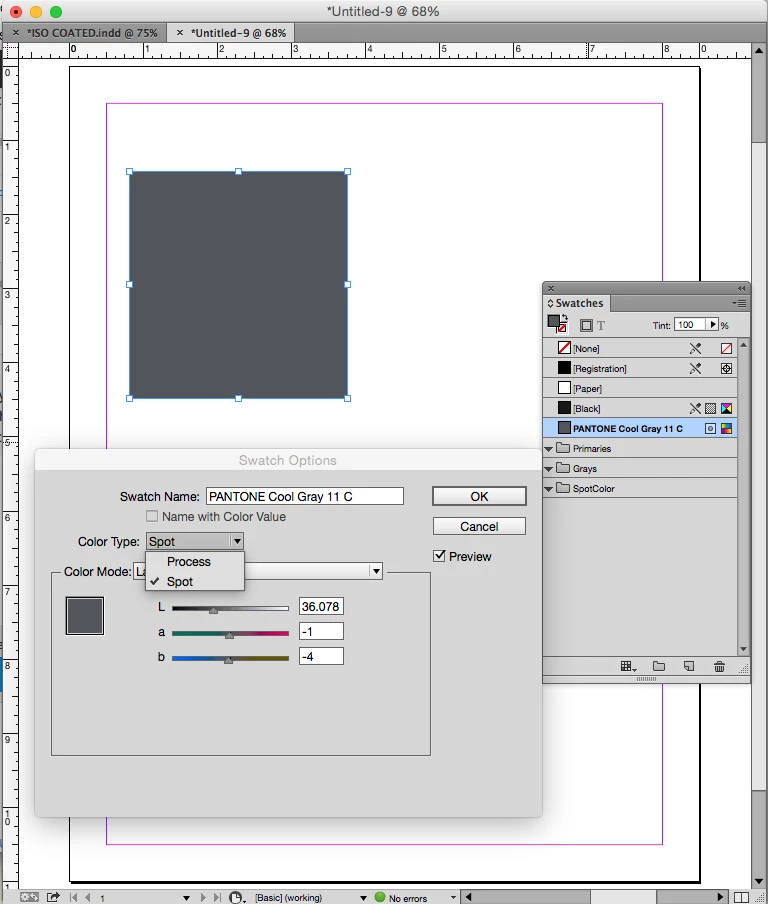

I'm not seeing that. Spot color swatches either imported or created in InDesign can be converted to process:

With the Pantone+ Solid Lab values it is possible to make a color managed conversion from the more accurate Lab color to the CMYK destination profile, either by setting the Color Type to process or using Ink Manager.
Ink Manager does not correctly convert Lab spot tints so I prefer setting the type to process if there are tints:

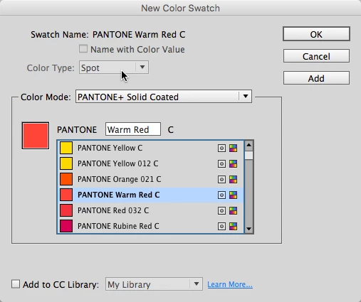

I think the difference comes when you switch the color readings from "book color" in the swatch settings.
Mine reported the same when I selected the "book swatches" set, but when I clicked the color I wanted from the swatch set I got the following:
I couldn't switch the Color Type: options box from Spot until I transited to another color space. If I changed the Color Mode: options box to Lab, it reported Lab values; if I changed it to CMYK, I got a four-color process build. I got the same results when I imported my business' spot color logo into the sample file. I had to first transit the colorspace in the Color Mode: options box before I could turn it into a process color build.
The only way I could get the option to choose a process color build from scratch was if I created it from scratch, which may be indicated in your screen capture as the Swatch Name: edit box was activated. But that was the only way I could turn a spot color into any process color model without first changing the Color Mode: options box to one of the process color models at the top.
