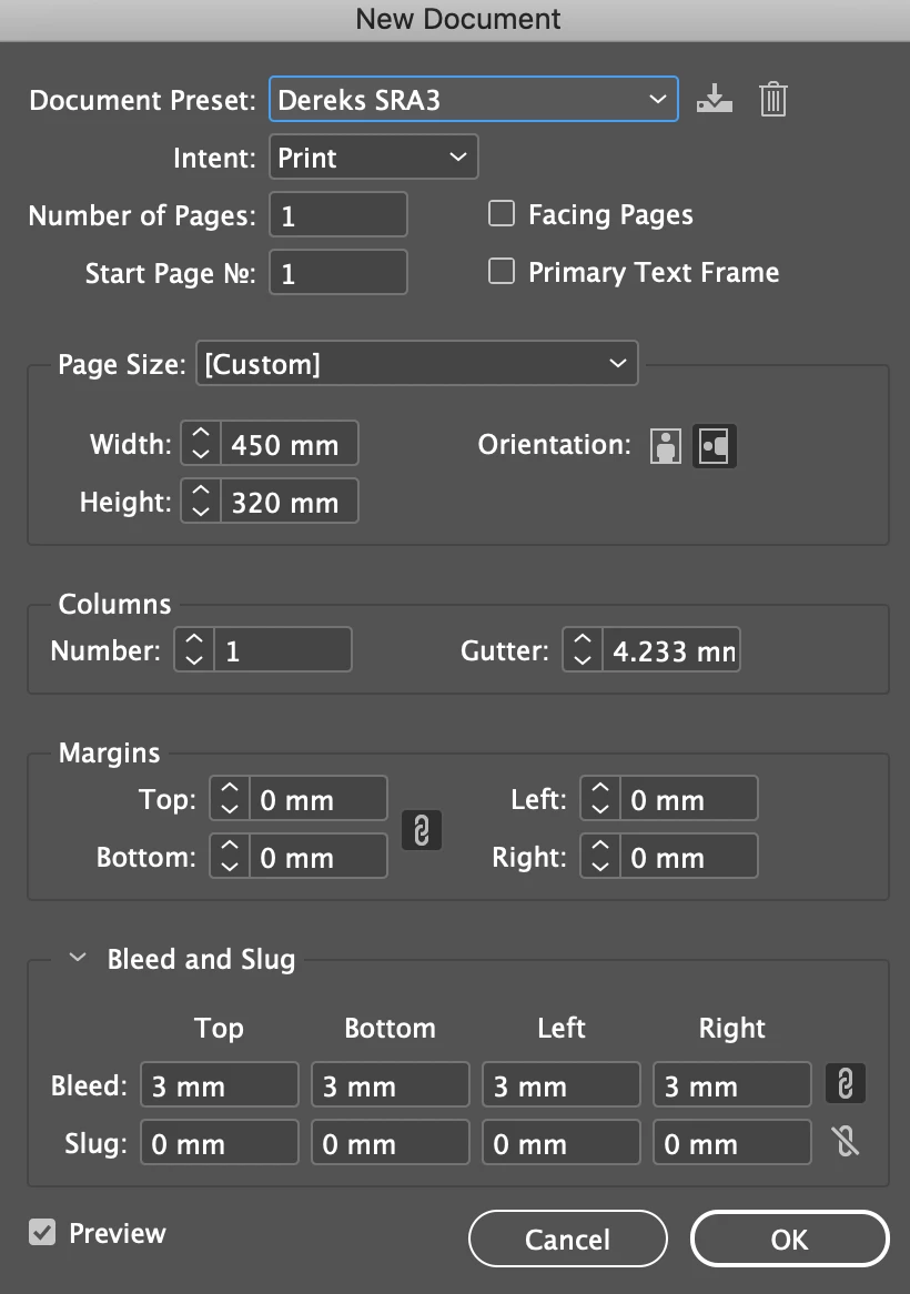

May 22, 2019
Here's an example of what the preset looks like:
