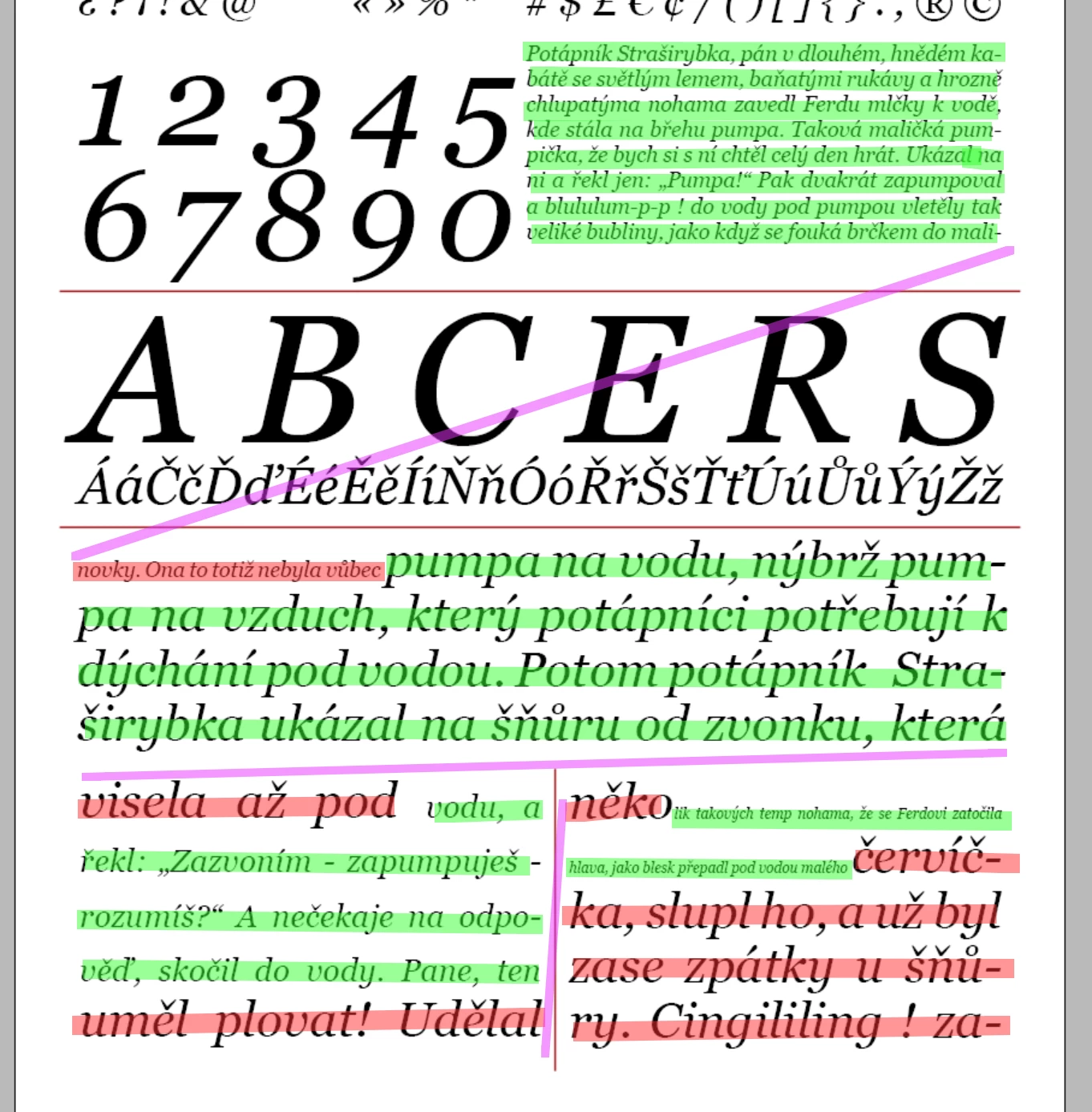

Thank you very much, simple as I wanted.
I just didn't realize that after cancellation, there would be no text left.
I created 4 linked textFrames.
After filling the text, I assigned a different text size to each textFrames.
Unfortunately, part of the different text size, was transferred to another textFrames.
So after filling the textFrames, I wanted to cut it off and then change the font.
Green=OK - red=overflow format from another textFrames.
Thanks again, for the previous reply, I will keep looking. I originally pasted the text into individual textFrames. But I thought of making the text contiguous. So a technical challenge that I can't track down.
