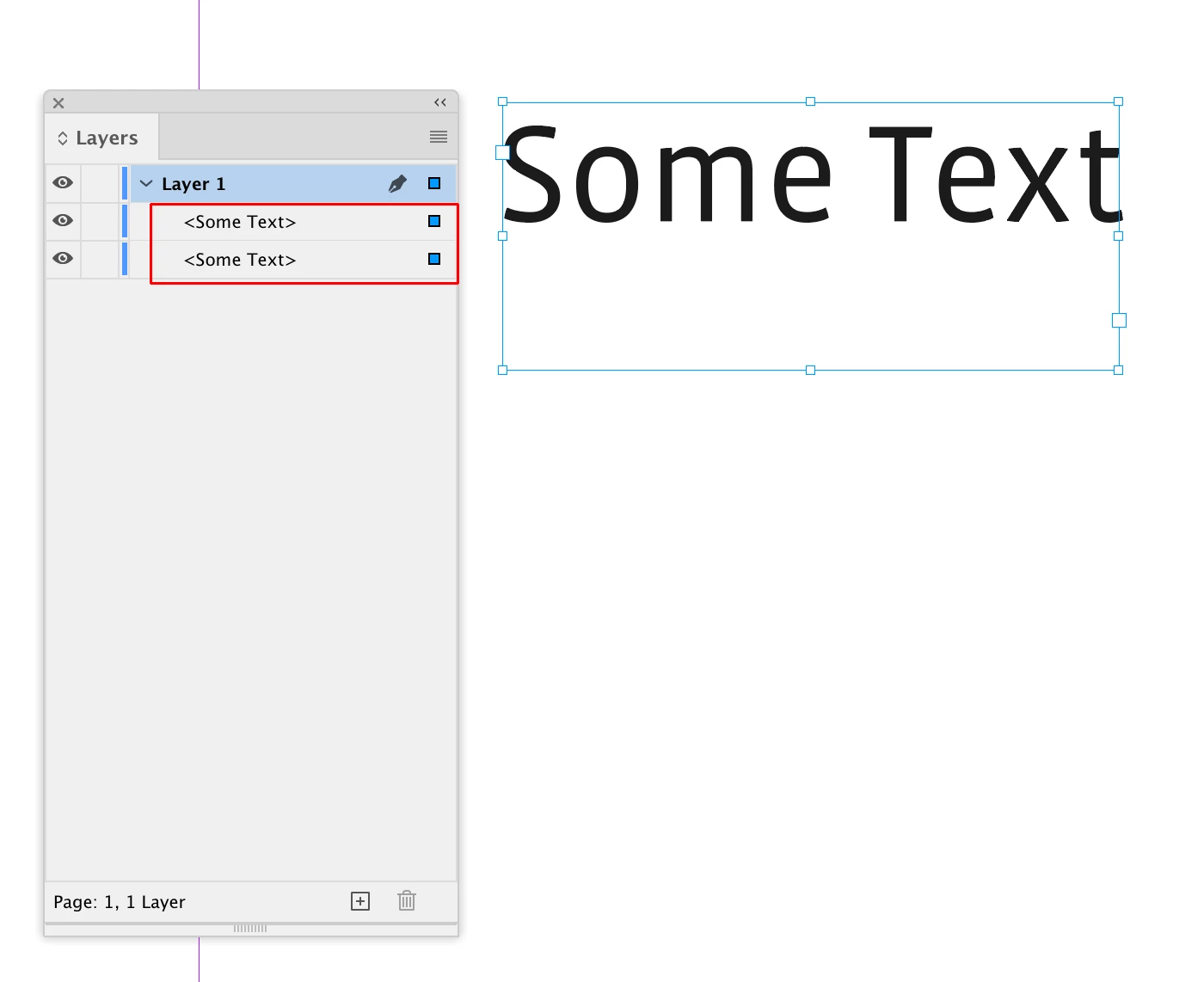

Insert some black text at 100% black
Copy and Paste in place so it overlaps exactly (or even a bit)
Doesn't show as 200% black - even though it's overprinting and not knockout

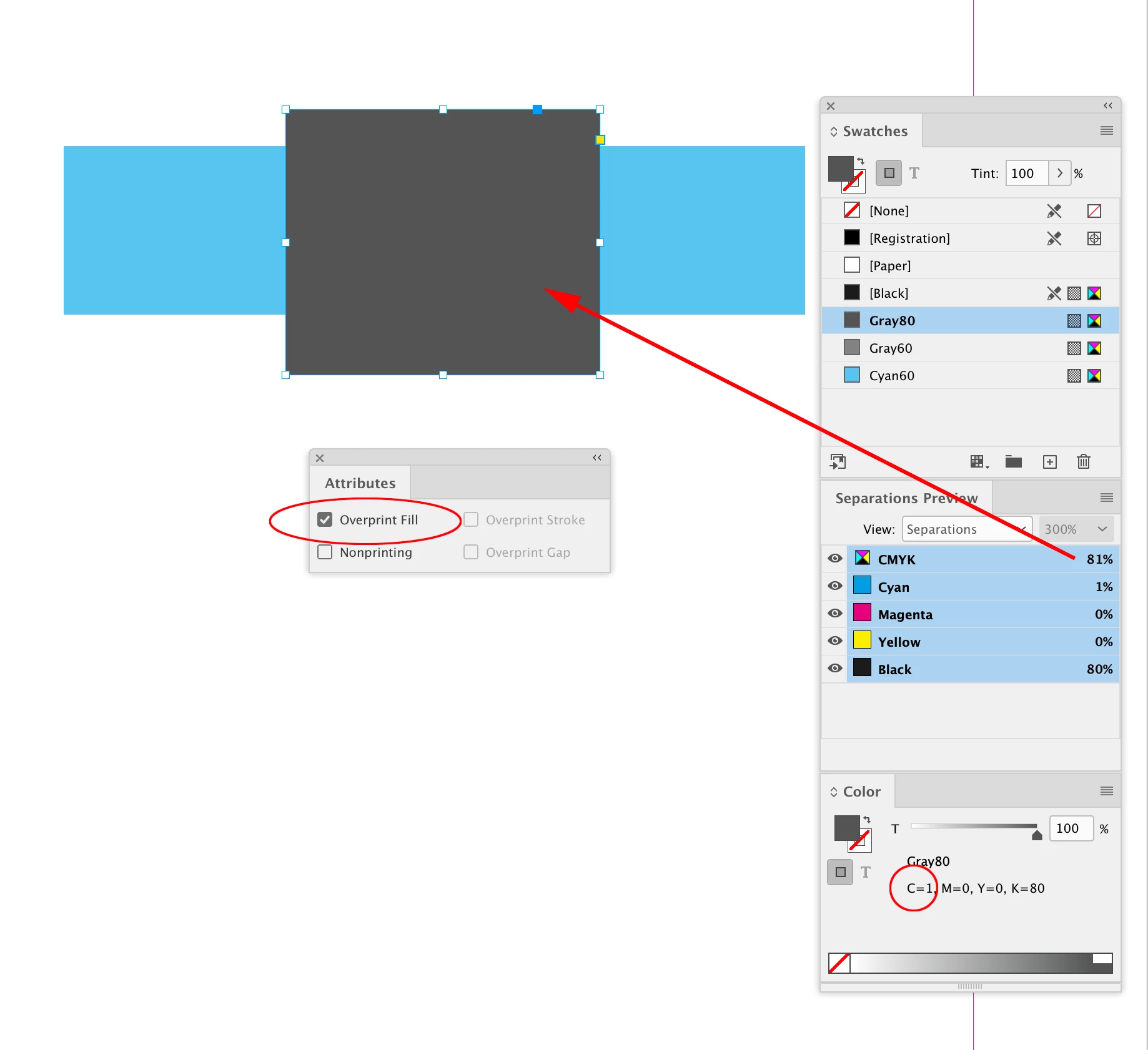

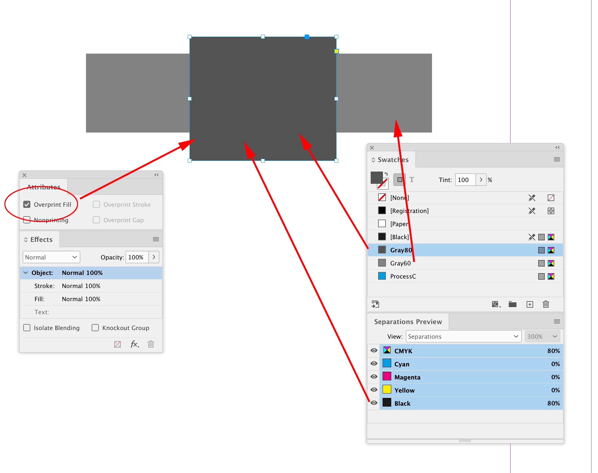

Hi Eugene, Not sure, but you might be expecting Overprint to act like a Multiply effect, but when a Process ink overprints itself nothing happens. For example here I have 2 overlapping frames with the top frame filled with 80% Black set to Overprint, and the bottom frame filled with 60% Black—Separation Preview shows the overlapping output value as 0|0|0|80, which is expected:

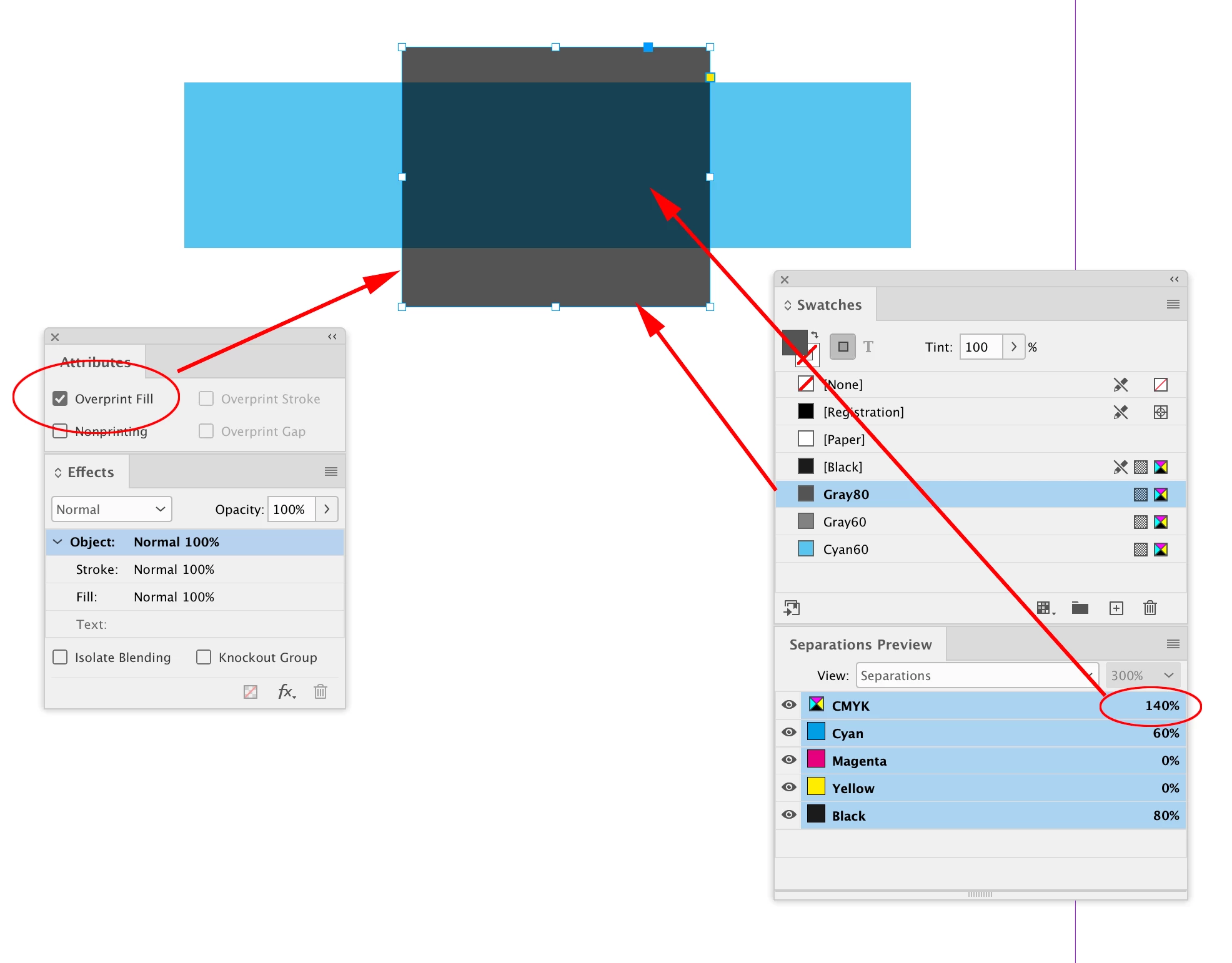

If I set the bottom frame to a different process ink, the Overprint applied to the 80% Black fill does have an effect—the Total Ink is now 140% with the overlapping area outputting as 60|0|0|80

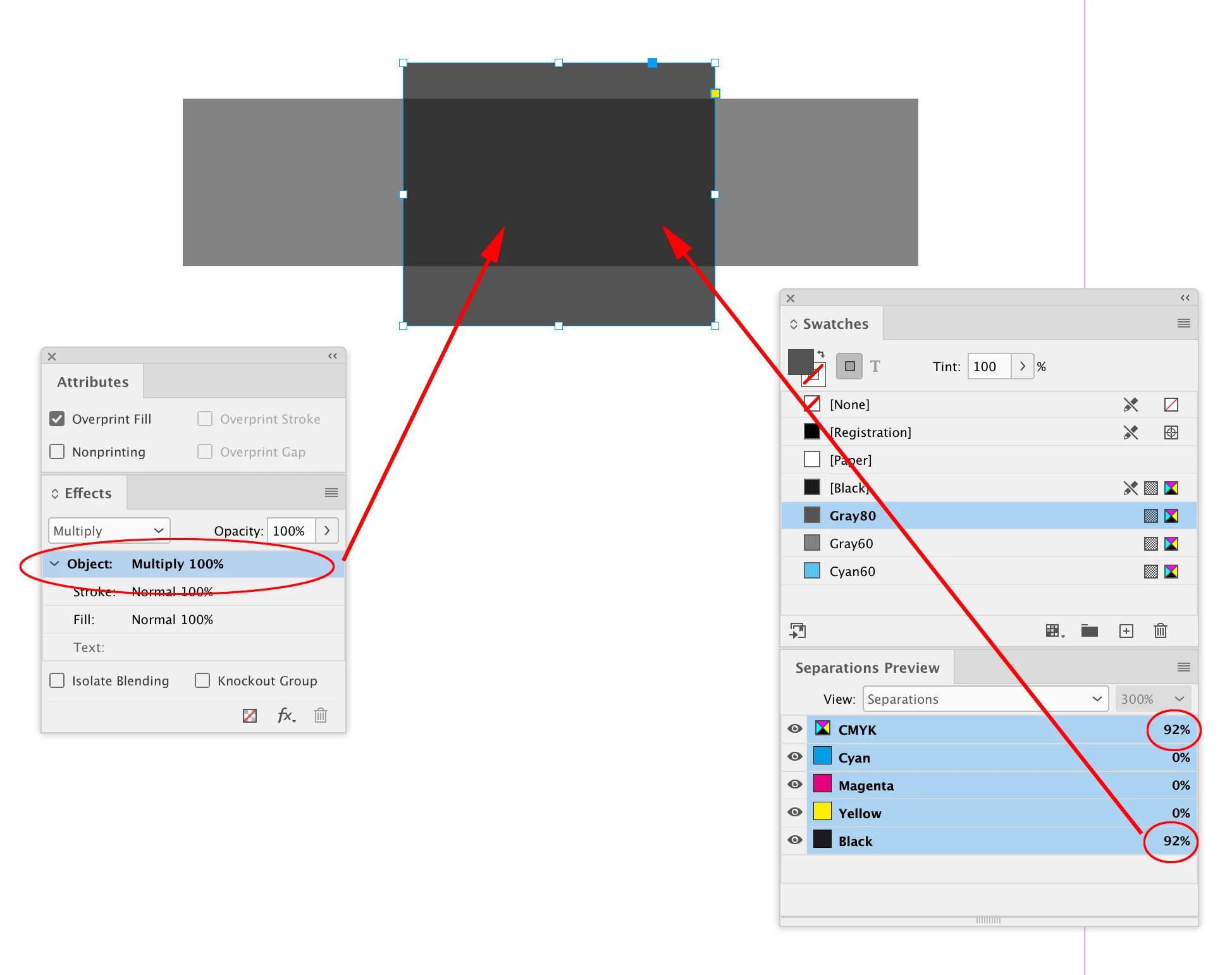

Setting the top frame to Multiply does affect the overlap area, but the Black process plate can never exceed 100%:

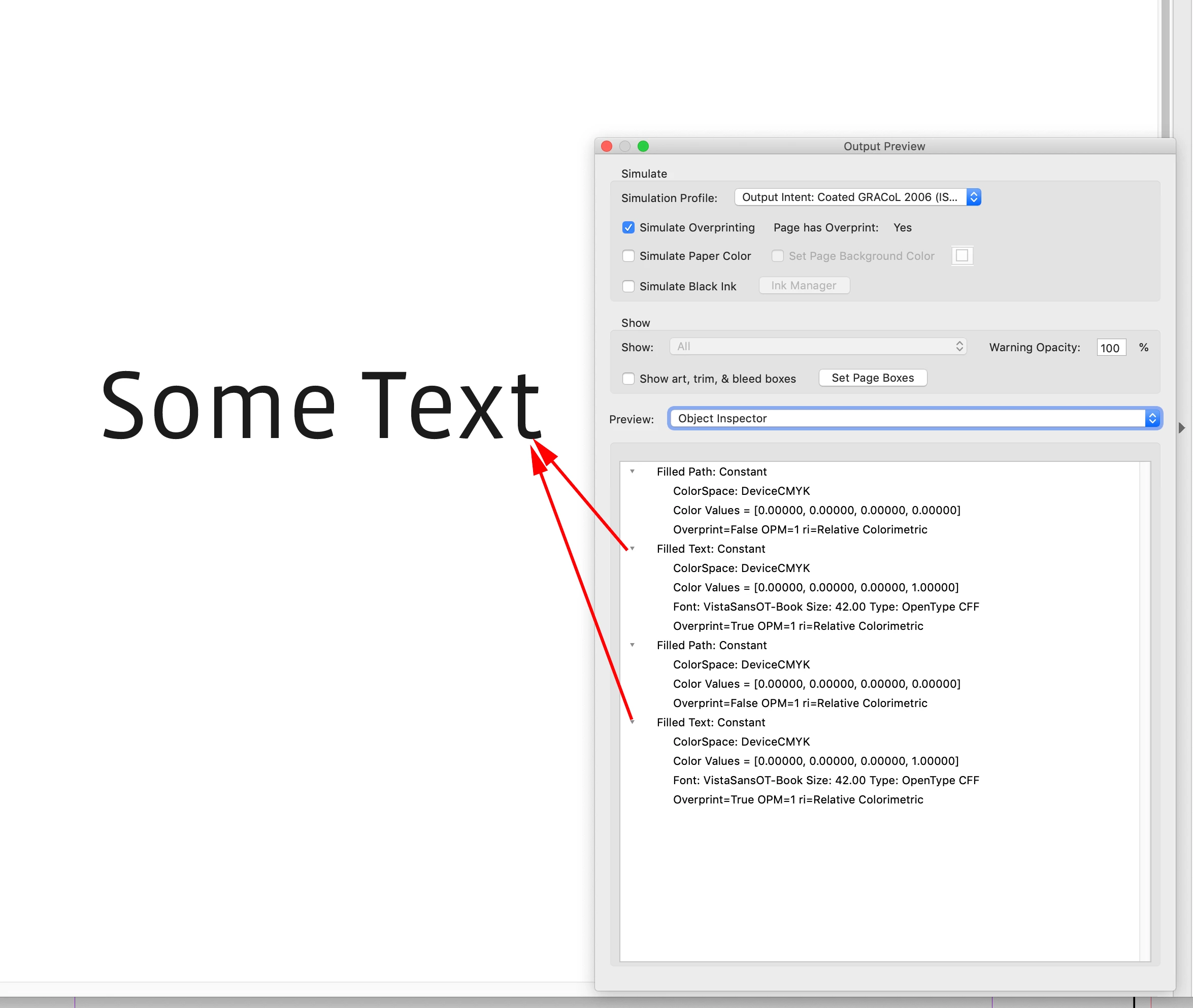

Do you mean via some kind of preflight? I can’t think of a way. CMYK percentages are the RIP’d output values and can never exceed 100% per plate, so they wouldn’t help.
You can check manually in AcrobatPro via Output Preview>Object Inspector—click on the object you want to inspect:

If you type the word 'test'
and overlay it exactly
Open it in PDF in acrobat
Do advanced search for test
and it displays 1 result
'tetest'
not 'test'
