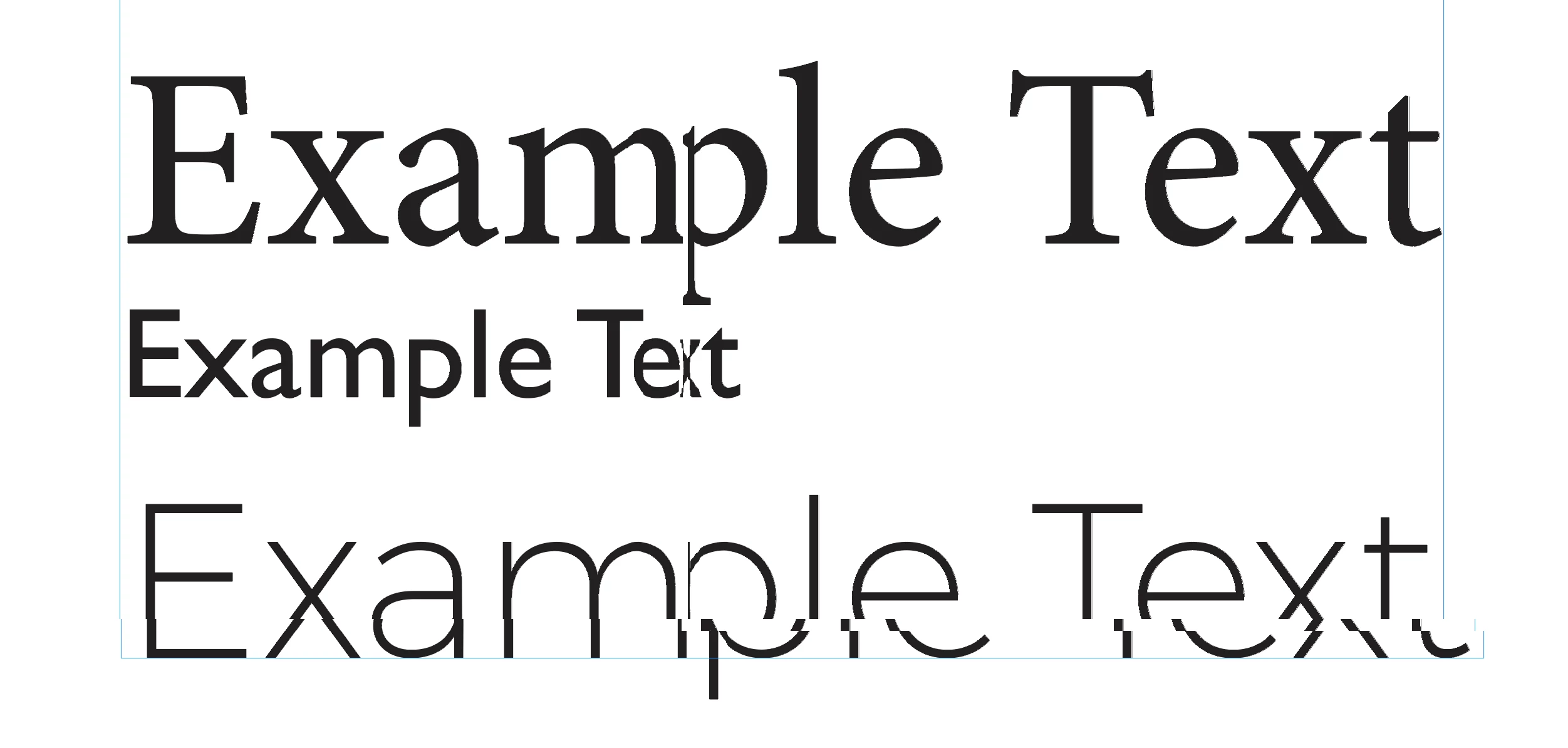

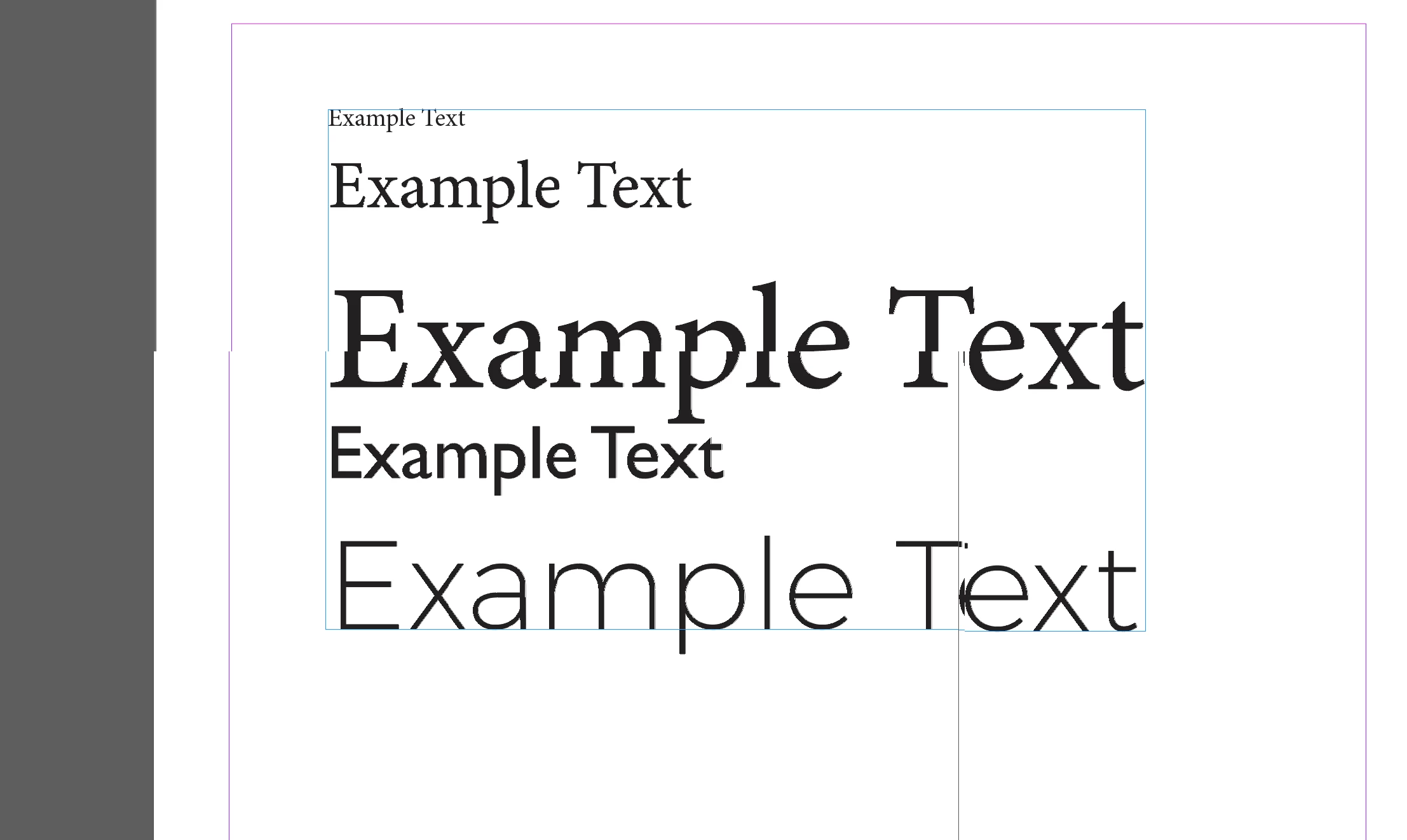

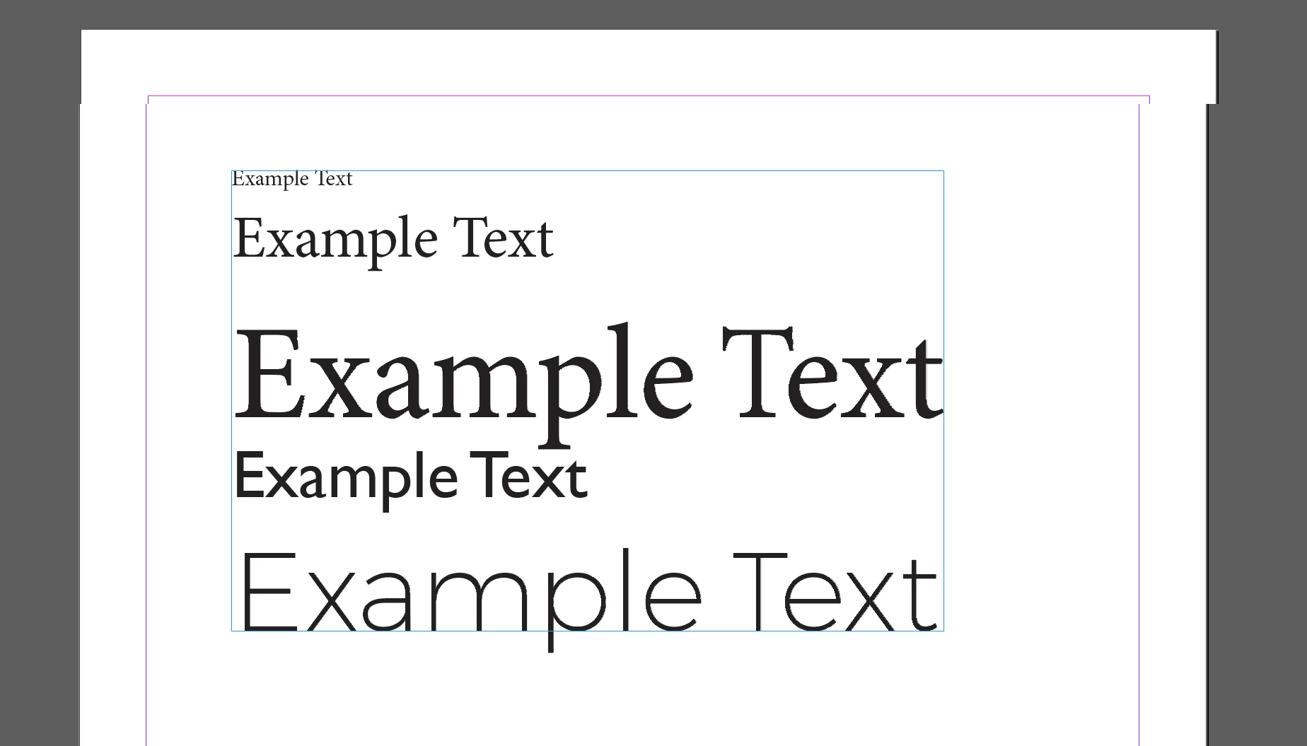

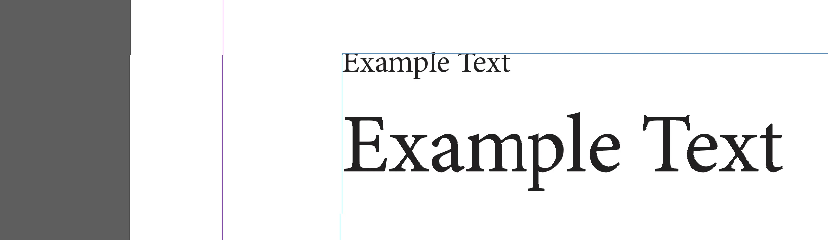

I'm getting near-constant graphical errors in indesign lately (about the past week or two, not sure if an update happened). I'm including screenshots. These look like an interlacing problem on an old monitor, but the fact that I can screenshot them shows that it's not my monitor. These were all taken on the same document, I just zoom in and out and they appear and disappear. I can't figure out if something is specifically causing them. This is a new doc with nothing but a text box. No images, no guides. You can see that the "tearing" is happening to the entire board and not just the text box. It is interestingly NOT happening to any of the tool panels. Also all exports have been fine, the errors aren't there in the final file.
I'm on a mac mini (Big Sur) and using InDesign 17.0.1

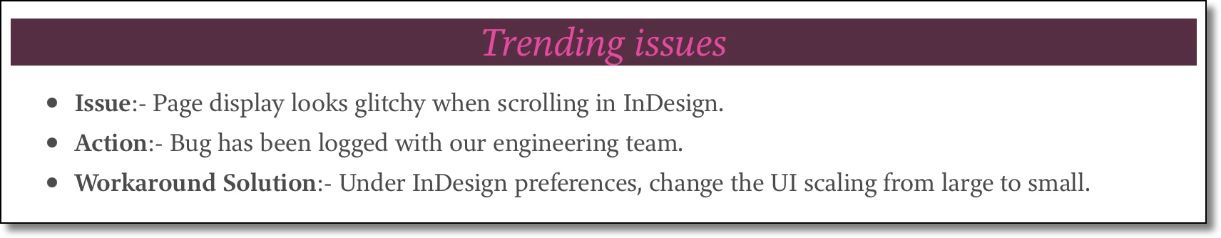

I believe it relates to the UI Scaling. Pull it back down to small and let us know if that helps.
~Barb
~Barb
December 17, 2021
this seems to have worked.
Thank you!
