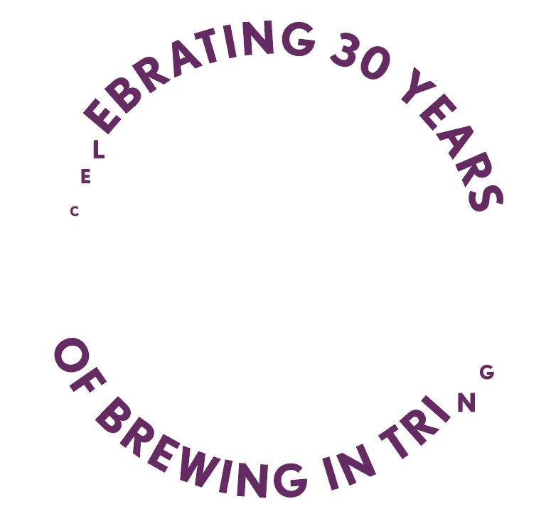

Strange skewing of type on a path when outlining text
Outlining type on a path and get this result (original type attached for reference:
Any ideas what this is?
Type On a Path is set to Rainbow / Align: Baseline / Flip = Yes / To Path = Center. This setup has worked perfectly on dozens of other jobs for years.

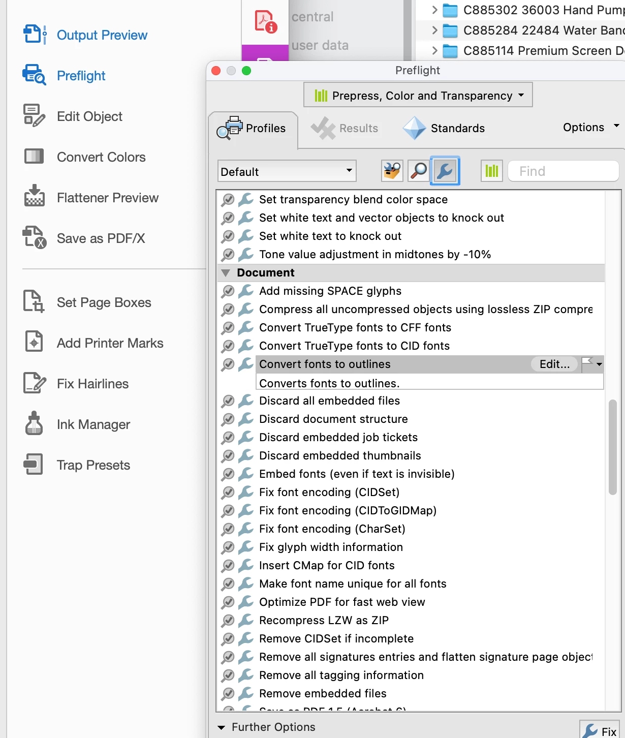

If you have a need for the text be be outlines (for instance, if you have no choice about what printer to use, and the printer is demanding this), then the way to do it is to create the PDF from InDesign with the live text, and then use the preflight tools in Acrobat to outline the text. It's under Print Production > Preflight
This will avoid all of the pitfalls associated with outlining large quantities of text directly in InDesign.

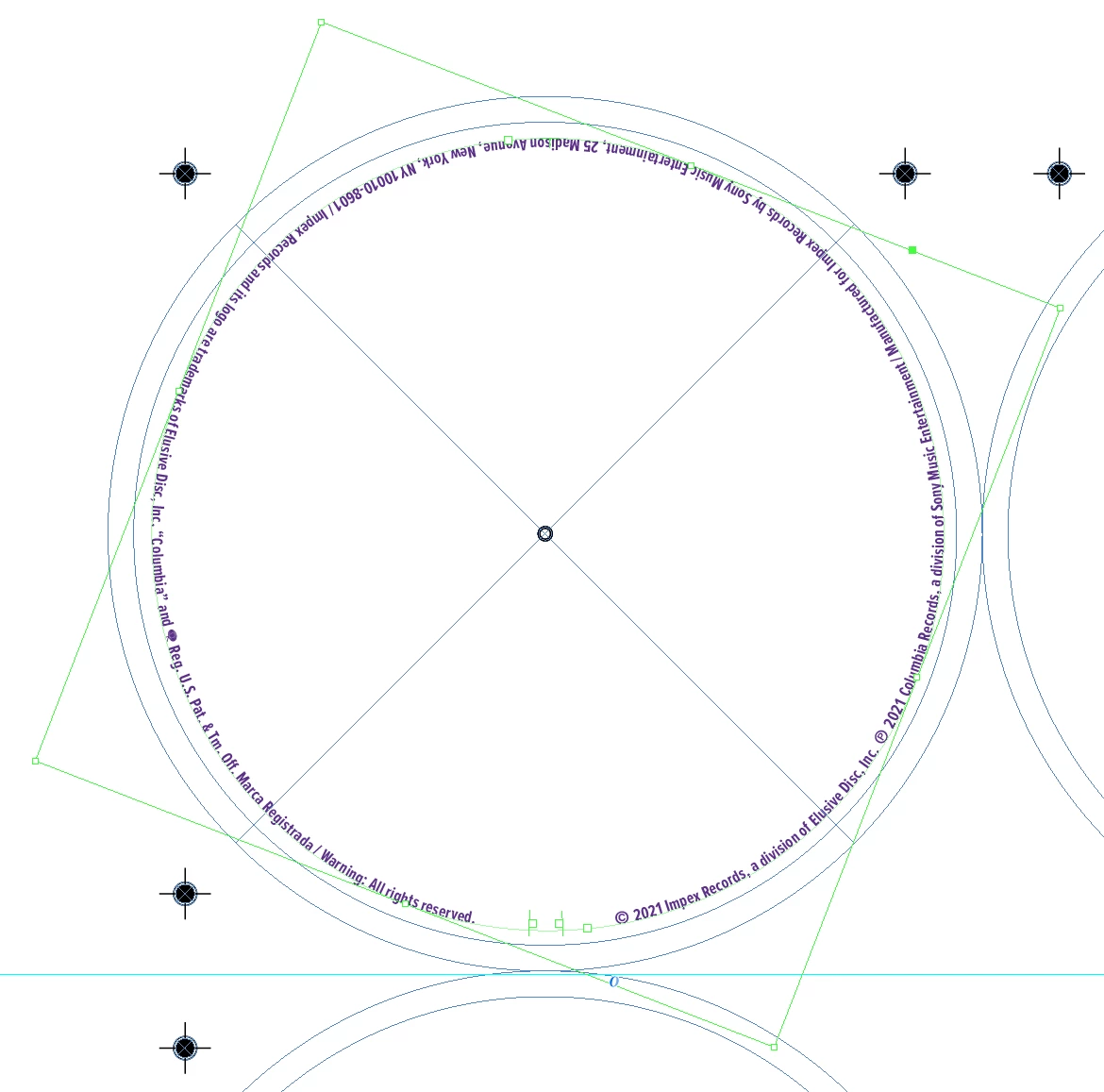

Jan 25, 2022 12:01 PM UTC
I also have this newly manifesting problem in v17.0.1. I hope there's a fix in the next update as I keep having to open up the previous version of INDD to perform this simple task.
simonb61272824
Jan 25, 2022 12:07 PM UTC
...as a PS before someone suggests it; converting to paths in Acrobat is a pretty poor work around, for me. I convert to paths in INDD for elements like this so I have full access to object styling options, which are flaky and volatile when applied to live type.
Nov 24, 2021 10:49 PM UTC
Thank you for the info. Outlining type in Acrobat Pro worked flawlessly. I will update my workflow with this helpful hack going forward!

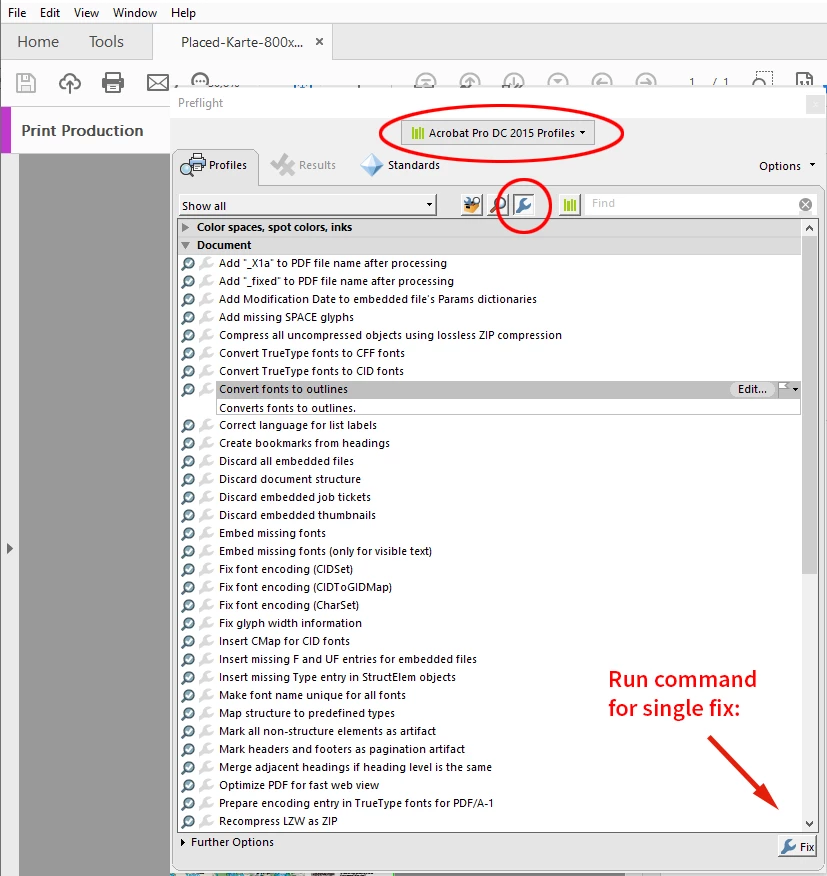

Would it help if you outline the fonts in a PDF with Acrobat Pro DC?
When in Acrobat Pro switch to Print Production > Preflight and run the single fix "Convert fonts to outlines".
