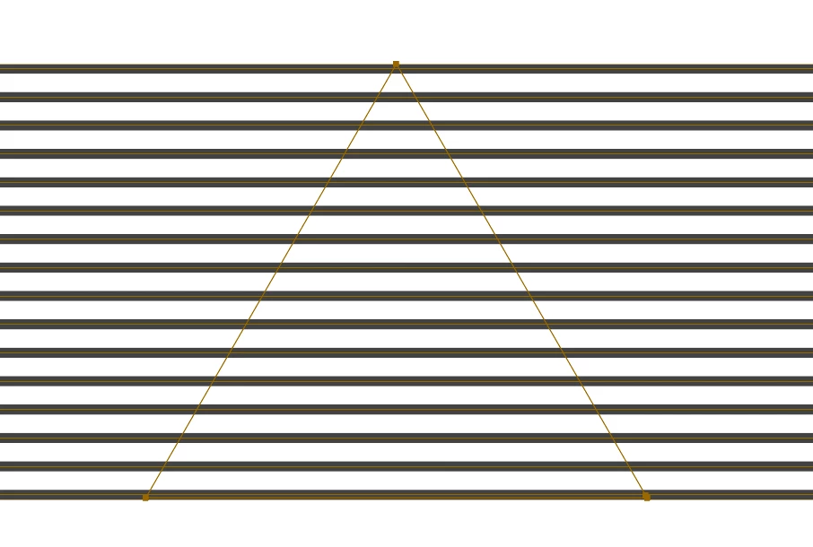

I am trying to make a triangle made up of stripes such as this one:
I attempted to do this by drawing out some stripes, making them into a compound path, and putting a triangle behind the stripes. I then tried to use intersect on the pathfinder tool to create a triangle made up of stripes, but that just created a white triangle with a black outline.
Does anyone know of an easy method I can use to make the type of triangle above? Thanks!

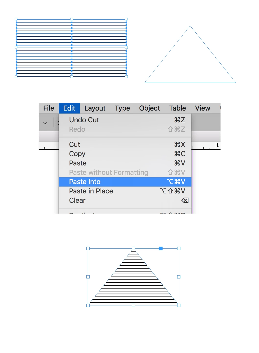

    See screen shot for another way that does not involve converting the strokes into closed paths:
    Draw the set of lines and group them. Then copy (command/control-C) or cut (command/control-C) them to the pasteboard. Finally with the unstroked and unfilled triangle selected use the Paste Into command under the Edit Menu.
