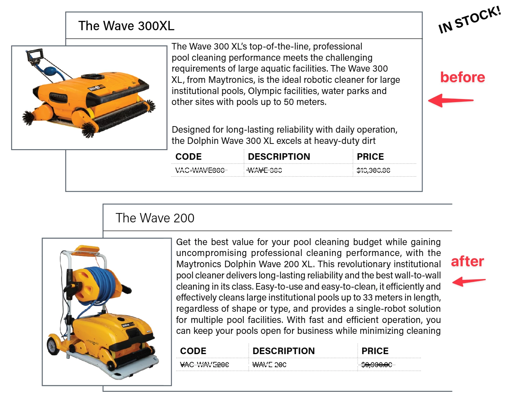

Feb 22, 2023 5:33 PM UTC
Result
Feb 22, 2023 5:35 PM UTC
You can then apply the stroke again by selecting the table and selecting the right edge in the top tool bar - and setting the thickness value for that edge.
