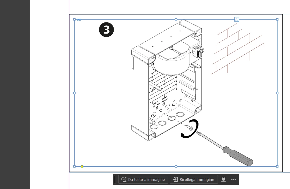

Hello, I’m having issues with the stroke thickness of vector lines in an InDesign document. When I create a PDF using the "Print" function, the lines match the appearance in Illustrator/InDesign. However, when I export the PDF using the "Export" button, the lines become much thicker. I’m not seeing any correlation between what I see in InDesign and the exported PDF paths. The color mode of the PDF created using the "Print" method is composite CMYK. In Illustrator, I usually select "Do not manage color in this document," but the problem is that when I look at the vectors in the InDesign file, they appear as I want them to. But in the exported PDF, they don't. Do you have any suggestions? If you need more information, I can provide it.

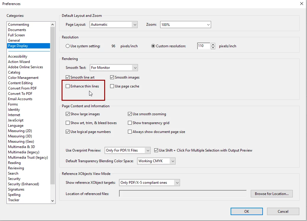

@Eleonora_p, someone may have mentioned this, but in Acrobat Preferences, make sure you don't have “Enhance thin lines” checked:
Nov 11, 2024 8:29 AM UTC
Where I can find this setting?
Thank you

Nov 11, 2024 4:22 PM UTC
Hi @Eleonora_p, in Acrobat, you can find it under Edit > Preferences > Page Display.

4. If possible, could you provide a screenshot of the vector lines in your InDesign document and how they appear after exporting to PDF? This will help in understanding the difference between the two.

Nov 8, 2024 3:29 PM UTC
1. Adobe Indesign 2025
2. I have Windows 11 Pro
3. All documents
