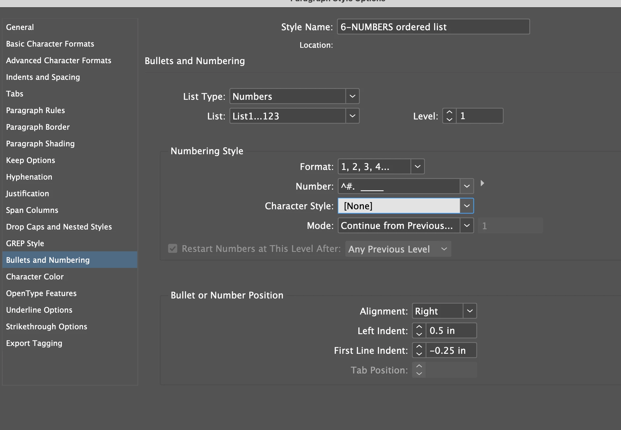

Hello!
Novice user here thinking there must be a way...

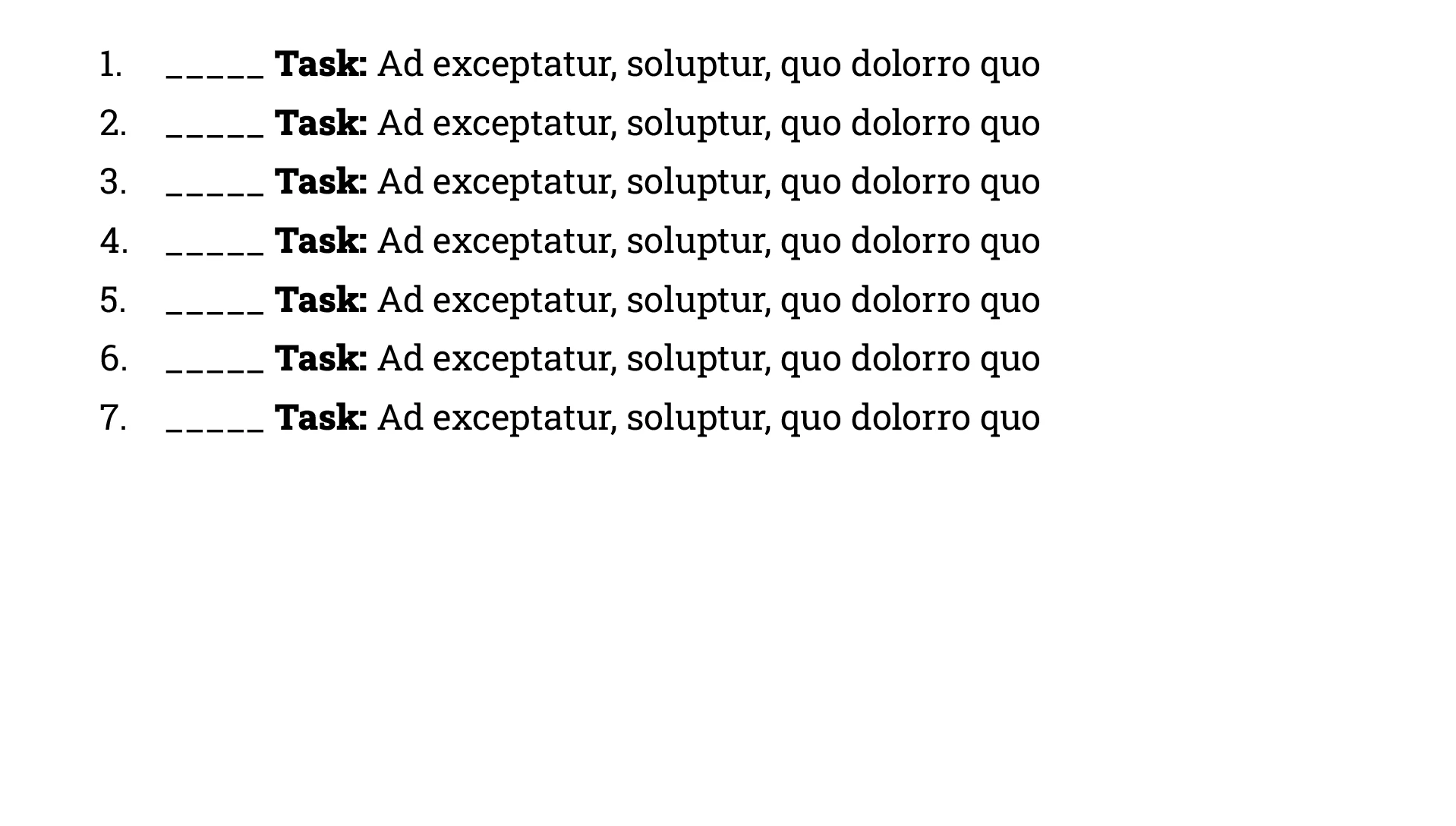

Working on a textbook and trying to create a numbered list (reader needs to put in sequential order by filling in the line before text). Font being used in Roboto Slab and the underscore has gaps between the (5) underscore lines. How can I keep the character style on the numbers but modify the underscore/line to be a solid line?
Any suggestions are much appreciated

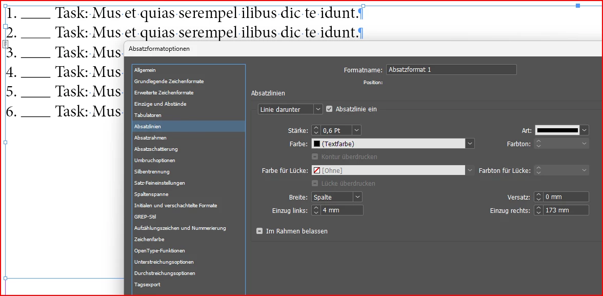

Would a paragraph ruler line be an option for you?

Thank you for your reply. I was able to solve my problem making a few adjustments to the paragraph ruler and it works perfectly. Thanks 😉

This method basically works - with one exception: If text frames with different widths are used in the document, you need a separate paragraph format for each width. However, this does not seem to be the case here.
