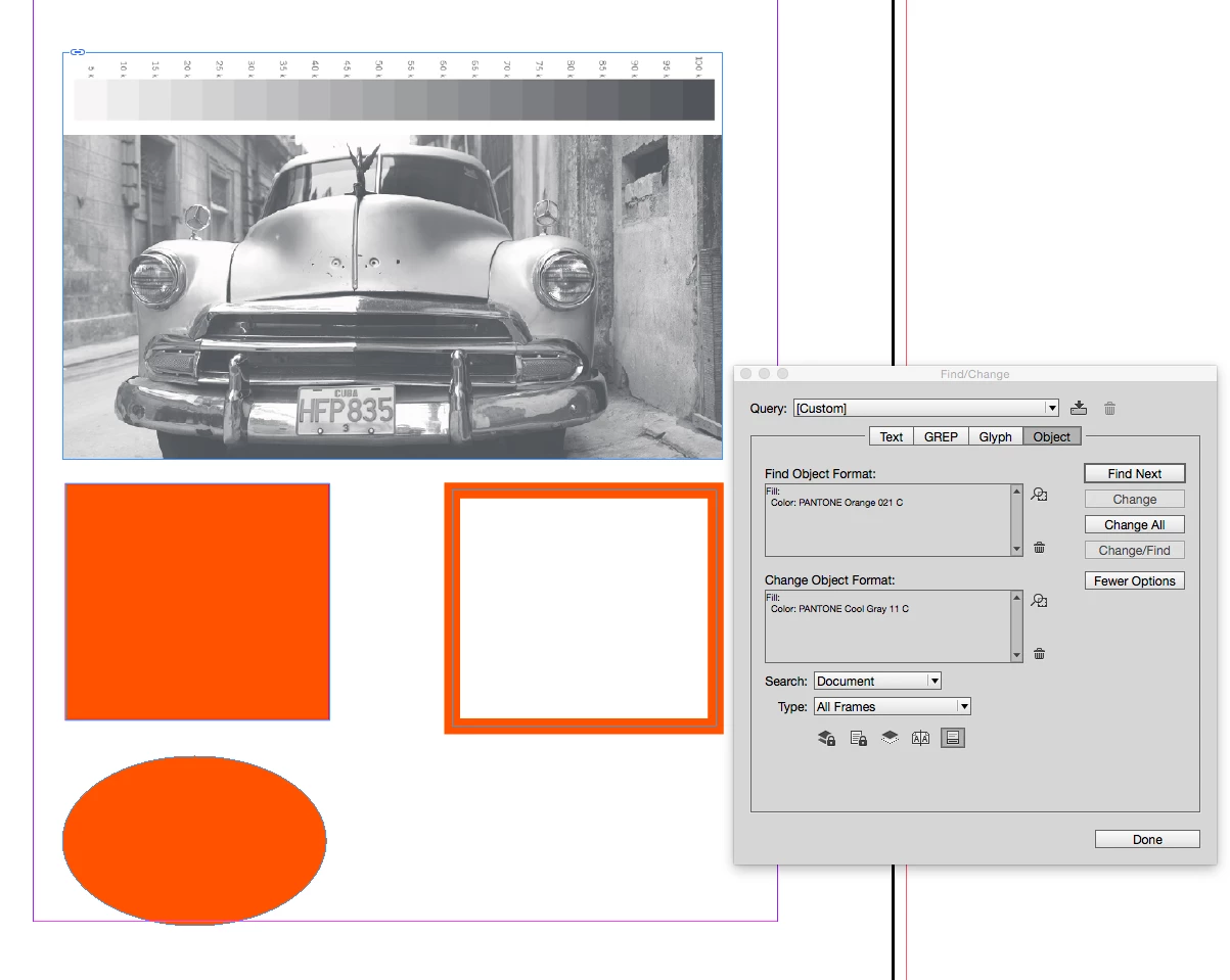

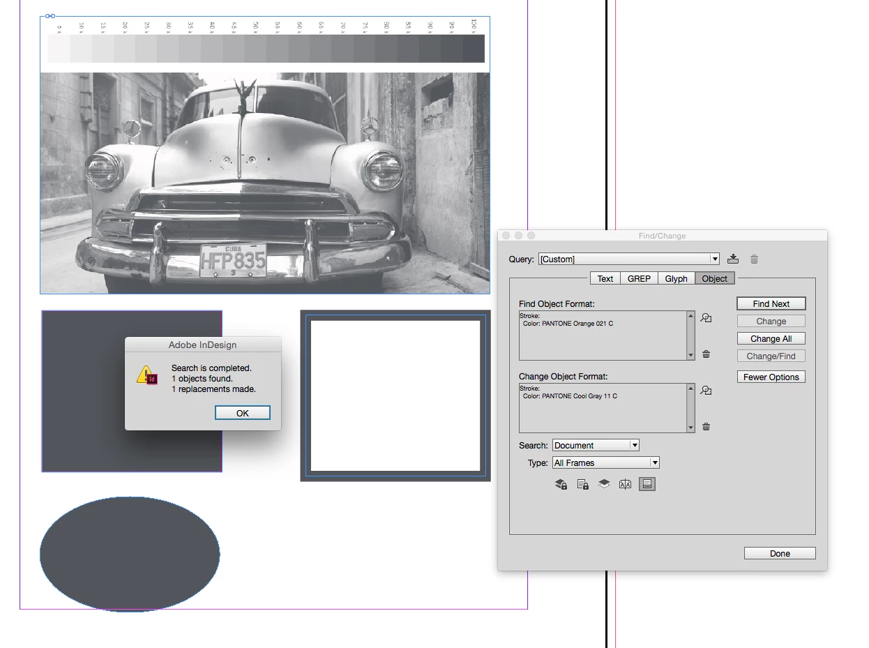

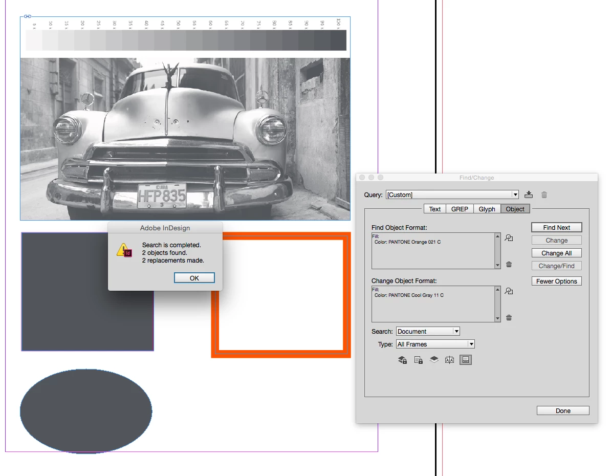

    It¹s too bad there isn¹t a find/change function
    Look at Object F&C
