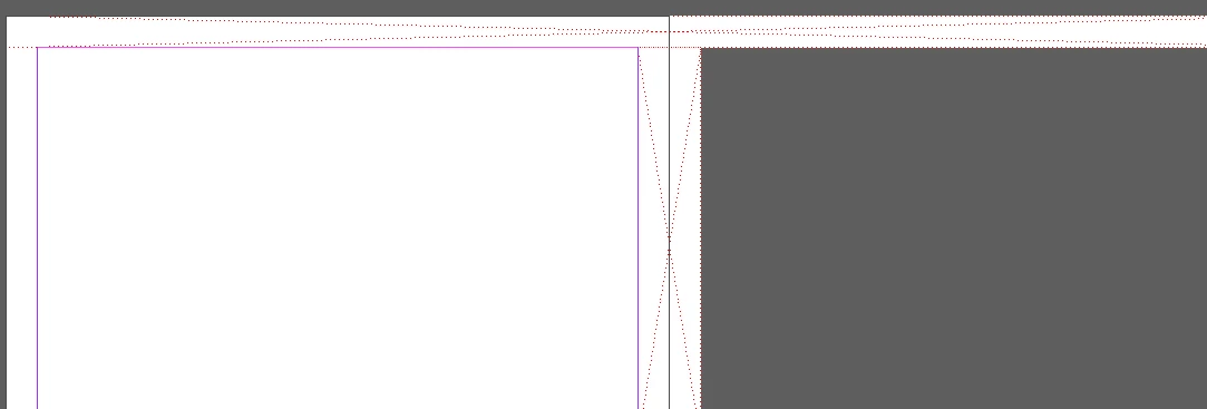

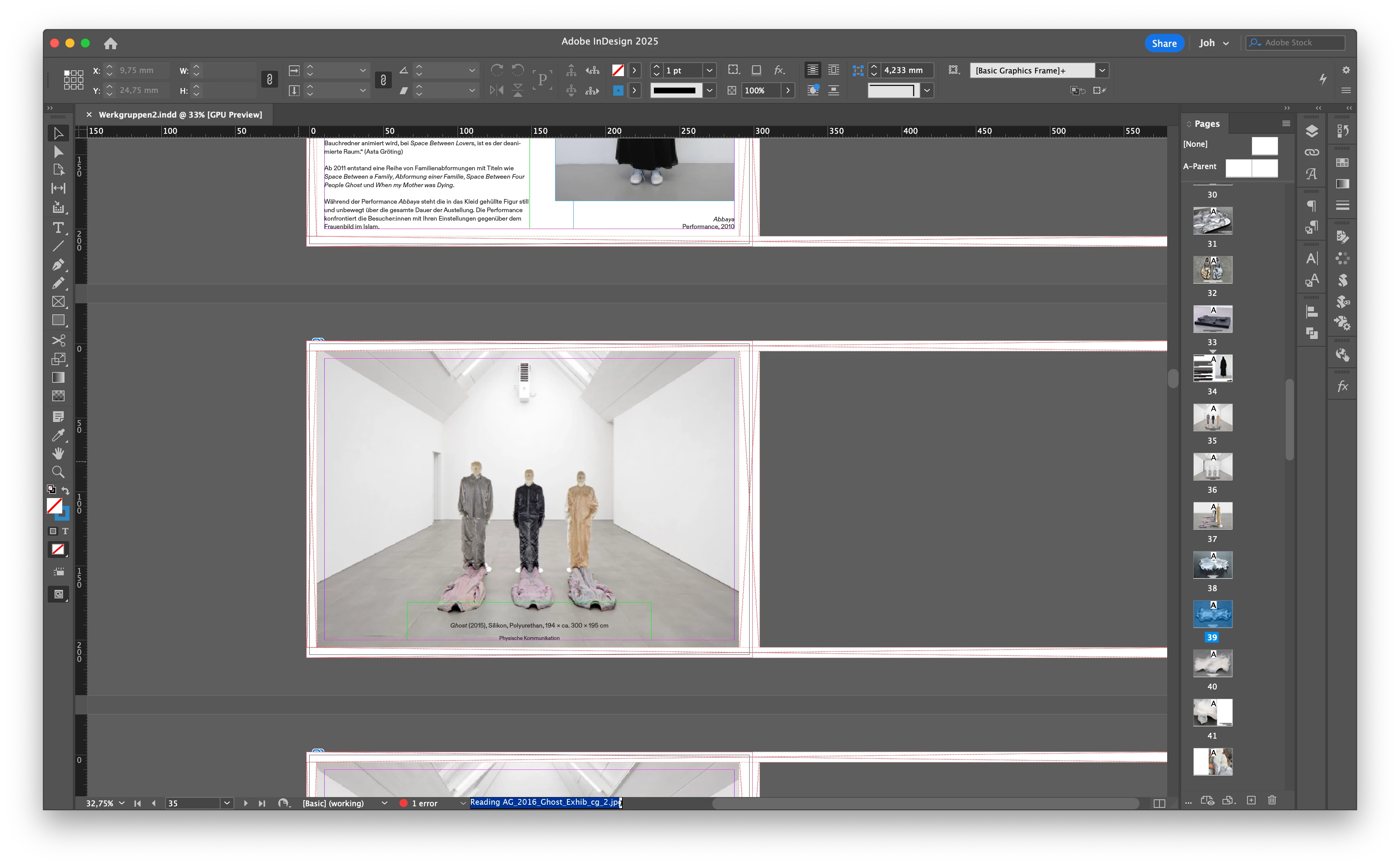

I am working on a document that is over 80 pages, A4 landscape, multiple sections, multiple layers. I turned of facing pages in doc settings.
I am not sure if I accidentally hit a shortcut or if this is a bug.
Suddenly, there is a gap around 5mm on every page where no content is shown. I can also see a "ghost" page to the right.

Looks like you have 3 frames on your parent page.
Unlock the red layer (if it's locked).
Double click on A-Parent and delete the frames.

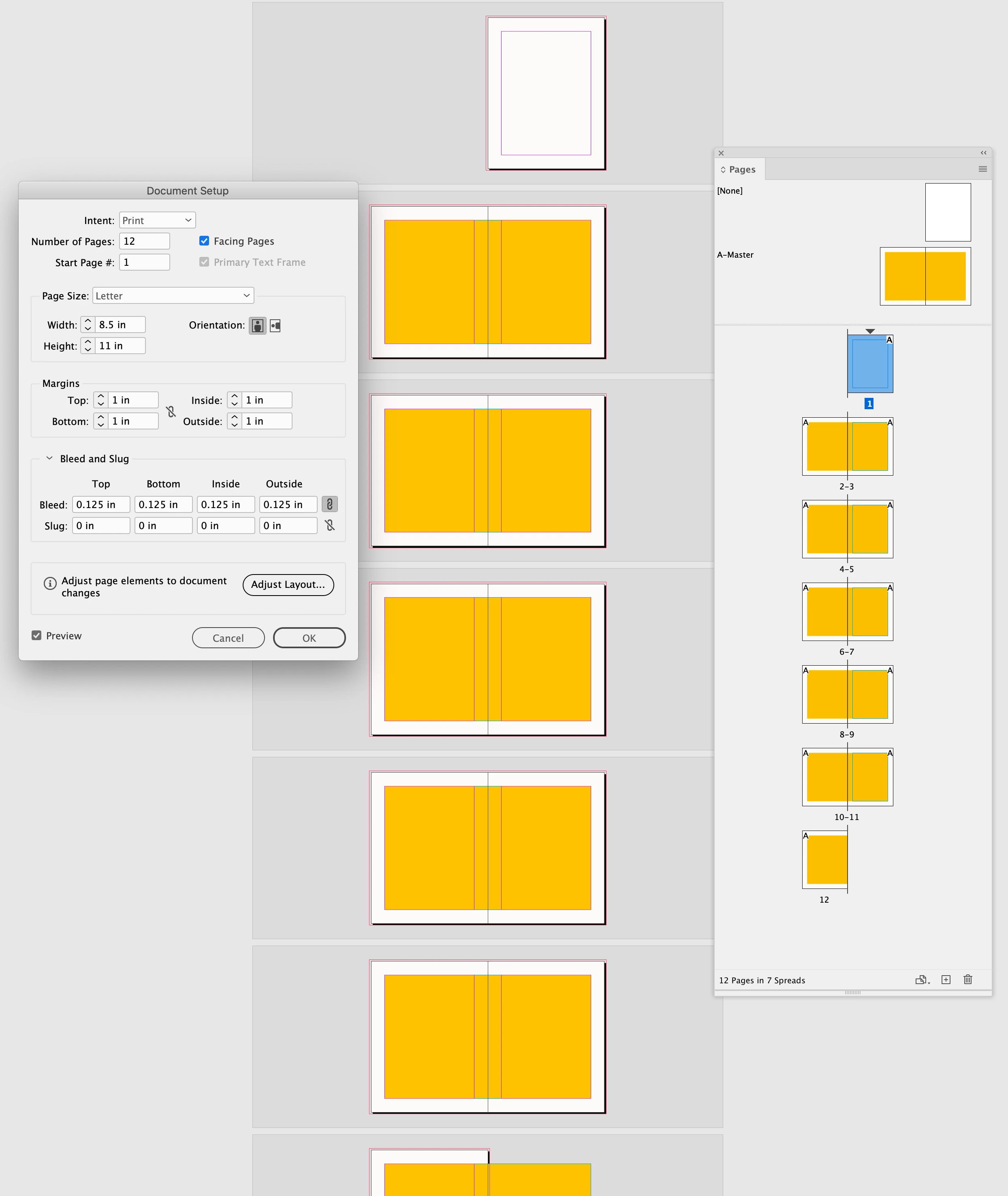

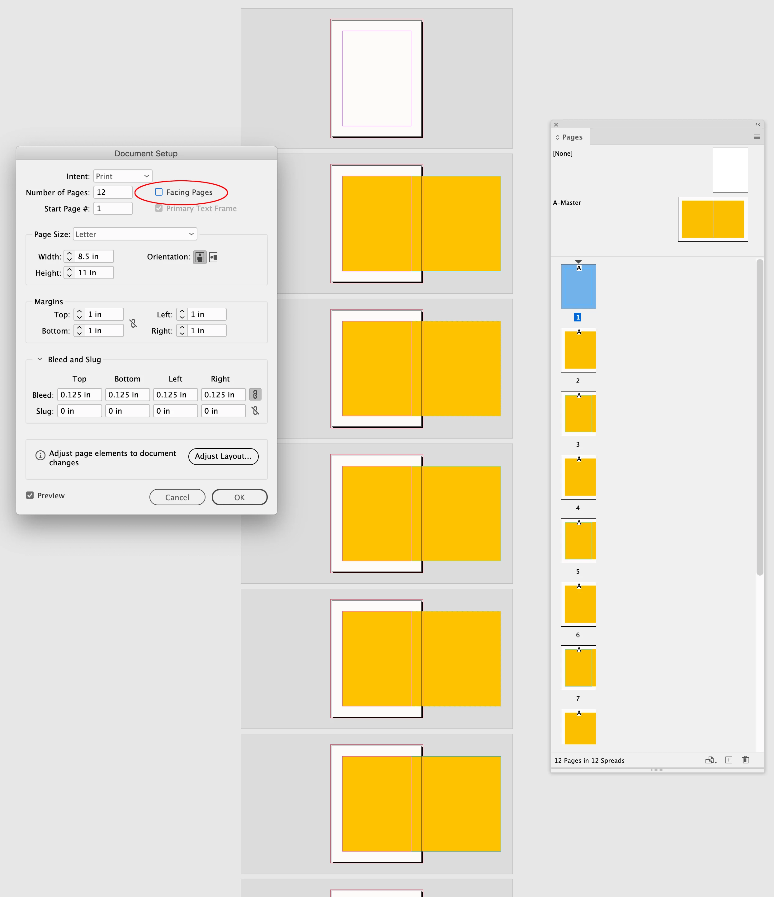

Hi @Zesty_speakerB832 , It looks like maybe you started with the doc set up as Fasing Pages and then switched to non facing?

You still have 2 parent pages. That white frame looks like it may touch the edge of one page. Delete a parent page and remove the spare border/frame.
