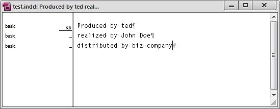

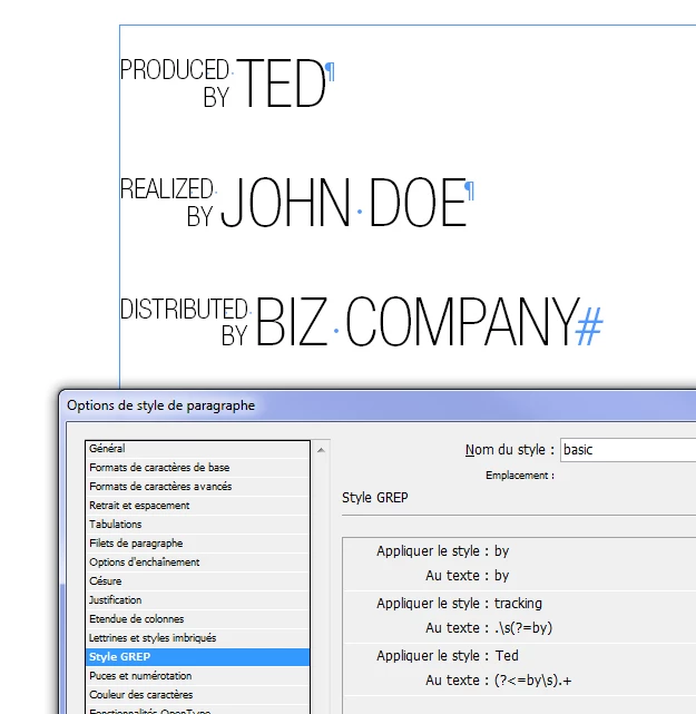

    I can imagine situations (i.e. data merge) where keeping text in a single paragraph is needed.
    Chad's suggestion would definitely do the trick.
    In addition, you could implement GREP styles to your para style, what would give you great control.
    This is an example based on the assumption that you want to deal with "xxxxxx by xxxx" pattern:

    Hi

    Vinny
    Your example is quite elegant, but does that mean you would have to format each paragraph separately for each name? That feels like too much work for a data merge.
    vinny38
    January 19, 2017
    Hi Sandee
    No need to format each paragraph... I used the very same one
    Edit: I guess you got confused because I call my char style "Ted"... I should have call it "who?" ^^
