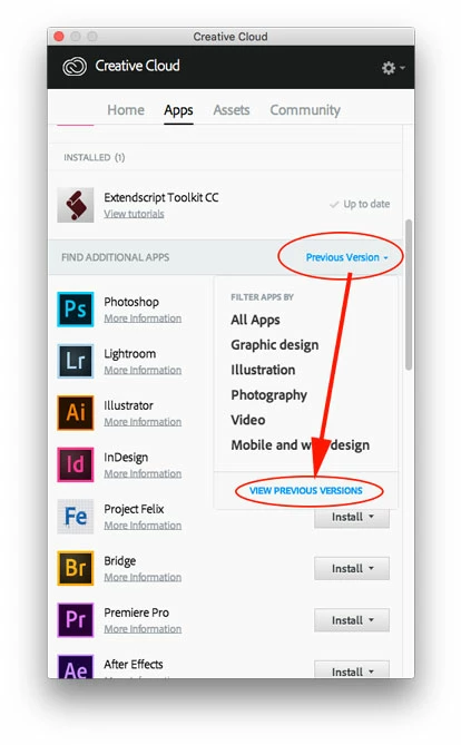

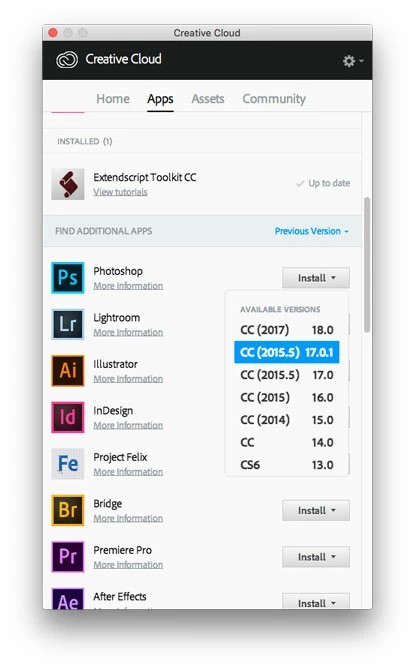

From the Adobe CC desktop menu, scroll up/down to find the section "FIND ADDITIONAL APPS", click on the "Previous Versions" drop menu and choose "VIEW PREVIOUS VERSIONS".

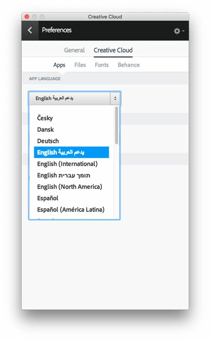

From the same Adobe CC desktop menu, click on InDesign "Install" button to access previous versions, this way you may download InDesign CC (2014) or CC (2017) but before you download, switch your Language to "English يدعم العربية" from the Preferences.
You may proceed to download InDesign CC (2014) with Arabic / Persian / Urdu capabilities now and have both InDesign versions on the same machine. This way you may run both InDesign versions at the same time if needed hence keeping your English version. But don't forget to switch Creative Cloud language in the Preferences menu back to English.

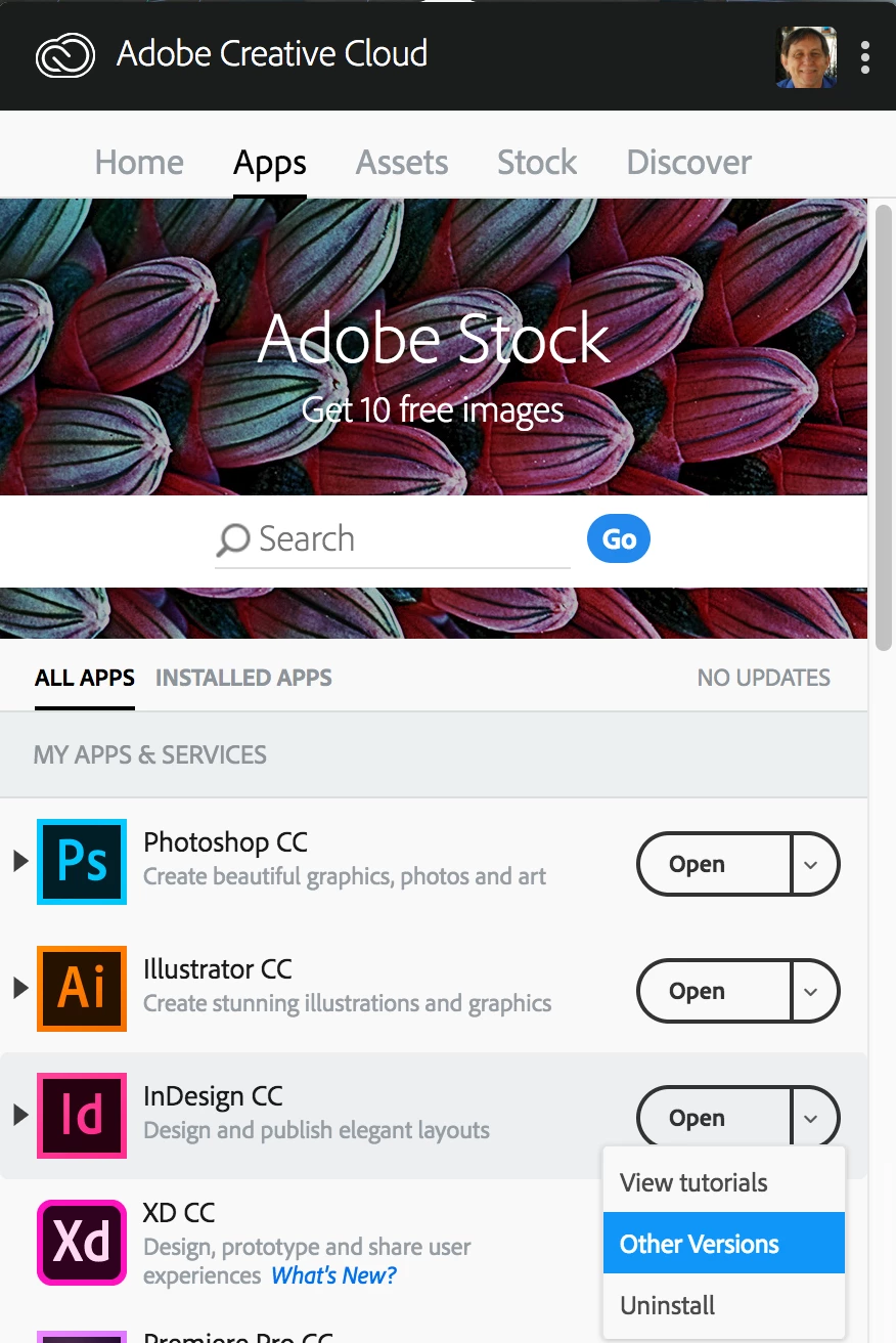

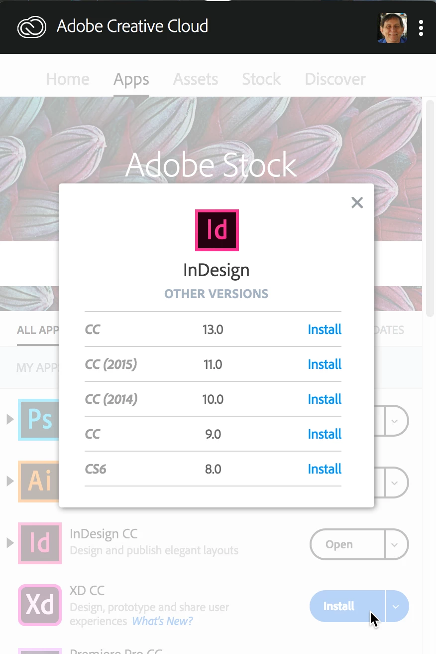

In the latest version of the CC desktop app, the interface has changed a bit for choosing past versions of the applications:
