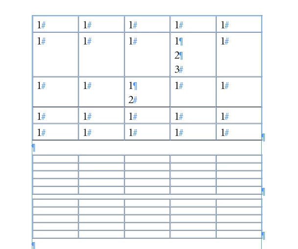

Robert at ID-Tasker
Mar 26, 2025 12:37 AM UTC
@Anna38893690gaxg
Unfortunately, Cell and Table Styles don't have the "height" property as part of their definition.
But you can use this simple script to reset all tables in your document:
app.activeDocument.stories.everyItem().tables.everyItem().cells.everyItem().autoGrow = false;
app.activeDocument.stories.everyItem().tables.everyItem().cells.everyItem().height = 2;
app.activeDocument.stories.everyItem().tables.everyItem().cells.everyItem().autoGrow = true;
The extra benefit - it will first set the height to EACTLY so your Tables will look like this - if they are empty:
If it's not what you're looking for - then please comment first line:
And, just in case:
https://creativepro.com/how-to-install-a-script-in-indesign-that-you-found-in-a-forum-or-blog-post/
