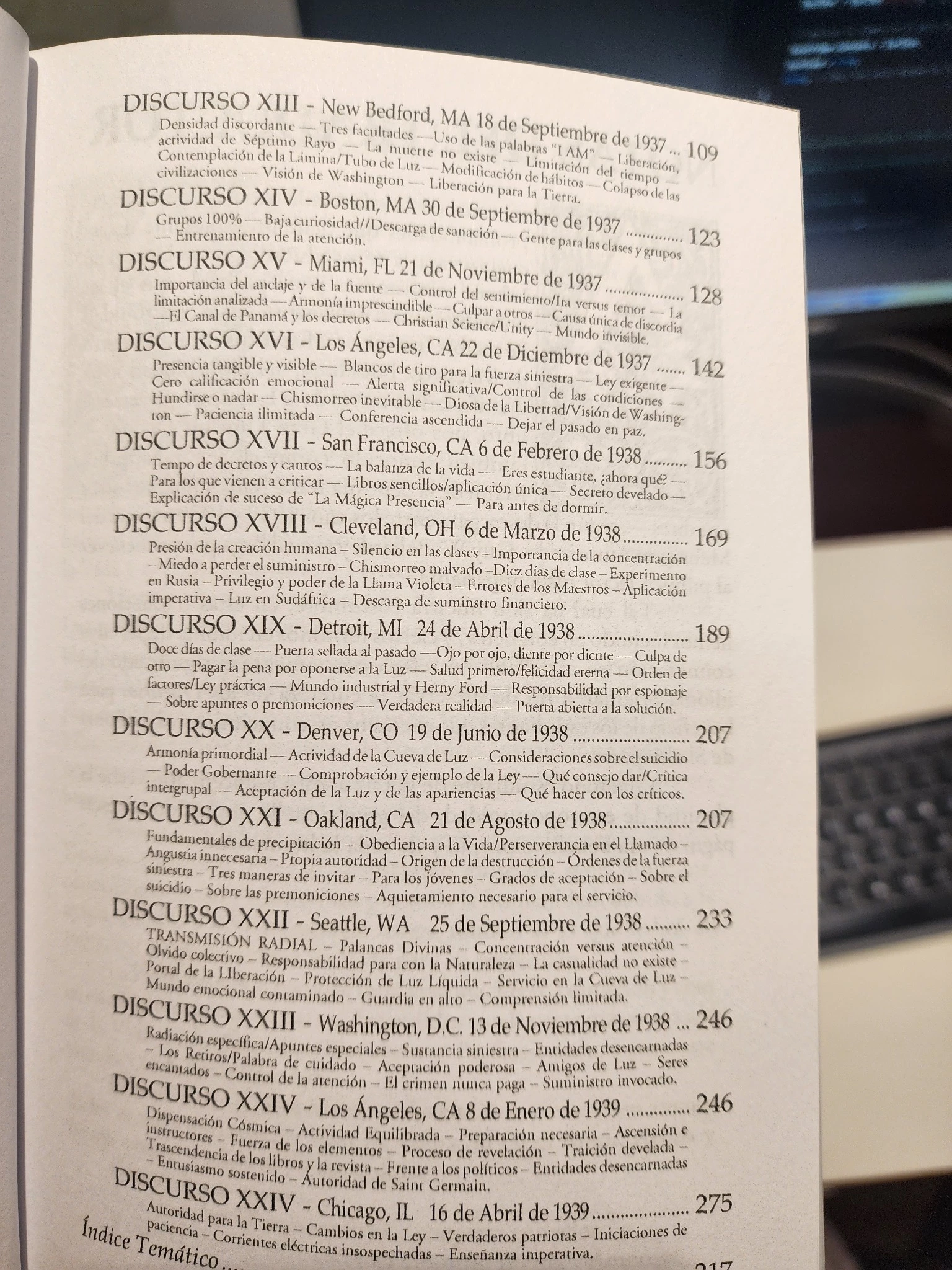

Saludos cordiales.

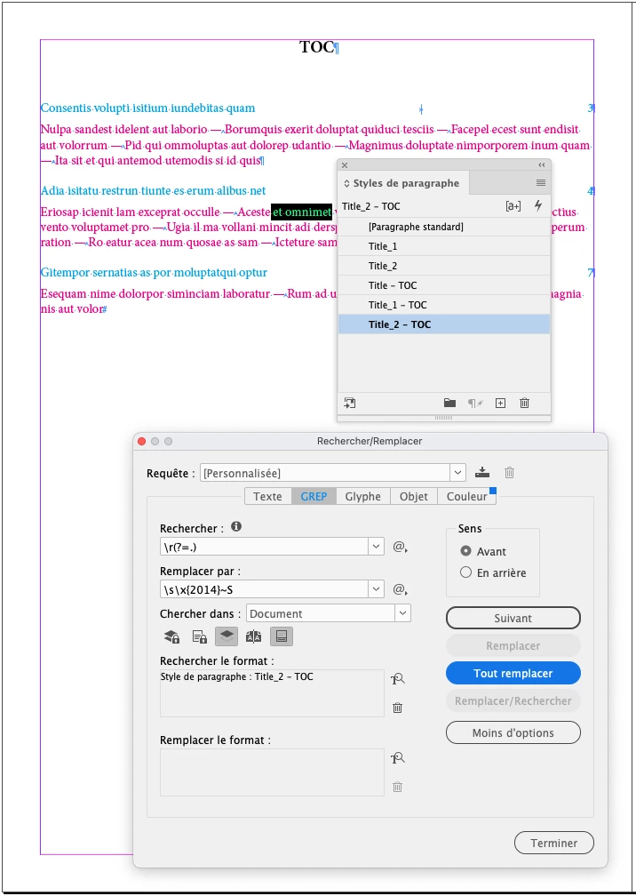

Busco replicar una tabla de contenido como la de la imagen adjunta. De manera que los ítems no queden listados de manera vertical como comunmente suelen quedar, sino de manera horizontal. Me refiero a las letras más pequeñas, las cuales están separadas por un guión largo. He tratado de mcuhas maneras y tengo estilos de párrafo para cada ítem, pero no logro que queden listadas de manera horizontal. Agradecería mucho si puedieran ayudarme.

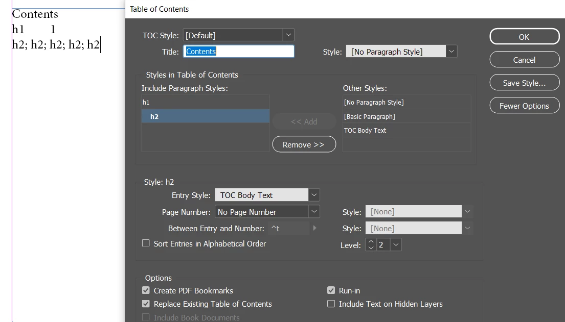

I can get you half way there
But this method automatically inserts a semi-colon and no option to change it - bizarre you can't pick the run-in character...
When generating your TOC in your TOC options - select your H2 or heading 2 that you want and select Run In at the bottom and they will list horizontally
You might be totally happy with the no-option semi colon approach - and doesn't require any additional changes on your part.
I can kinda get you all the way there - RUN IN OPTION change to dassh
Generate your TOC with the Run In as above
Then run the script
Then when you need to update your TOC run the script and it updates the TOC and removes the ; and adds the dash, you can change the character to anything you need.
But there's a flaw in this that I cannot fix - if your text has a ; in the heading listed horizontally it will probably be removed.

As others have mentioned, a relatively simple Find/Change should take care of it. Just make sure you have something you can find that won't be confused with other text. (Paragraph styles looks like it should work here.)

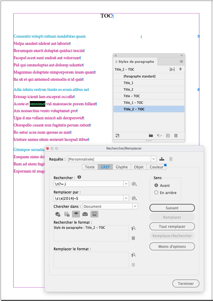

Sure a simple regex will be enough! …
(^/)  The Jedi
FRIdNGE
Mar 2, 2025 10:10 AM UTC
… If you prefer Scripting [that will clearly play the Regex defined in my previous post]!

    _FRIdNGE-0801_TocUpdate.jsx
    Script written by Michel Allio [01/03/25]
    See:  https://community.adobe.com/t5/indesign-discussions/tabla-de-contenido-horizontal-en-indesign/td-p/15184719
// To Be Defined -------------------------
var myParagraphStyle = "Title_2 - TOC";
var myReplacement = "\\s\\x{2014}~S";
// SCRIPT 1:
// Supposing there's only 1 TOC:
var myStories = app.activeDocument.stories,  S = myStories.length,  s;
for ( s = 0; s < S; s++ ) if ( myStories[s].storyType == StoryTypes.TOC_STORY ) {
    var myTocStory = myStories[s];
    myTocStory.insertionPoints[0].select();
    app.menuActions.itemByID(71442).invoke();
    break;
app.findGrepPreferences = app.changeGrepPreferences = null;
app.findGrepPreferences.findWhat = "\\r(?=.)";
app.findGrepPreferences.appliedParagraphStyle = myParagraphStyle;
app.changeGrepPreferences.changeTo = myReplacement;
myTocStory.changeGrep();
app.selection = null;
// SCRIPT 2:
// Supposing there's 1 TOC. So place the cursor inside the TOC:
// Supposing there's several TOCs. So place the cursor inside the right TOC:
app.selection[0].parentStory.changeGrep();

After generating and regenerating run a find and replace with a GREP to get the toc in its final form. After setting it up, it is a one command task in the future.
