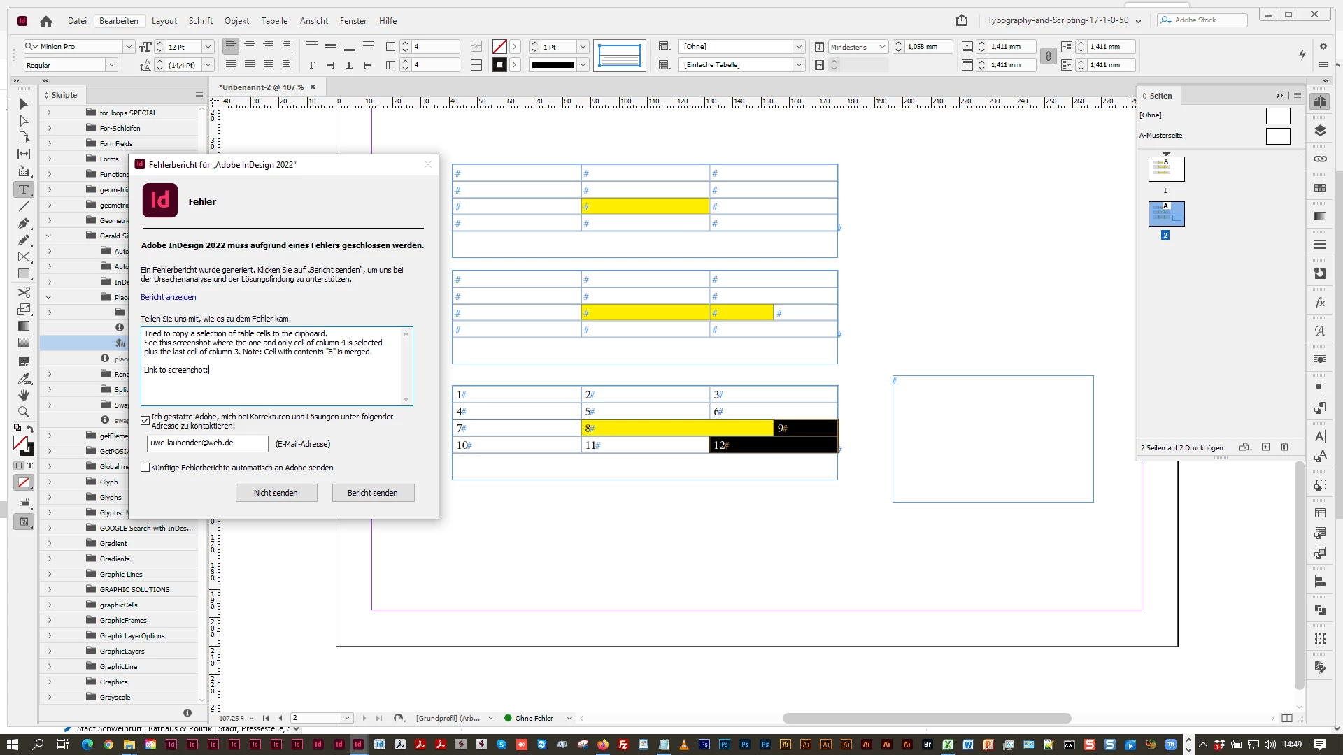

Note: You will not be able to copy the contents of the selected 3rd column to the clipboard.
As I tried to copy the selected cell in column four and the last cell of column three together to the clipboard, InDesign 2022 crashed:
