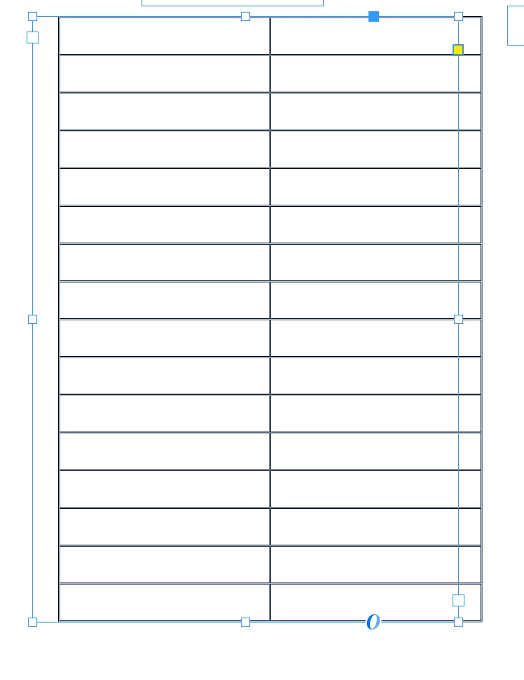

All of a sudden I cannot get a table to be centered in the bounding box for the life of me. I use tables frequently (often with 30+ rows and 10+ columns) and have never had this problem. With this table I can adjust the right side of the box up to the edge of the table but when I do the left and table jumps to the right. Anyone have any idea how to fix this? I havent changed any settings to my knowledge. I had just worked all morning on another table with no troubles. Thanks in advance!

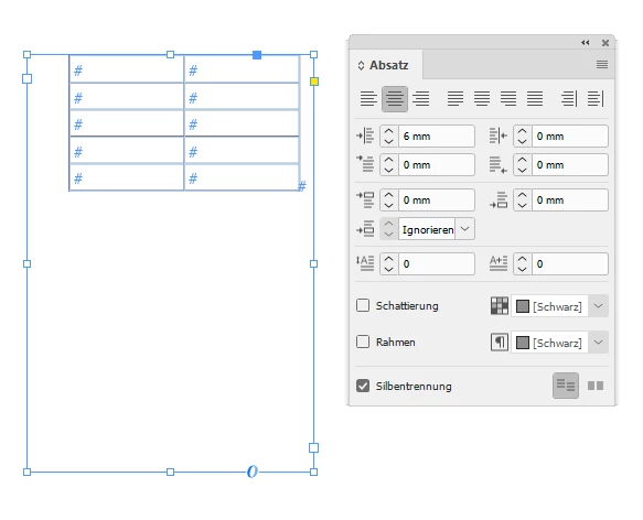

Hi Sarah,
check the formatting of the paragraph that is holding the table.
Could be a left indent value that is not zero.
From my German InDesign where the Paragraph panel is showing a left indent value of 6 mm with the paragraph that is holding the table:

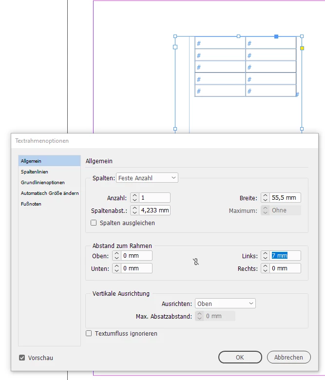

Or look after the Text Frame Options if there is a left indent there.
Just like this:

Hi Sarah,
Just like this:
