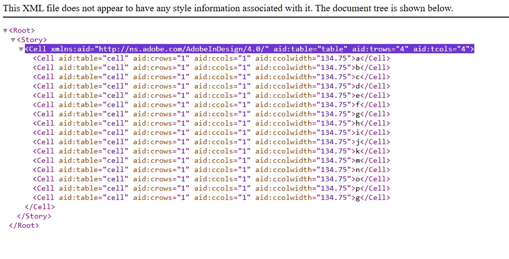

Have you tried exporting a sample table as XML from InDesign?
Balaji Murugesan
Mar 9, 2025 4:01 AM UTC
The default export XML file from the InDesign application uses the Tables 4.0 namespace.

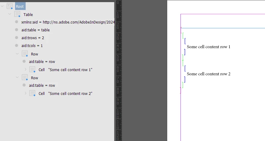

Mar 8, 2025 9:31 AM UTC
Maybe you need to add row elements?
<Table xmlns:aid="http://ns.adobe.com/AdobeInDesign/2024/" aid:table="table" aid:trows="2" aid:tcols="1">
  <Row aid:table="row">
    <Cell aid:table="cell" aid:theader="" aid:crows="1" aid:ccols="1" aid:ccolwidth="442.7142857142858" >
      Some cell content row 1
    </Cell>
  </Row>
      Some cell content row 2
    </Cell>
  </Row>
</Table>
Balaji Murugesan
Mar 8, 2025 9:45 AM UTC
No luck.
