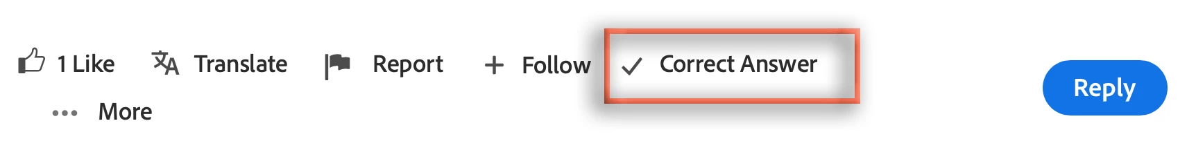

Hi Nedlaw: If you make the browser window wider, the Correct Answer button will appear below each post. If it is too narrow, the option disappears.
Glad we could help and happy Friday,

Thanks. I see your included image, but I now have my browser spread across two 4K monitors, and no "Correct Answer" button appears next to the +Follow item. I'm using Chrome on a PC. Maybe that's the problem.

Any moderator can mark the correct answer for you. They are still working on giving the Original Poster the same ability.
I have marked Barb's answer as you indicated.
