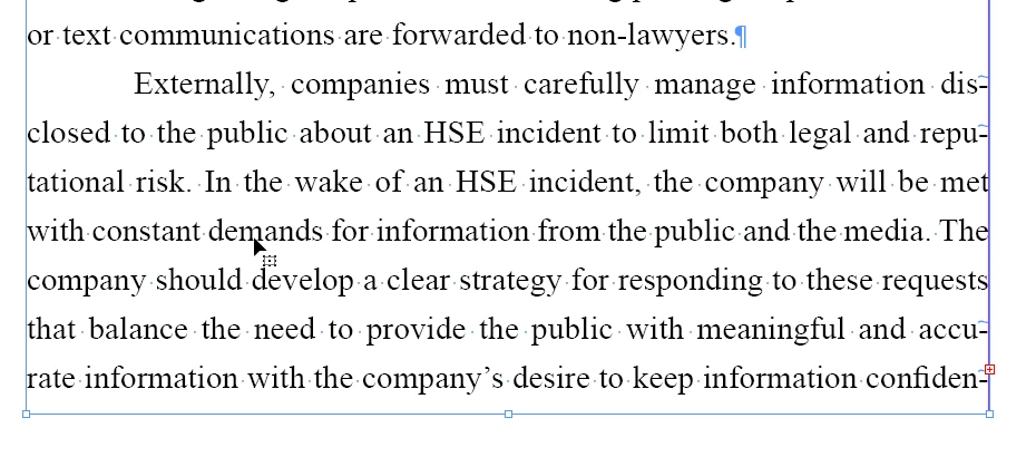

Do you have a little red plus sign at the bottom of the frame? This means you have overset text. Text that would flow into the frame or a linked frame if it could fit.
Make sure the frame is selected and View > Screen Mode is set to Normal.
Usually when text (including tables) goes into overset and refuses to flow into a new frame, the problem is that the text has something in it that won't fit in the new frame. It could be that you have several table rows all set to Keep with Next row. They're all doing as they're told, but those rows can't fit together in the frame. It could be that you have one row set to a depth greater than your page. Same thing: It can't fit in the frame, so it jumps to the next frame, but the next frame is the same size so the text display just ends, even though the text is really there but not showing. My usual solution for this is to just make the frame really deep (or wide) until the problem text fits.
