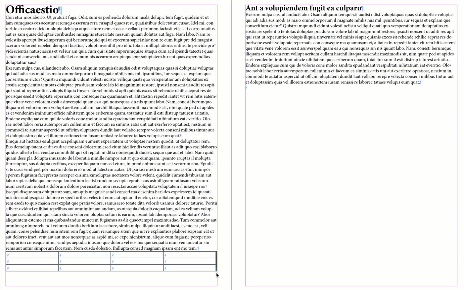

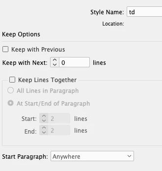

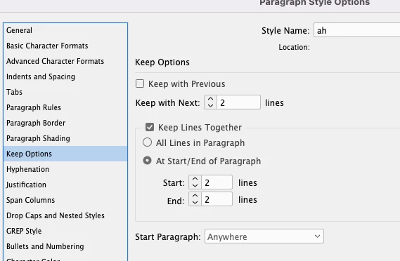

I'm designing a book, and have a table that keeps attaching itself to an A head that follows. There is plenty of room for the table to end on one page, but one line keeps bumping to the next page with the A head. I have removed all the keep options in both styles; tried adding a blank row to the table; and adding a return. Nothing has worked. I've run out of ideas for how to fix this.

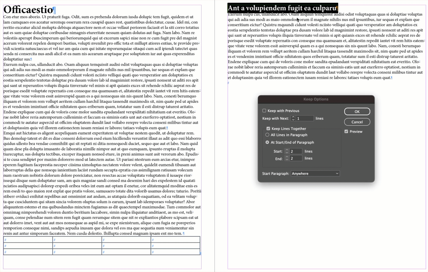

Try clicking on the A Head and disabling Keep with Previous.

As mentioned above, I have disabled ALL keep options on both the table and the A head.

Can you show actual screenshot(s) of what you have disabled / enabled ?

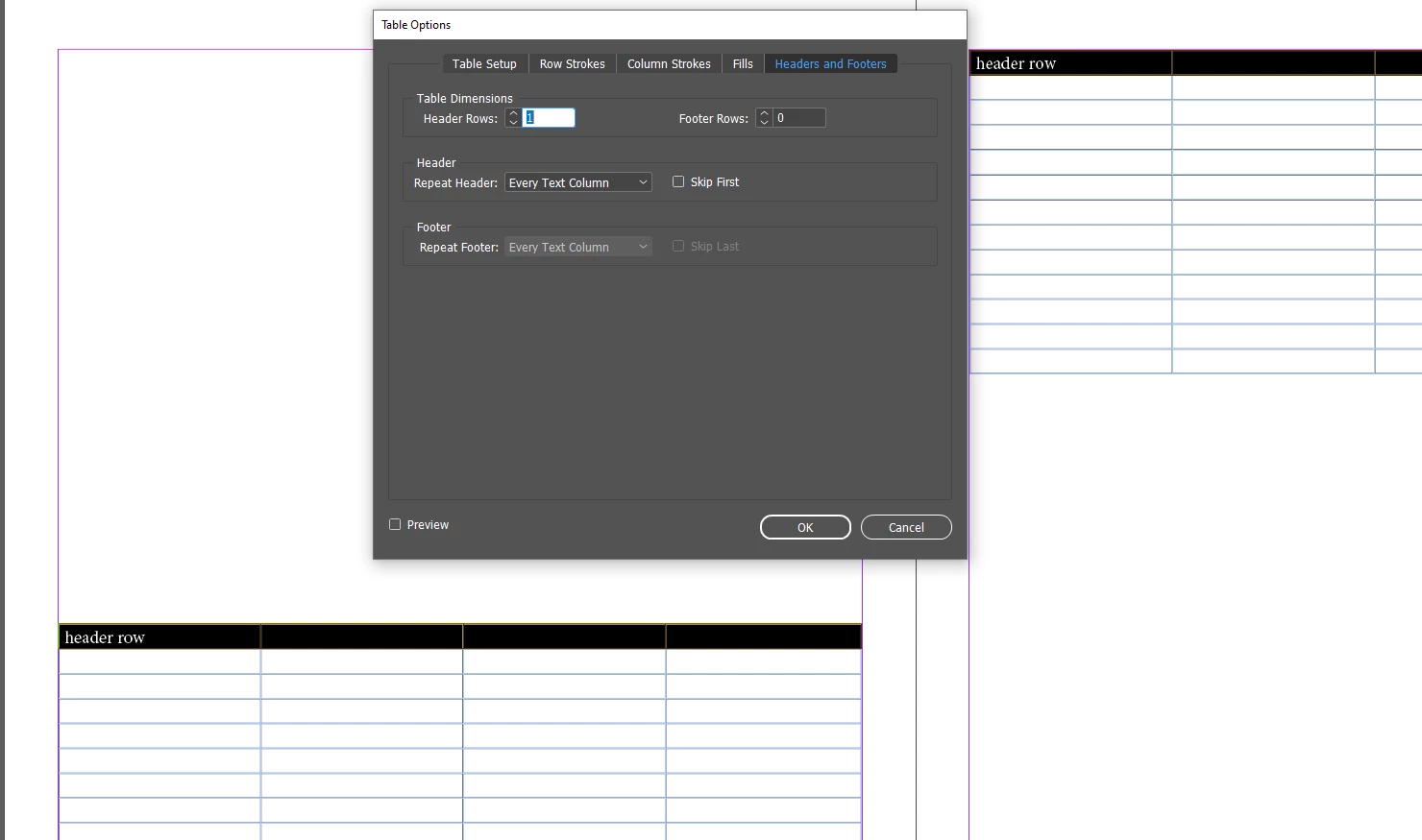

For the header to start again on the next page, there is an option: repeat header.
Table menu > Table Options > Headers & Footers
