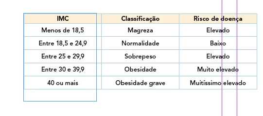

RibnogAuthor
August 7, 2017
Hi.
Here the screenshots:
In the first page works even with this error message.
When I click OK:
But in the second page with another table, nothing happens:
