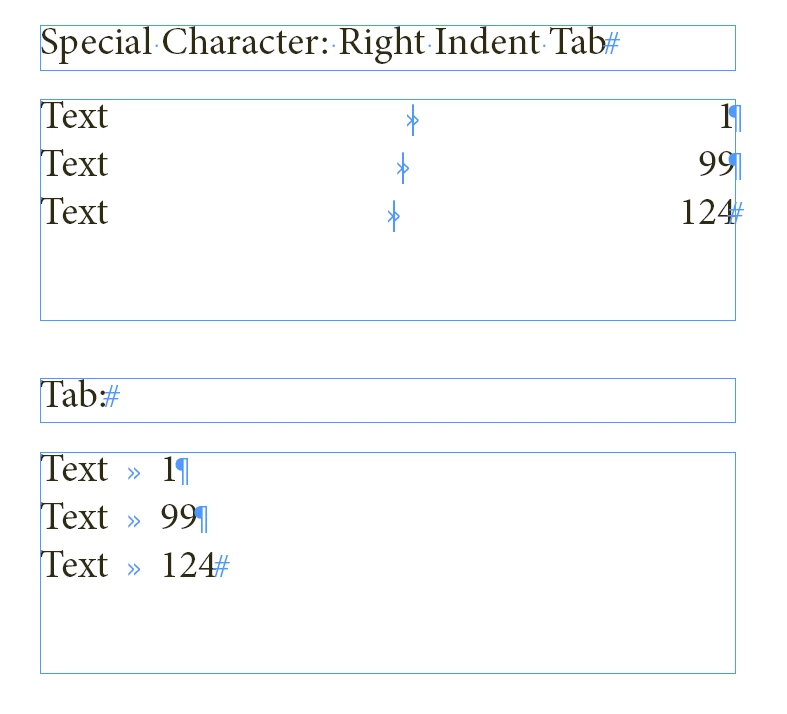

Hi PeekASaBoo ,
I'd suggest using special character Right Indent Tab instead of Tab.
Just do Shift + Tab to get this.
Right Indent Tab vs Tab:
Uwe

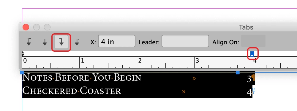

Steve Werner
July 1, 2019
It's looks like you're almost there. (1) It looks like you have tab characters in each in line, and (2) you've selected the text you want to set the tab alignment.
Next (shown below), (3) click the tab alignment icon you want—probably align right. Then (4) drag just above the ruler to the alignment point, or type a number in the X field, I chose 4 inches.

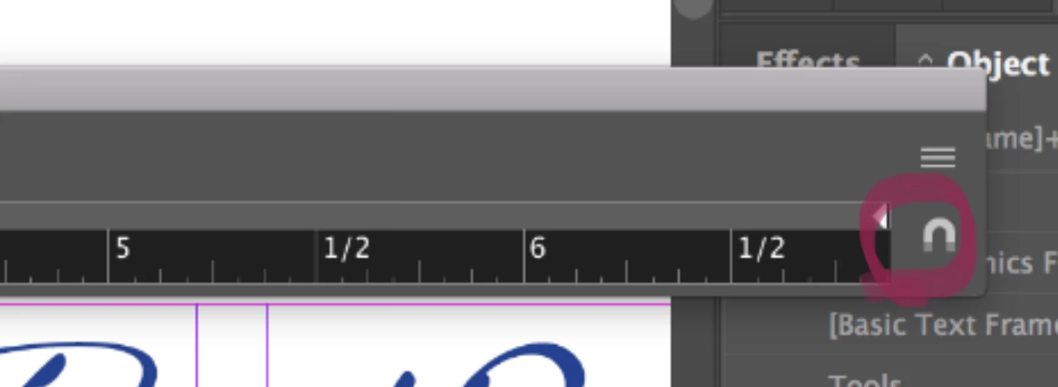

jane-e
July 1, 2019
Hi
In addition to what Steve said, if you want the tab marker to be at the end of the text frame, one way is to zoom out to see the entire frame, then click the magnet (circled) to re-align the tab ruler.
If you need a dot leader, keep the marked selected and click in the text box for Leader. You can have up to eight characters.
