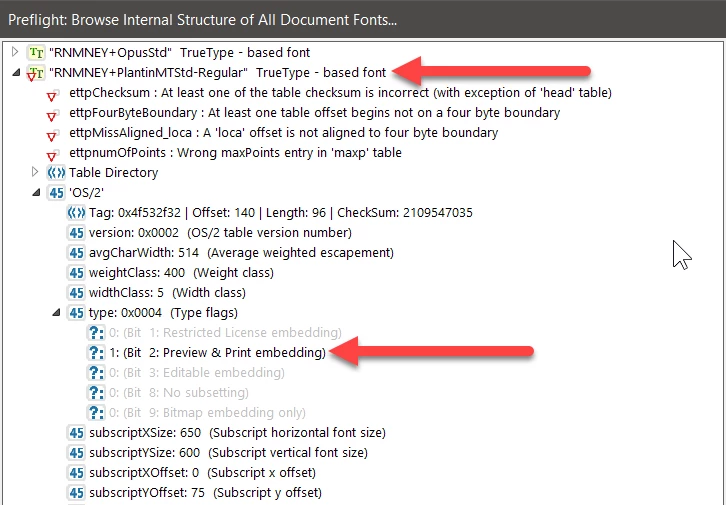

    This is, indeed, a font related issue. The fonts PlantinMTStd-Regular & PlantinMTStd-Italic cannot be used commercially due to font permission restrictions. Some restrictions prevent us from successfully producing a print file, some restrictions prevent the file from printing and some do what happened in this file. In this instance, the restrictions do not prevent file processing or printing but allows the system to re-map, or replace, with an available font. With remapping, the characters may not map, or match, exactly.   This can only be corrected in the submitted file. The fonts will need to be replaced or the publisher must acquire a commercially viable version of the fonts.  We apologize for any inconvenience that this may cause and hopes this information helps in the publication process.

    Our analysis was done on the two pages of the PDF file that you provided to us. If you provide me with the entire PDF file, we can ascertain what is going on. For the two pages you provided, there was no PlantinMTStd-Italic font used.
    For the PlantinMTStd-Regular font that was embedded in the PDF file, analysis of the embedded font showed that it certainly has privileges for Preview and Print per below. Preview and Print embedding privileges are exactly what you need for embedding fonts in a PDF file for viewing and printing.
    Maybe in the other pages of this file there are other font subsets that are problematic? That why we ask you to let us look at the entire file and on that basis, we may need to have a serious discussion with these “technicians.”

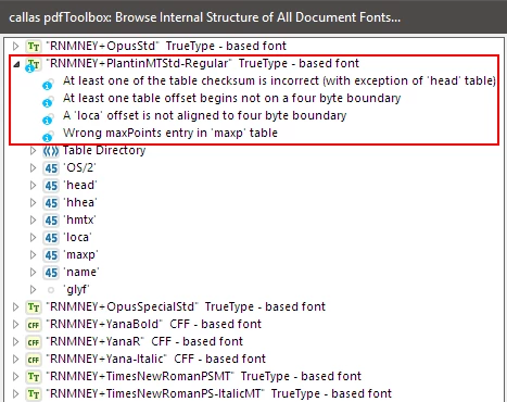

    Looks like an encoding issue to me...Here's what pdfToolbox says about the actual embedding.
    I can open that PDF, refry it and the errors don't occur. If the music and stanzas were produced in Sibelius, I would likely just convert the fonts to curves and be done with it. You will not be able to do much better at another POD. It is possible BookBaby is using better equipment/workflow, but it's been a while since I used them. They do cost more. But, like I mentioned, I would just take those Sibelius PDFs and convert to curves and make the single black plate if that's what they want.
    Dov Isaacs
    January 2, 2018
    None of those informational notes from pdfToolbox (also available within Acrobat Preflight) should ever cause the type of problems noted, especially when they refer to the problem being a font that isn't even reference.

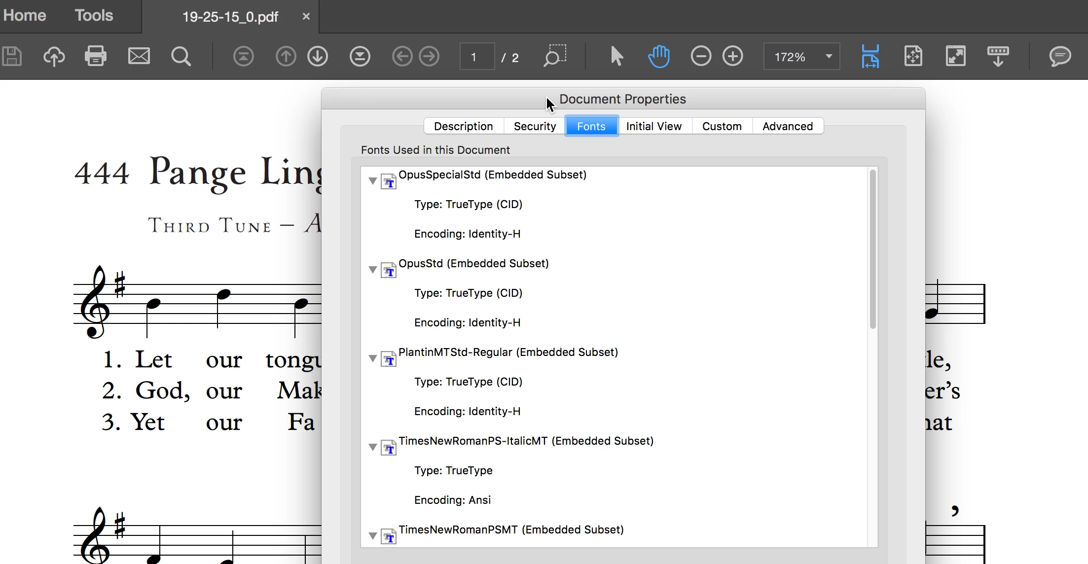

    Steve Werner
    January 2, 2018
    You definitely have embedded the PlantinMTStd-Regular as shown as an Embedded Subset in this screen capture of the Font Properties in Acrobat:
    PlantinMTStd-Italic is not listed as a used font in that particular file.
