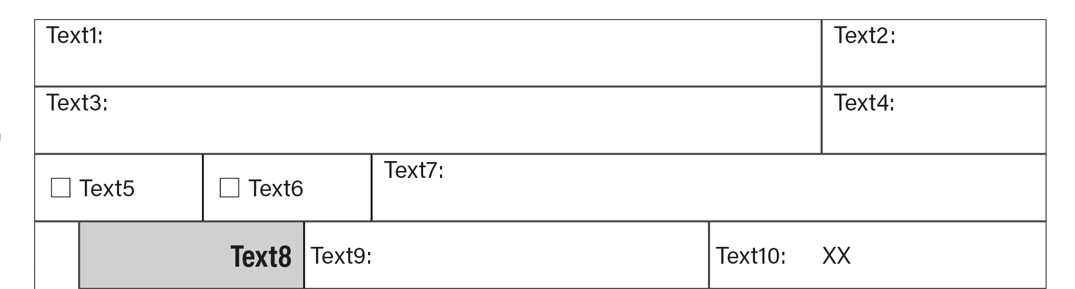

Hi @default9r4wwlq692cy:
Welcome to the Community forums. I like the idea of using a table, as previously suggested. Perhaps something like this?
You can learn more about how to use tables in InDesign here: https://helpx.adobe.com/indesign/using/creating-tables.html. Note the additional links in the left column.

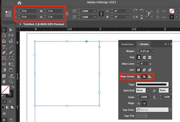

tonks_the_auror
Mar 2, 2025 8:07 PM UTC
There is a quick solution to this problem, which is to make sure the edges of the boxes overlap.
You need to move the second box 0.25 pt to the left so the strokes are on top of each other.
Create a text box 1 inch wide with the left edge at  x=0
Add the .25-point stroke and set it to inside so the box is exactly 1 inch wide
Duplicate this text box and move it to the right of first box so the second box starts at x=1 in
Now with the second text box selected, subtract the width of the stroke from x-coordinate of the LEFT edge of the box
(1 in – 0p0.25)
This moves the second box 0.025 points to the left so the two strokes are on top of each other. I hope that makes sense.

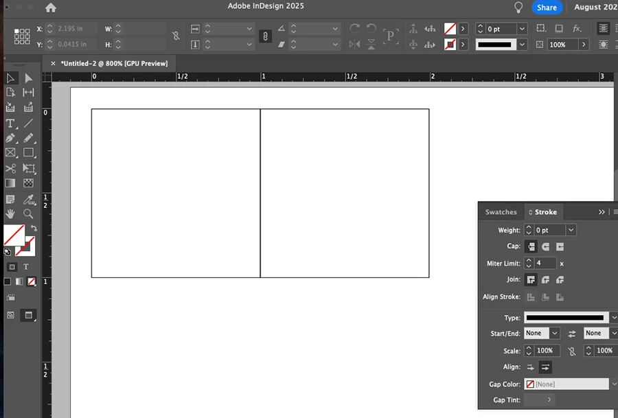

Willi Adelberger
Feb 27, 2025 3:00 PM UTC
  1. Work with an object style
  2. set the stroke to 0 in the style.
    Draw the text frames edge to edge with no distance.
    At the end set the width of the stroke in the style to the wanted size and middle to the stroke.

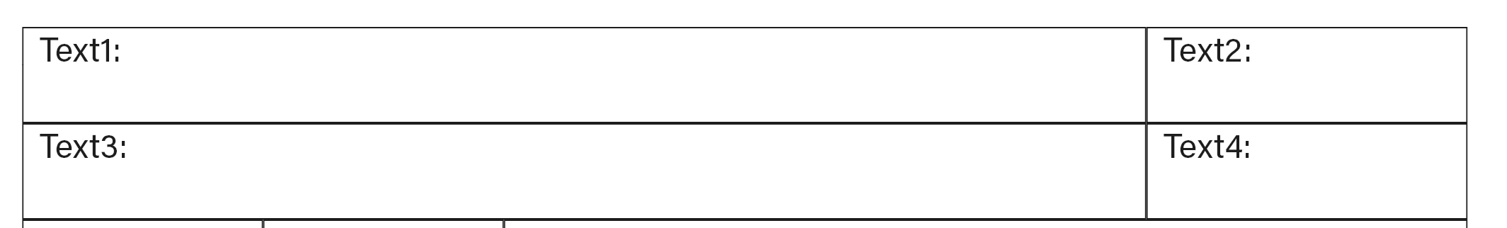

Feb 27, 2025 3:02 PM UTC
I have never worked with tables in ID before.
Is it possible to create a design like this?
