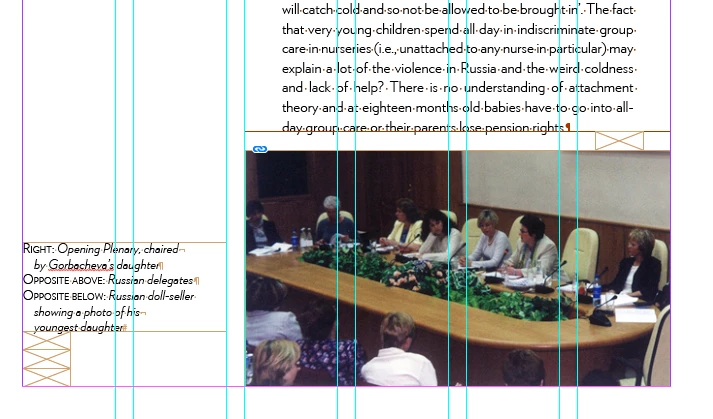

The problem recurs without reopening the file, as I've just discovered, having fixed all the text boxes. When I tried to export it I got an error message with overset text on 11 pages, all captions, and all of which I'd already fixed. I'll attach a screen shot of the last caption I fixed. Not all of them do this, and there is nothing in the text box to explain it. There's also nothing nearby and no text wrap applied as far as I can tell. I'm editing this file, so I don't have the fonts on my computer, but I hope the sample is still useful.

October 13, 2022
Your example show many wrong and useless set ups in your document. I don't know if this is causing the problem, but correct work would hep to create clean files.
  1. One screen shoot shows empty frames with an X in uit. Why? Dekete all those useless frames. Use text warp as part of the object style of the image.
  2. All text has manual overrides. Avoid overrides, work with correct paragraph styles.
  3. Many Word importet styles are in the document. Delete them and use the correct style.
  4. Only basic text frames are used. Create correct object styles.
  5. Your Layer Panels show levels of the text. That indicates that you put Headlines in different layers than the text. This is wrong as headlines have to be part of the text thread. Otherwise you will get problems with automatic tocs and even with normal text flows.
  6. Your swatch panel is filled up with imported Word RGB Color swatches. Clean it up, otherwise it will be a trapp to use wrong colors.
  7. You use fake small caps, try to find a correct font.
