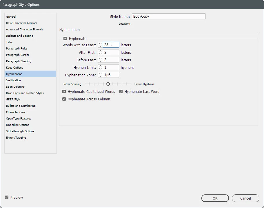

This is more working around the problem than sleuthing it, but it's worth a shot.
If turning off hyphenation is an issue, perhaps allowing it under difficult conditions will get your job done.
  • Open your offending paragraph style options.
  • Navigate your way to the Hyphenation option.
  • The first edit box is Words with at least: ___ letters. The default setting is 5 — change it to 25. That tells InDesign that it's only OK to hyphenate a word if it's 25 characters or longer.. Not too many words are. So you're allowing hyphenation, but only under next to impossible conditions.
Hopefully the type will show now. I've never heard of the condition you describe, but you know it's real because you're experiencing it. Maybe if we can break the rules, we can fix it.
Hope this helps,
Randy
Apr 11, 2025 1:18 PM UTC
This worked, thank you so much Randy!
