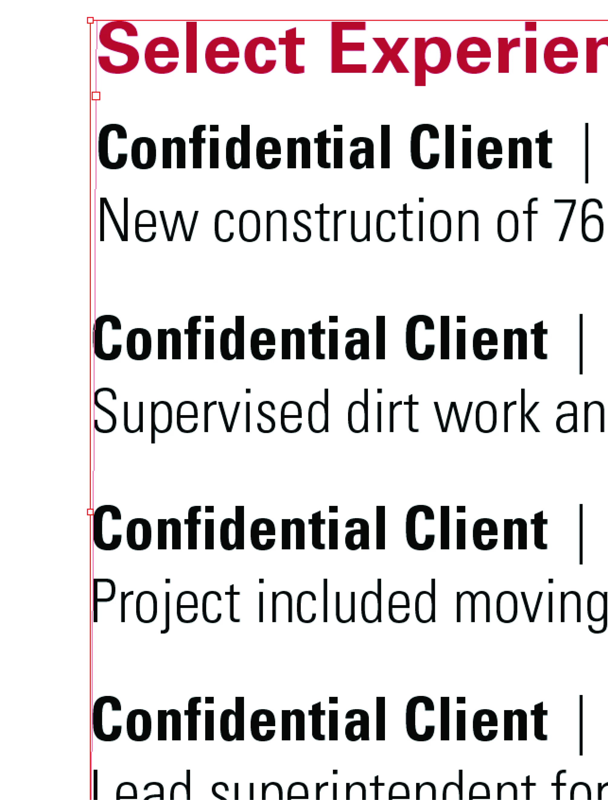

Hello, users. I have been noticing for a few months that a specific text frame within a template file will randomly begin skewing slightly right out of the lower LH corner. Has anyone seen this?
I can’t explain how it’s happening. Any tips or advice on fixing/mitigating? If I copy the text out of the frame and put it into a new one, the issue doesn’t duplicate so it’s something happening with the specific frame in the template. Running ID 19.2 x64
Thanks in advance.

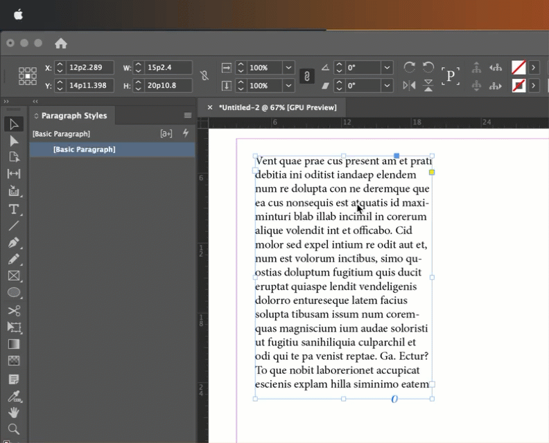

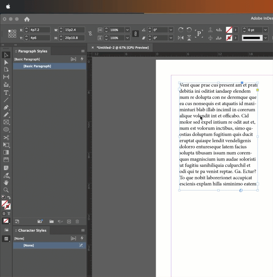

In my experience, text frames don't skew themselves. As a matter fact, it's a bit of work and you would know you are doing it. It seems most likely to be a user error, and we need to rule that out: does the first part of the demo ring a bell? Have you ever selected the top left corner with the direct selection tool, and moved it?
To restore the rectangular shape, just choose Object > Shape > Rectangle.

Hi Barb, simply restoring to shape fixed the issue. The best I can tell is that it has to be an erroneous direct selection of that top LH corner to skew it ever-so-slightly.
What's interesting is that I know for certain that the frame within the template file was not skewed when I last updated it because other files I've generated with it since then didn't have the same issue. After my colleague showed me the problem in a file he generated earlier today, however, the skew was happening within the same frame on both template pages that use this style.
Might just be time to rebuild these pages within the template and monitor to see if the issue arises again.
