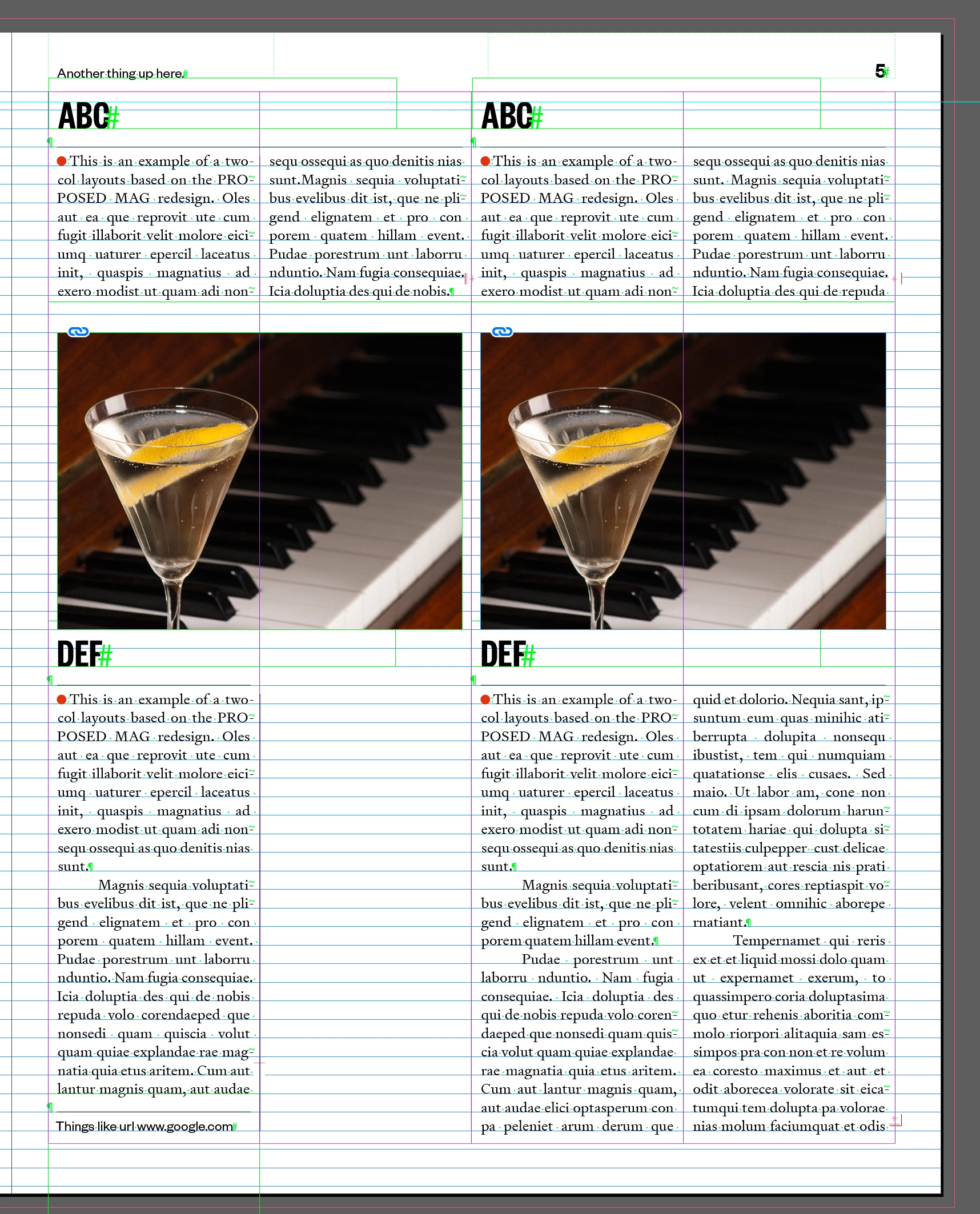

Text frame with a left or right side border only...
Heres an example layout I have been testing in order to get to grips with layout rules...
Orange lines = manually placed, happy to keep dong these as-is.
Green line — this is manually placed but this really seems like a dumb solution, I woudl love some advice as to the most flexible / solid layout solution to add rules to either the left or right side of a text box!
I could do this with custom paragraph styles, using a right-side para border, but it would be MUCH easier and flexible if there was a way to control text frame borders!! Then we coudl just use object styles...
Has anyone come across a solution (maybe even a plugin?) that can give us fine-grained control over borders?
thanks for your time!

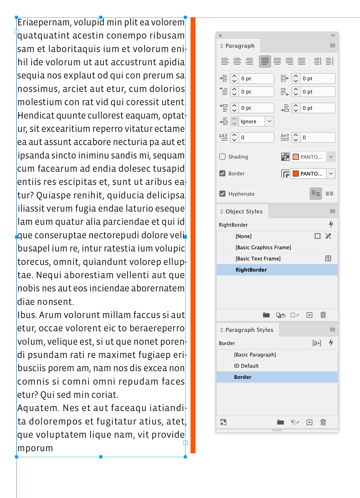

rob day
Aug 25, 2022 6:41 PM UTC
Hi @Matthew A , Seems like you should be able to set up an Object Style that includes a right only Paragraph Border:
Matthew A
Matthew AAuthor
Aug 25, 2022 7:09 PM UTC
Hi Rob — sure, that is what I am doing at the moment... but... imagine we have two or three useful para styles for a given text box in a 3-col layout... lets say body text, intro paragraph and a quote style...
Depending on what we do with the layout we would then potentially need a left + right + both-sides para style for each 'main' paragraph style version. So nine different paragraph styles needed where usually Id only have three!
And this isnt even a particularly detailed layout, you can see how we'd end up multiplying paragraph styles very rapidly here... which I am fully expecting to do!
It would be SO much simpler if we could simply assign borders per edge instead of the rather basic Indesign tools we currentyl have. Or if we could perhaps assign border on the object-level...?

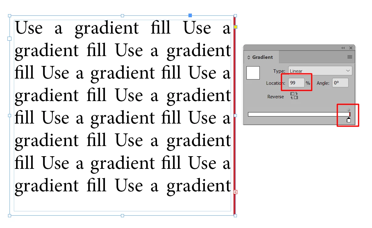

TᴀW
Aug 25, 2022 3:48 PM UTC
If you need a line on one side only, you could use a gradient fill with both tab stops set at 99%:
(Actually, this would also work if you needed 2 lines, one on the left and one on the right, or one on the top and one on the bottom, but not if you need 3 lines or 2 perpendicular lines. And 4 lines is, of course, built in.)

Matthew A
Matthew AAuthor
Aug 25, 2022 3:57 PM UTC
Interesting tactic!
But that would not allow me to set the line to text ascender / baselines... So far paragraph borders seem to be the most flexible option and accurate, although I havent yet looked at tables...

Aug 25, 2022 2:50 PM UTC
"Orange lines = manually placed, happy to keep dong these as-is."
Hi @Matthew A ,
keep them manually placed. Also the orange ones.
Well. Perhaps show the page with frame edges visible and invisible text showing as well.

Aug 25, 2022 3:24 PM UTC
Here goes...
