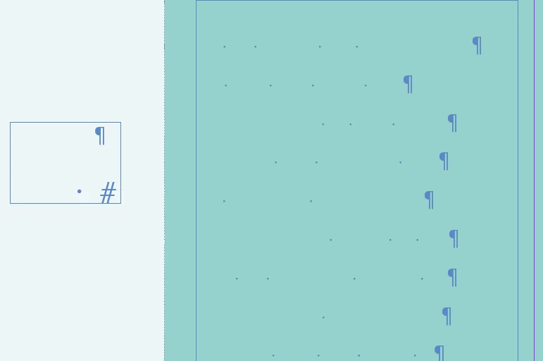

It happened very sudden with some of Indesign files.
The text is completely gone, but the styles and hidden characters are visible. The text is here but I can't see it. I can see image and outlined text however.
It's not text wrap, I've trashed my perfomances and I've tried older version. Didn't work. Another strange thing is; if I try to paste text to the document with the text visibility issues the text also disappear.
It's not paragraph styles either, it was worked perfectly fine before. Another detail: the file is on a server, but if I download it on my pc the problem won't disappear unfortunately.

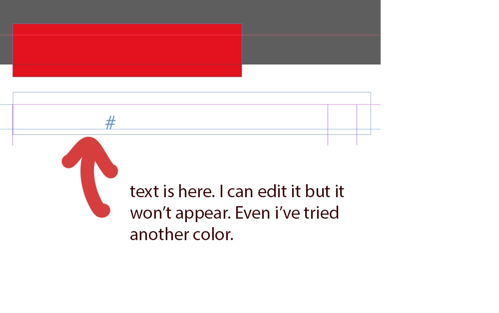

If it isn't text wrap, could it be that the text color has been redefined? Not likely, I know, but it helps to rule out obvious problems.
Mike Witherell
tessa_louAuthor
September 7, 2020
Thanks for your reply. Unfortunately that's not it. The image below has two different background color and the text color isnt changed (opacity and tint is 100%)
It's a bit frustrating because the more files I open in indesign, the more this is happening.
