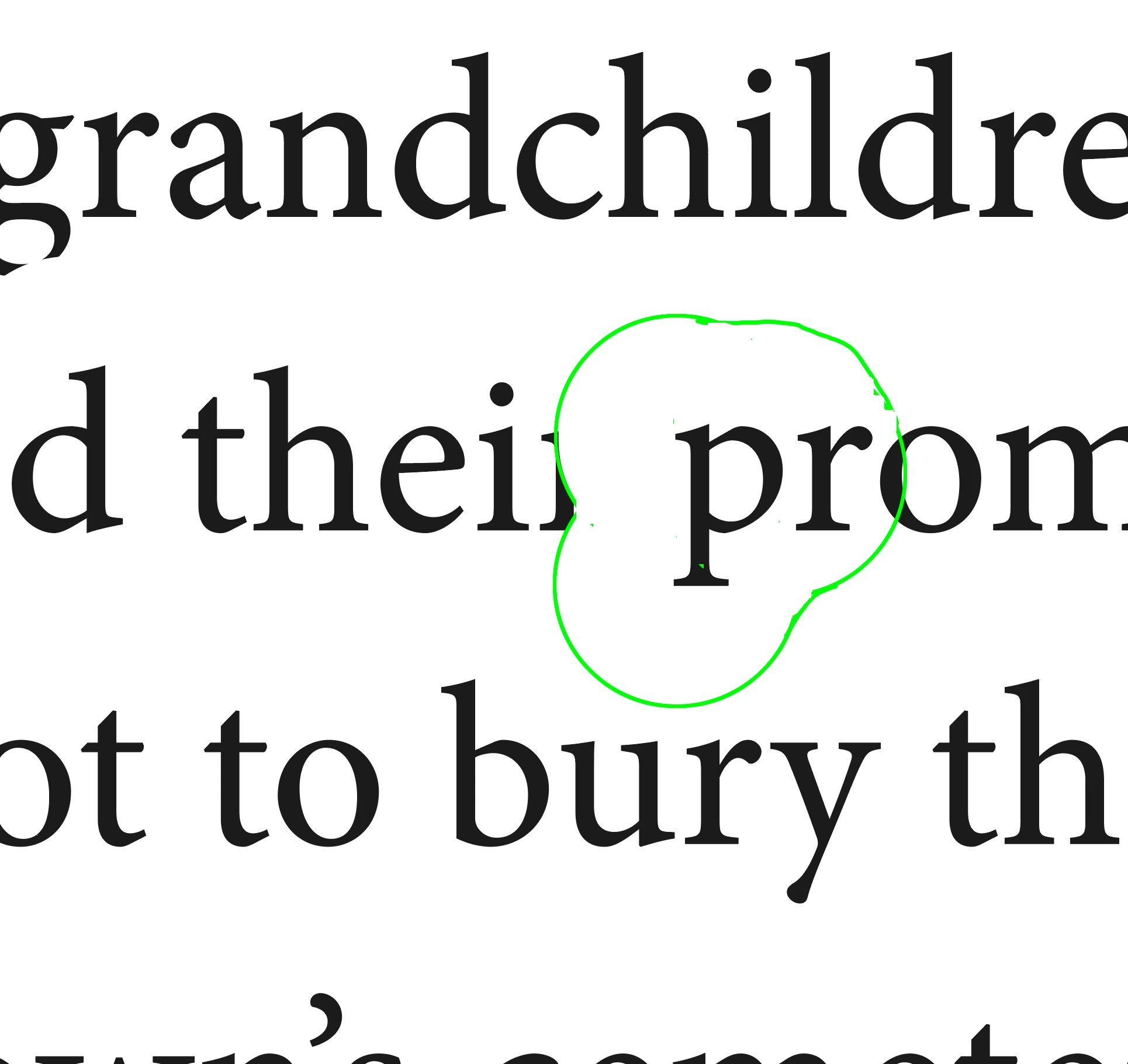

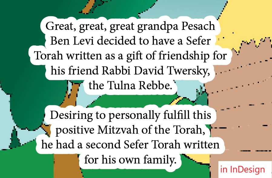

Hey, I've encountered this issue when I have a text with a stroke around it, in InDesign it looks completely fine, but once I export it it results with weird squigly lines, and empty space dots in random places of the text where the stroke should cover. See two pictures below.
I have tried exporting it using sRBG, and Acrobat 4 format, nithing seems to work.
Any thoughts?
Much appreaciated!

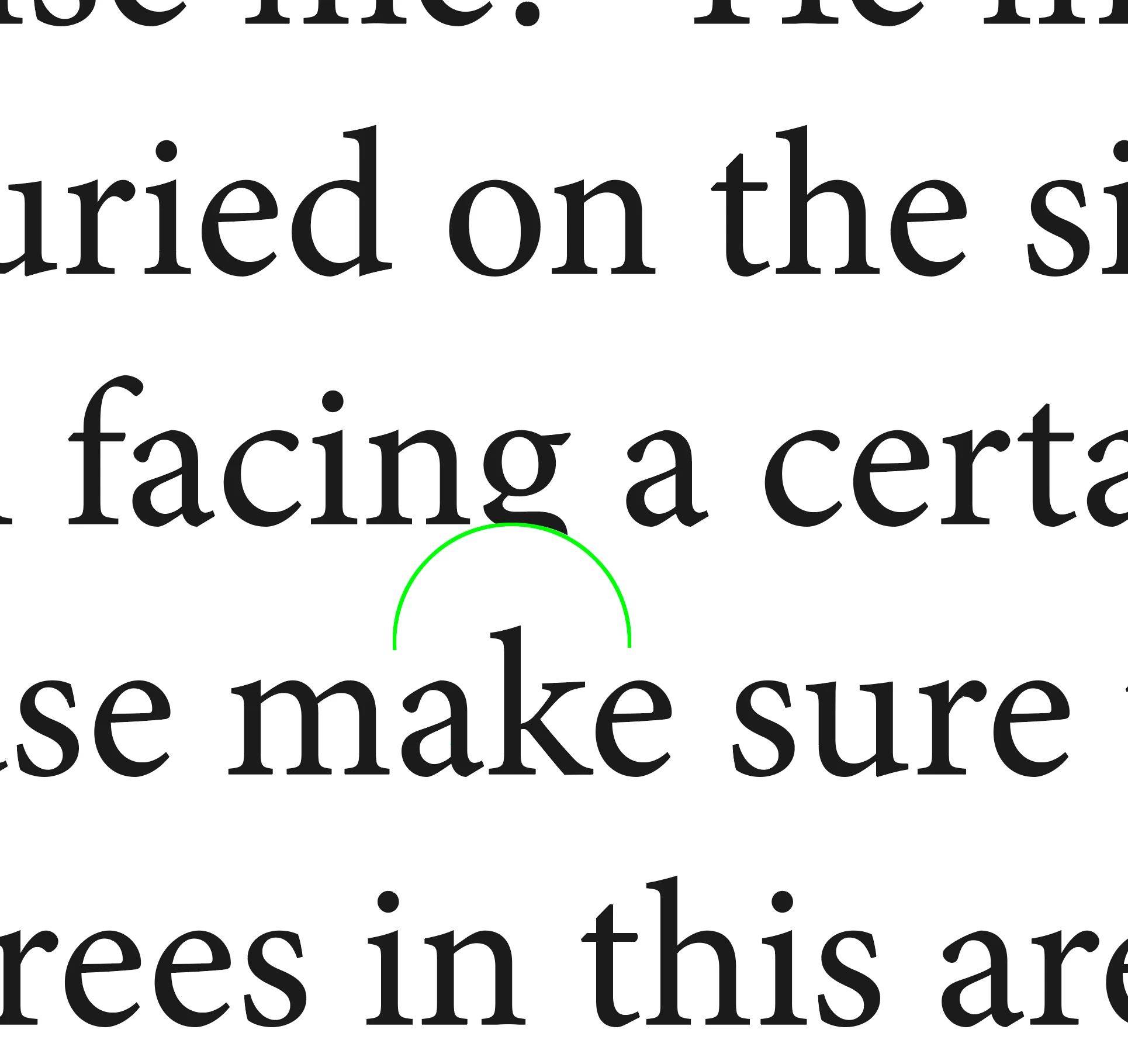

Your stroke is too large, so it has started to overlap the type below.
When type is rendered it starts with the first character of the first line, just like as if you were typing it., so when it gets to the following line, the white stroke is covering up parts of the previous line. e.g. the line with the word "make" is covering up the line above it:
Adding to your problem, in a PDF, to maintain positioning, some lines of type will be broken up into separate objects, so the same thing can happen within the same line, like so, where there is now a break before "promise":
