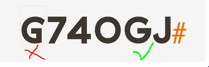

Hello everyone,
I have several questions about text variables in indesign. I have a 100-page document with about thirty text variables placed all over the place.
Is there a way of highlighting them to make it easier to find them (a bit like the highlighter for style replacements)? The frame around the variables is very discreet, I can't see it very well.
Second question. Is it possible to see the variables that are not used in my current document?
Last question. Is there a way of choosing a specific glyph for a letter? I use the GT Haptik font, which has two letter Gs, but unfortunately the default G that appears in my text variables is the one I don't like. And I haven't found a way of making the second one appear, whereas in normal text I have no trouble changing the glyph.
In advance, thank you all for your help.
Claire.

Dernière question. Y a t il une manière de choisir un glyphe spécifique pour une lettre? J'utilise la police GT Haptik qui propose deux lettre G, malheureusement le G par defaut qui apparait dans mes variable de texte est celui que je n'aime pas. Et je n'ai pas trouvé comment faire apparaitre le second, alors que dans du texte normal je n'ai pas de soucis pour changer le glyphe.
D'avance, merci à tous pour votre aide.
Claire.
Eric Dumas
Jan 14, 2025 5:46 PM UTC
Can you explain what you are trying to achieve with the variables? I would consider a GREP rule attached to the style that controls the formatting of the variable.
