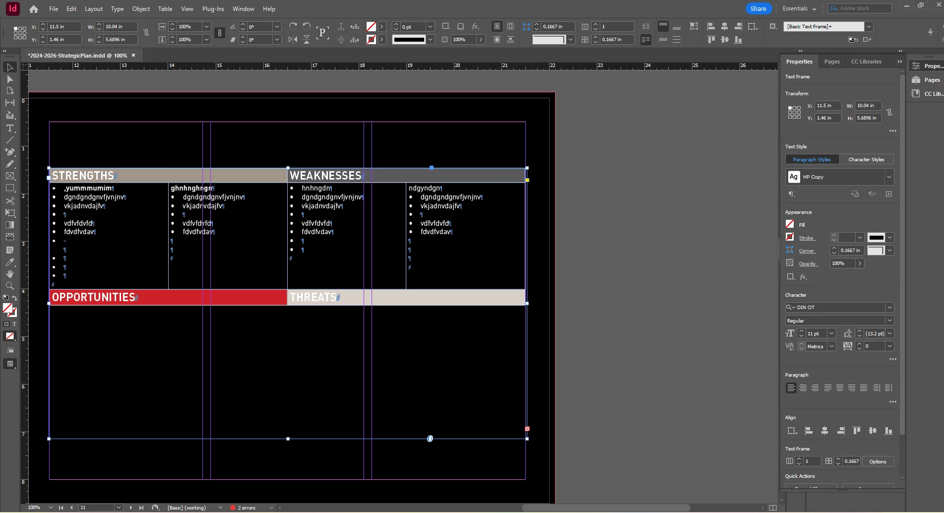

I have created a table within Indesign, and the frame has ample space to fit the text. However, when i go to centre my table on the page, the bottom portion of the table disappears and displays as overset. When i slightly move the table it comes back, but the minute i try to re-centre, the issue comes back. I have tried setting all the text as body copy - no luck. In addition, when I place the table on different pages - it works no problem. Even if i reset the page, delete and re-create, issue persists. Any ideas?

Barb Binder
January 10, 2024
Hi @HPROLP :
Sorry, I had to step away for a bit. Great screen shots—thank you!
Here is the bottom of the second screen shot:
The red + in the box labeled 1 indicates the text is overset. What happens if you double click the bottom middle handle with the Selection tool in the box labled 2? Does the rest of the table reappear?
~Barb

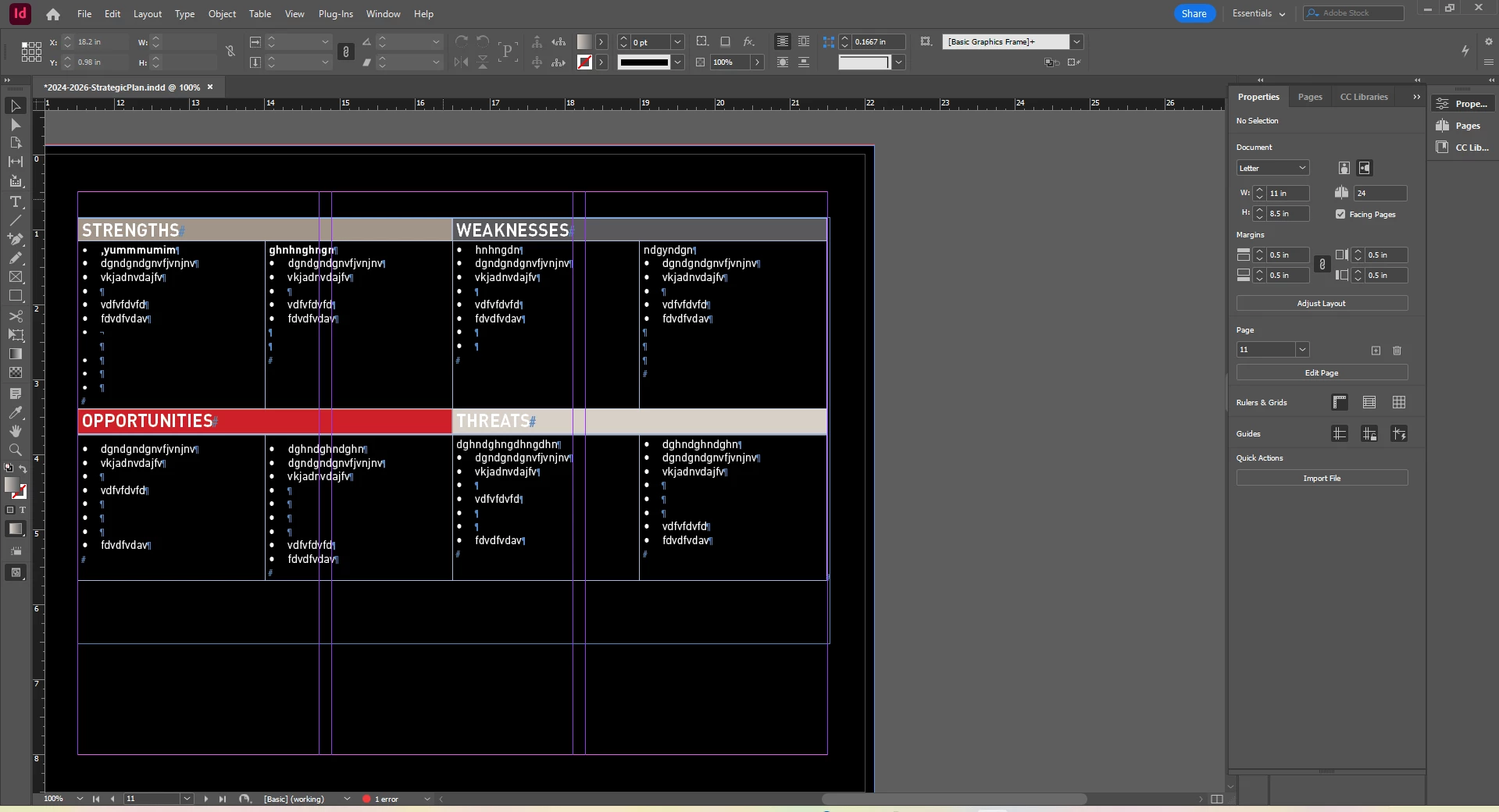

Can you please share two screenshots of your page: one before, and one after. Before you take the screenshots and post them here using the Insert Photos button on the toolbar above your reply, please show hidden characters from the bottom of the Type menu and show frame edges (View > Extras > Show Frame Edges). And please include the entire page in each screen shot. This gives us our best chance of figuring it out.
~Barb
HPROLPAuthor
January 9, 2024
Hi Barb, see screen shots! The keep options didnt seem to make a change
