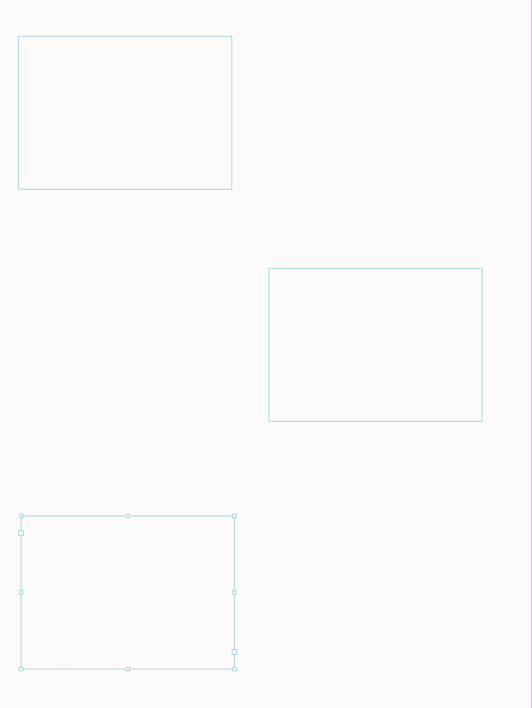

Hi @Bedazzled532 , to illustrate @Peter Kahrel ’s post, I added these 3 text frames to the page from top to bottom, so the bottom frame is myFrames[0] and the top frame is myFrames[1]:
The script below does this:
var myDoc = app.documents[0];
//the myFrames array. Newly added frames get added to the beginning of the array.
//myFrames[0] is the most recent frame added to the document
var myFrames = myDoc.textFrames.everyItem().getElements();
for(i=1;i<myFrames.length;i++){
    myFrames[i].nextTextFrame = myFrames[i-1]
