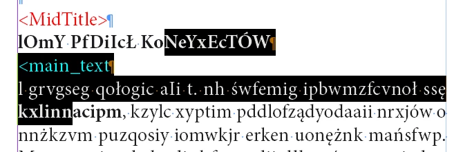

Lets say we have some text:
and there are some different formattings - doesn't matter if local or CharStyles.
Now, lets iterate through TextStyleRanges collection of the SELECTED text.

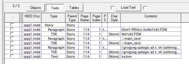

Above example have 4x TSRs:
2nd and 3rd TSRs can be correctly referenced & compared (I'm checking indexes of 1st and last characters) but for simplification:
myText = myText.TextStyleRanges.Item(1).Texts.Item(1)
BUT - returned parent TSR for the 1st text - "NeYxEcTÓW"- even when I've not selected whole TSR - is the same as myText - in this case, parent TSR should be the same as the whole paragraph - "lOmY PfDiIcŁ KoNeYxEcTÓW" - so in the screen above it should be "Text" instead of "TSR" in the TYPE column.
parent of the 4th TSR is returned correctly as "kxlinnacipm" and I have "Text" in the TYPE column.
Can someone verify if you have the same problem - that parent TSR is returned correctly when you select "start" of the TSR - but incorrectly when you select "end" of the TSR.
Parent Paragraph - myText.Paragraphs.Item(1).Texts.Item(1) - doesn't have this problem.

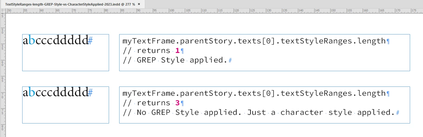

it's a bit off topic perhaps, but while we are at textStyleRanges now consider the following:
Test document attached:
TextStyleRanges-length-GREP-Style-vs-CharacterStyleApplied-2023.indd
Uwe Laubender
( Adobe Community Expert )
Robert at ID-Tasker
February 2, 2023
Because formatting applied through a GREP Style is kind of "virtual" 😞
Pretty sure Drop Caps and Nested Styles behave the same.

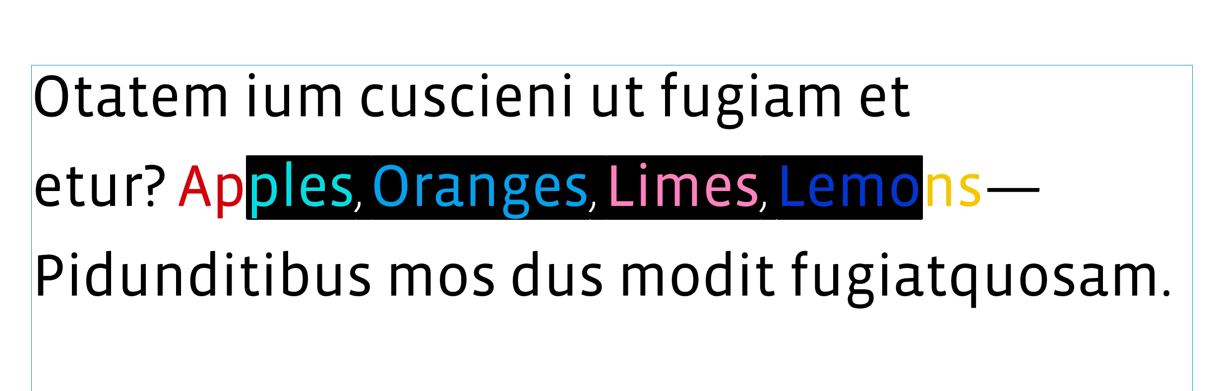

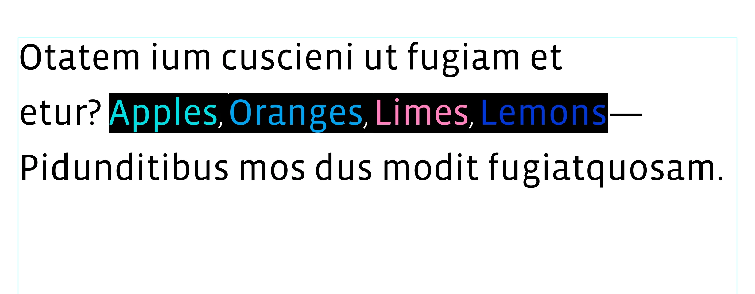

Hi @Robert at ID-Tasker , Did you double check the textStyleRange length to make sure it really is 4? With this example:
I get this with JS:
var s = app.activeDocument.selection[0]
var tr = s.textStyleRanges;
$.writeln(tr.length) //returns 7
$.writeln(tr[0].contents) //returns Apples
$.writeln(tr[1].contents) //returns ,
$.writeln(tr[-1].contents) //returns Lemons
$.writeln(tr[0].parent.contents) //returns Otatem ium cuscieni ut fugiam et etur? Apples, Oranges, Limes, Lemons—Pidunditibus mos dus modit fugiatquosam.

It works fine when you select WHOLE TSR - try to select from "ples" to "lemo".
And Parent for TR[0] is Story - no problem there.
