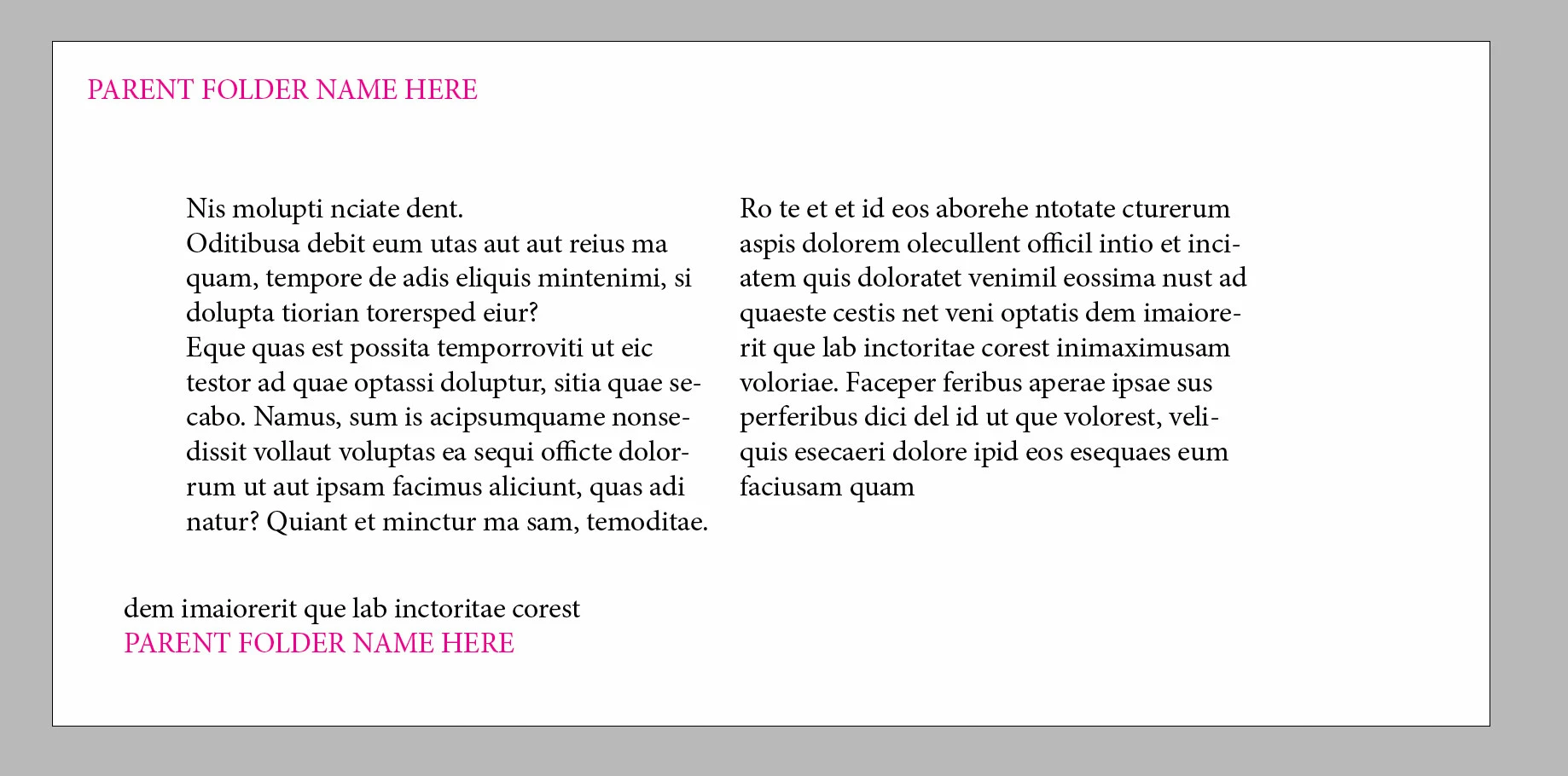

@41291280 another interesting approach could be to run an "afterOpen" event listener that performs the substitution automatically when a document is opened (if the document doesn't contain the target paragraph style, the script does nothing).
For a demonstration, before running the script open the attached "demo.indd" and save it into a folder called "AD1234567" (just an example fake ad number). At first you will see this:
This document has some text set in a particular paragraph style that the script is looking for.
Now run the script. A message appears: "Listener is running." Then close demo.indd and open it again.

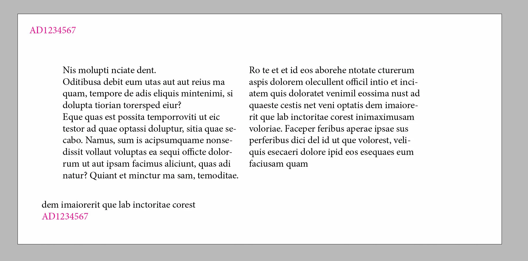

You will see this:
where the text in magenta has been replaced with the parent folder's name. You can have any number of texts to replace.
I hope that is useful. The script listing is below.

Dec 12, 2025 9:26 PM UTC
If you have a script that inserts the advertisement number in a document, you can use a batch processor to run that script against folderfuls of documents. Two such scripts are
https://kasyan.ho.ua/indesign/batch_process_scripts/batch_process_scripts.html
https://creativepro.com/files/kahrel/indesign/batch_convert.html
Dec 16, 2025 11:08 AM UTC
Danke für den Input. Leider ist mein technisches Verständnis und Englisch nicht gut genug um das auszuführen.
