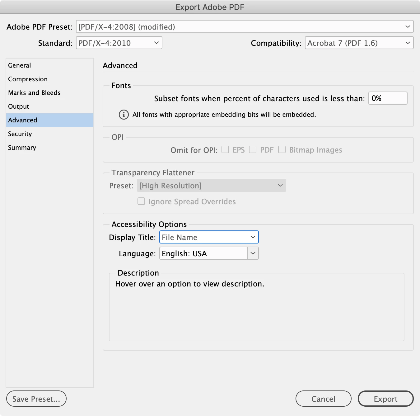

Hi @Eric32849509fs0j , Does it happen if you set Export>Advanced>Fonts>Subset fonts... to 0%?
March 13, 2024
Thanks Rob for your quick reponse and advise.
Unfortunately, it still gives me the same result. I have attached the InDesign test file for reference.
I am currently using the font Tahoma, but even if I change it to Adobe Thai sill have the same issue 😞
