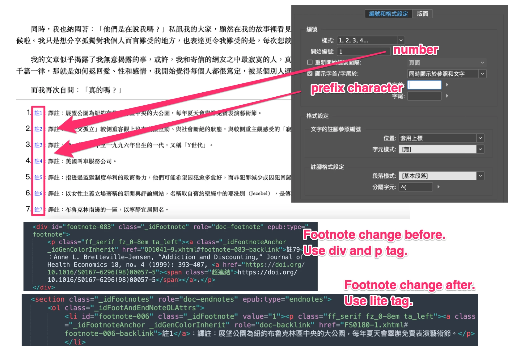

The EPUB footnotes have been changed in a strange way
After the recent update to InDesign 19.4, I noticed some changes made to how InDesign handles footnotes for EPUBs. Previously, it used a <div> with <p> for footnotes, which worked fine. However, they've now switched to using a <list>, which is causing issues.
This change completely overlooked that InDesign footnotes also have numbering and preceding characters. As a result, the output is quite ridiculous. Of course, I can fix this by changing the list-style to none in the _idFootAndEndNoteOLAttrs style, but the update mentioned, "Version 19.4 provides fixes for important functional, stability, and performance issues," yet the EPUB part seems to be a mess... I don't know what to say.
I'm using the Traditional Chinese environment, and I'm not sure if other language versions of InDesign 19.4 have similar issues.

quick fix would be to add this to your generated css file:
li._idFootnote {
list-style-type:none;

As for me - I do not want my footnotes to be a list, so I change all the <li> back to <div>. Also the role=doc-backlink code is tagged as an error in my validator, so I have to delete it everywhere.  It is a nuisance.  I would really appreciate if Adobe could bring back the old conversion method it gave me better Epubs with fewer issues to repair in the coding.

Testing Summary 3 Mar 2024 — ID v19.4, Win11
Okay, I've run several tests on footnotes and endnotes under v19.4, and the short version is that while the internal structure has been changed (from <p> elements to <ol>/<li> elements)... it all works exactly as it should under all conditions I can check—
  • I can set any footnote/endnote numbering options, and they pass through to the exported EPUB. This includes numbering type, starting number, location etc.
  • I see no duplicate numbering in either note list.
  • EPUBcheck passes the result without a single warning.
  • Ace passes the result with no relevant warnings (a few correctable ones related to the TOC).
Since this new system all turns on an ordered (numbered) list that then has the numbering suppressed (an approach which I cannot decide is a hack, a straightforward use of cascading style control or a brilliant workaround), and it was noted that adding the number-suppression statement fixed things for at least one user, I have to conclude—
  • There may be some faulty versions of 19.4 that did not include the number-suppression statement; the solution is to look at the exported CSS file for that _idFootAndEndNoteOLAttrs { list-style: none; } statement.
  • If that statement is present, check that it is applied to the <ol> list structures for footnotes and endnotes;
  • If the duplicate numbers are being seen in any one EPUB reader, check the file in a standard/vanilla one such as Calibre, Thorium or Kindle Previewer.
Other than that, any fault may be in original source material and setup. The file I tested was created for other purposes before v19.4, but when I made some of the testing changes I had a sense that something global might have changed. If the source files in question are long-existing, it may be worth resetting or re-formatting both foot and end notes to force some internal structural update that results in a more compliant export.
So, TL;DR... there does not seem to be a problem here. If anyone is still seeing faults in the footnote/endnote export process, or in their accessability, feel free to continue the discussion but with as many details of the versions, doc, faults, validation and accessibility checks, readers used, etc. It won't help to just say "I'm still seeing the problem." 🙂

Out of the box, InDesign 19.4 is not suitable for epub footnotes and does unexpected things. It looks like it works for epub3, but only if you use the "popup" placement. You get an 'aside' paragraph. Well, maybe that's fine...
But when you export it as normal footnotes, InDesign treats it as 'ol and li' text. And put an extra number in front of it and give a 'value' to the list - which no one wants, because you're choose our own values (fixed figures) in the InDesign footnote settings. That value is the link from note to note anchor - so it is he only number that counts.
When exporting to epub2 the same things happen.
Did they ever test this before launching?
The solution is, I think: to put a line in the CSS with:
ol {list-style-type: none} or more specifically an 'ol' only in the section 'notes'.
Hopefully, e-readers will recognize these CSS declarations.
Am I right? Or are there more settings we can use?
