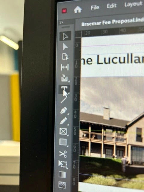

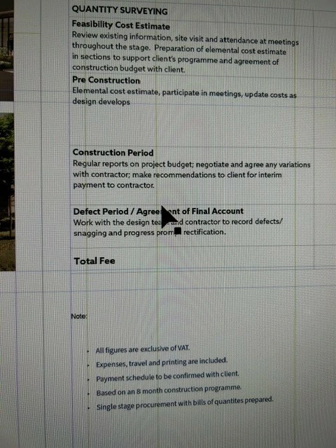

The icon is huge in InDesign STILL
I have looked at the issues but the posts are 11 years old . I have tried to sort and it’s still happening. ANY ideas welcome.
It’s something within resolution, double screen I THINK but i have tried multiple options.
Any ideas?

    leo.r
    Jul 29, 2026 9:02 AM UTC
    Can you please post a screenshot that would help understand what kind of problem you’re referring to? Also, what are your InDesign and operating system versions?
    Ros38228568dovj
    Jul 29, 2026 9:14 AM UTC
    I am on windows . InDesign 2026
    Abhishek Rao
    Jul 29, 2026 11:15 AM UTC
    Hi @Ros38228568dovj,
    Thanks for sharing the screenshots. Sorry you're running into this issue.
    Could you first try adjusting the InDesign User Interface Scaling settings and check if that helps? You can find the steps here:
    https://adobe.ly/4vVT7lk
    If the issue still persists, it may be related to your monitor resolution or the Windows display scaling, especially if you're using a dual-monitor setup. In that case, please check the Display Scale settings for both your primary and secondary monitors by going to Windows Settings > System > Display. As a test, try setting the Scale to 100% or 125% and see if the icon size returns to normal. You can also refer to this discussion for additional context:
    https://adobe.ly/4pHPjCB
    Please let us know how it goes, and we'll be happy to continue investigating if the issue persists.
