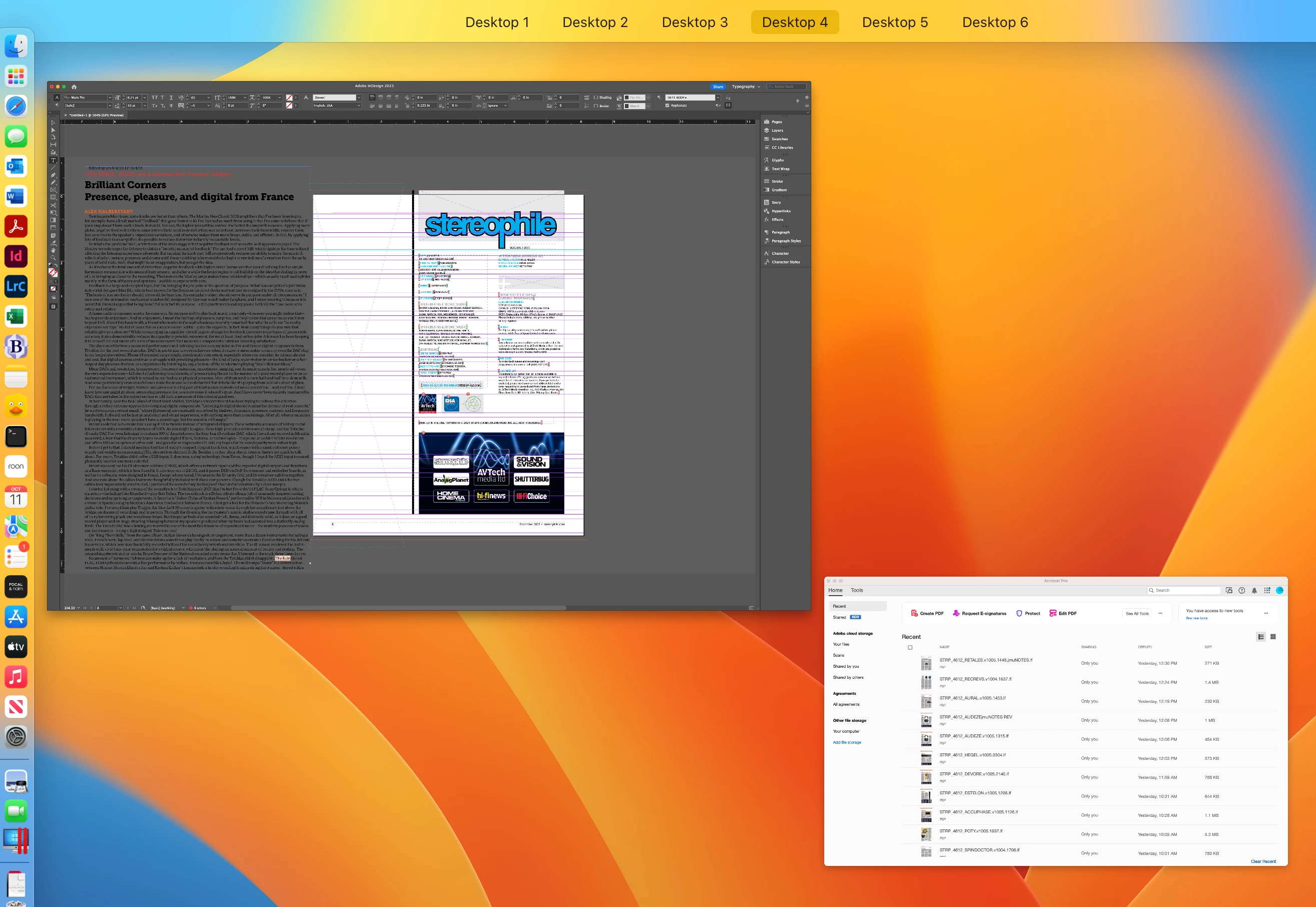

Jan 3, 2024 11:21 PM UTC
unfortunately, that only releases the window inside the application frame. (image 1) The top of the frame is still not accessible. You have to hide the Mac menu bar, then you can move the frame. Image 2. This has been an issue for a very long time.
