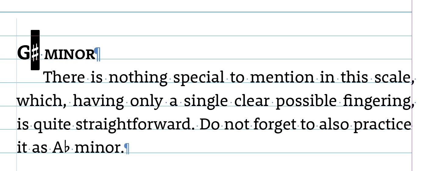

Some issues I ran into were that the musical symbols in titles had some spacing options that prevented them from being in the top line (see screenshot attached). I solved that by editing, in the parent page, the baseline options for the text frame from Ascent (default) to Baseline. This had the side-effect of causing a few other headings not liking the first line. I then locally changed only those text frames to have Ascent.

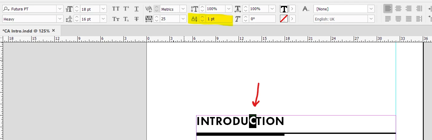

In your screenshot, you marked that you had to do a lot of fiddling to get the # sign to align with the baseline. There's a nifty tool in the top bar that lets you shift the position of text up or down point by point (see below). Notice that the capital C is a point higher than the rest of the letters. This might be easier for you.
Oh, I have fiddled with baseline shift more than one ever should but nothing, it would not bulge. Perhaps the font used to render the musical symbols is not too prone to collaborating but, in any case, the only thing that worked reliably was editing the Text Frame Options so that the Baseline type would be either of Ascent, Baseline, or x-height. Sometimes one would work, sometimes the other would work. Not knowledgeable enough to know or understand why at this point. I've not yet had enough Nigel French in my InDesign life 🙂

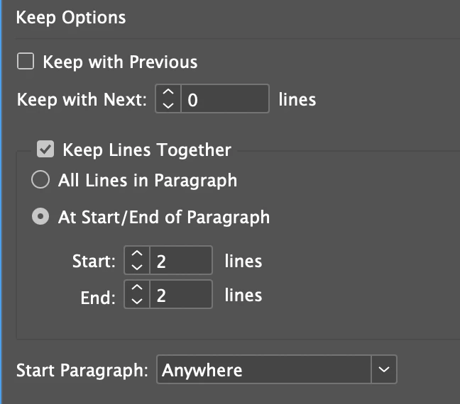

The first thing I noticed is that the chosen baseline does not divide perfectly into the text frame, resulting in the last line always being empty. Not a big deal since this is consistent throughout. I would try to make it more precise in a future project, though.
I asked myself several times why the last few lines of several columns would remain empty but the only reason I found as a possible culprit would be my paragraph style's Keep Options, which are like this to avoid orphaned lines:
These settings certainly do what I tasked them to, but have the side effect that you mentioned.
I am not sure how changing the tracking-kerning would help here; perhaps making paragraphs stretch to the end of the column? Or something else?
Going page by page in the new version attached below (using PDF page number):
  • page 3: the first paragraph of the second column could easily have 2 lines in the previous column but, when I uncheck the "keep together" option, only the first line goes back, even if there is a full leading space available. No idea why. I thought that my space above first footnote could be too great but it's not that.
