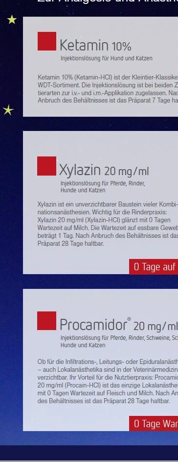

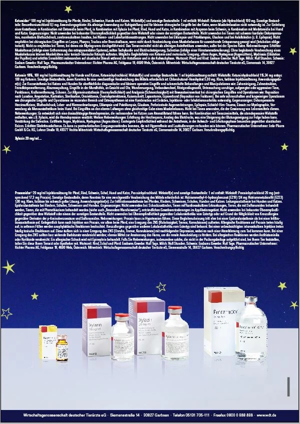

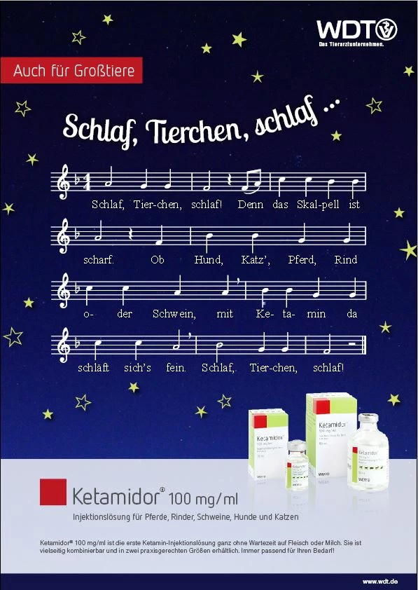

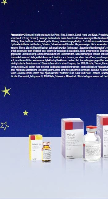

I have an image, a blue sky with some transparent (80%) white rectangles on it. This layout repeats itself on 4 pages. And on all 4 the color display is different. It is the same image, the same profiles, all the same. But it looks different. The first image is very bright and the 2 and 3rd much paler. Now I see that the attached images look almost the same, but in my document the difference is really big. In print looks also different.
I'll be very grateful, when you can help me.
Thanx

    Thank you all for your answers. I changed the color modus to cmyk in photoshop first and back to Indesign, it looked everything much better....

    Some monitors can vary in color from side to side and top to bottom. Try displaying two pages in Acrobat and moving them around your screen.

    Do you get a match if you turn on Overprint Preview?

    I'm not seeing any significant differences in your screen captures. Have you checked the PDF/X-4's output numbers in AcrobatPro's Output Preview panel? Is the background blue gradient positioned and scaled the same on all of the pages?

    Can you provide an X4-pdf (with texts and other elements that are not pertinent to the issue removed) for comparison?
    As the image seems to feature a gradient the visible image sections can make a difference.

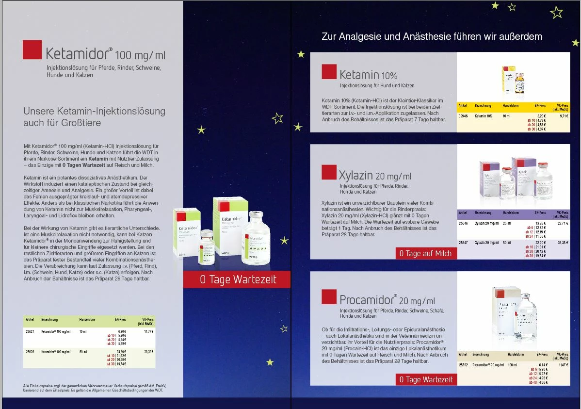

    foteaa31310262
    February 8, 2017
    I'm not sure what you mean by "the visibile image sections", but here are some details from a X4-pdf...it looks the same as in my document.... I still couldn't find any solution...

    I meant an actual pdf, not screenshots.
    Are the transparent elements set against regions of the same hue, brightness etc. of the image?
    The screenshots in the original post seem to show that the pages displayeat least partially different parts of the background image.
