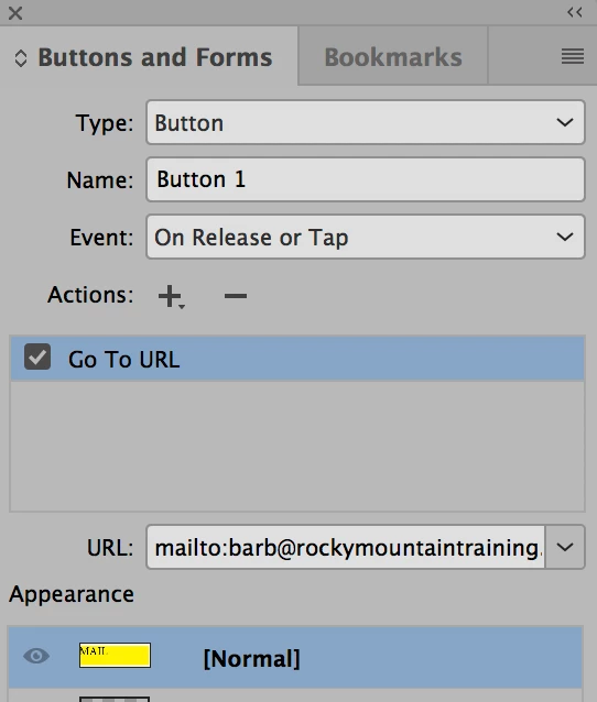

    Check the URL syntax on the InDesign button. Use Go To URL, remove http:// and replace with mailto:name@company.com

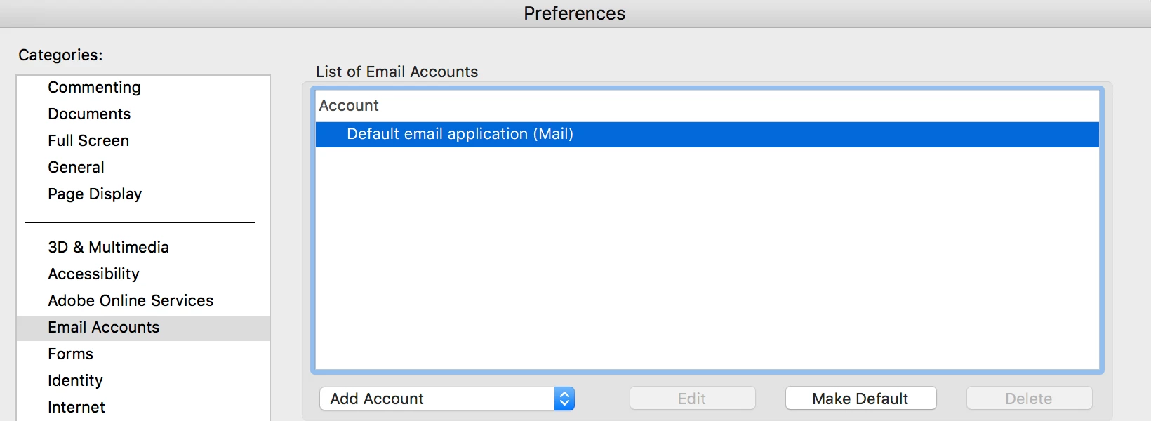

    Have you set up your email account in Reader (and/or Acrobat) Preferences > Email Accounts?

    I tried this under URL and Button, did not work.
    (Check the URL syntax on the InDesign button. Use Go To URL, remove http:// and replace with mailto:name@company.com​)

    What is the URL that you used for the button? How are you testing this form? Anything other than Acrobat or Acrobat Reader will be a crapshoot.
